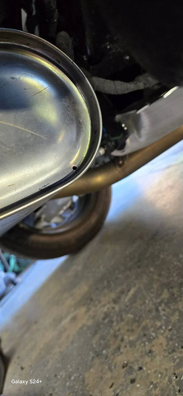

Whilst I was installing my hitch yesterday I noticed a small hole in the exhaust on the passrnger side, it's probably a 3mm circle, it doesn't look rusted or anything, is it supposed to be there for some reason?

Hmmmm, I thought about that too, but if it were I would have thought the hole would be closer the the bottom it's about 3mm from the bottom of that flange or on the bottom (underside) of the exhaust, be interested to find out if anyone else has a hole in theirs.

Yep,
Most commonly referred to as a muffler weep hole.
Cut & paste from another forum/blog:
Ford Bronco Sport Hole in exhaust 2024 OB 1727651989256-jf
JMHO
No expertise expressed or implied.

Thanks for the reply, never knew that was a thing. Interesting..
