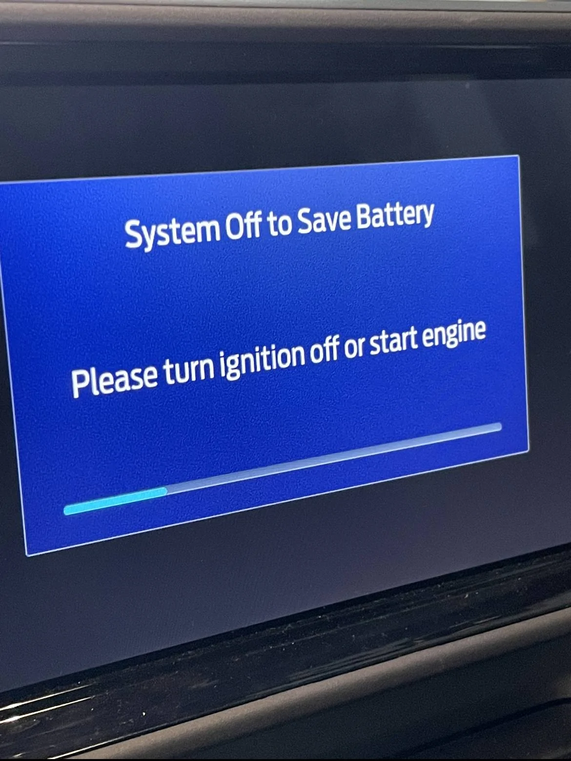

I recently had a new dashcam (VIOFO A129 pro duo) professionally installed. It is hardwired to the fuse box.
More recently, approximately a month after installation, I have been getting screen notifications as shown in attachment about the battery life. The startup chime also changes when this screen appears (video also attached).
Looking this up in the manual I see this means the battery is at a low state of charge.
Can anyone give my advice on how to prevent low charge but still be able to operate my dash cam, assuming the issue is the dash cam draining the battery? Whether it be dash cam operating setting recommendations or any other suggestions?
My current settings on the dash cam are motion detection park mode at low sensitivity, and up to 12 hours of park mode.
I would prefer to be able to use this park mode, as I am in a shared parking lot at home, work, etc.
The frequency of this happening changes. It can happen maybe once a week to as frequent as every other startup. So I don't believe this is because of the car sitting off for long periods.
Could an issue also be my shorter commutes not being able to properly charge the battery? My daily commutes are approximately 15-20 minutes to work and back.
Any advice or information would be greatly appreciated. I am not very experienced in car mechanics or electrical work, so anything helps!

If it's hardwired, it would depend on how its hardwired. If you don't want parking mode and it was wired to a module that turns off with accessory power (the fuse isn't active when the ignition is off), that shouldn't cause issues. If you're non-stop recording without voltage protection, that could be a wear on the battery, and the battery management system may disable features (Sync 3 not in standby, FordPass connected features from phone app/voice assistant not available) if the voltage or battery health is too low.
Viofo's default hardwire kit for the A129 Pro Duo is the VIOFO HK3. It doesn't have a battery of its own, but it does have a switch for the cutoff voltage (when the voltage dips past the amount the switch is set to, the hardwire kit cuts power to the camera, preventing further battery drain). If you used this kit, you may just need to change the switch to a more aggressive setting (higher battery voltage that the hardwire kit stops supplying power to the dashcam at.)

Sounds like you paid someone to install it, but that it was not, in fact, professionally installed. Or to be less sarcastic, you shouldn't be seeing this on your info screen and the fact that you do suggests something has not been done properly.
I installed the Viofo system in my truck and it went very smoothly. I am running a dual camera setup with the parking features on ... and I've never had a battery issue, even with my truck parked for days on end.
To properly install the Viofo A129 Pro Duo, you should have used the Viofo HK3 Hardwire Kit. Part of this item includes some built-in battery protection in the module itself. So, you should be able to locate this and it will look like this:
Ford Bronco Sport Question about dash cam / battery usage 61ftPj8cXTL._AC_SX679_
From there, you can adjust the selector to better protect your car's battery. Just move the selector to the right to be more and more forgiving to the battery. It should never reach a point where your car's circuitry comes into play.
The wiring kit has three wires that need to be connected to ground, acc (12 VDC switched), and battery (12 VDC always hot). Sometimes people get lazy and connect both to always hot ... or simply make a mistake and accidentally wire the ACC to an always hot circuit. That may be why the battery is being run down. Either way, properly setting the module should allow the dashcam to shut down before your battery is run down too far.
