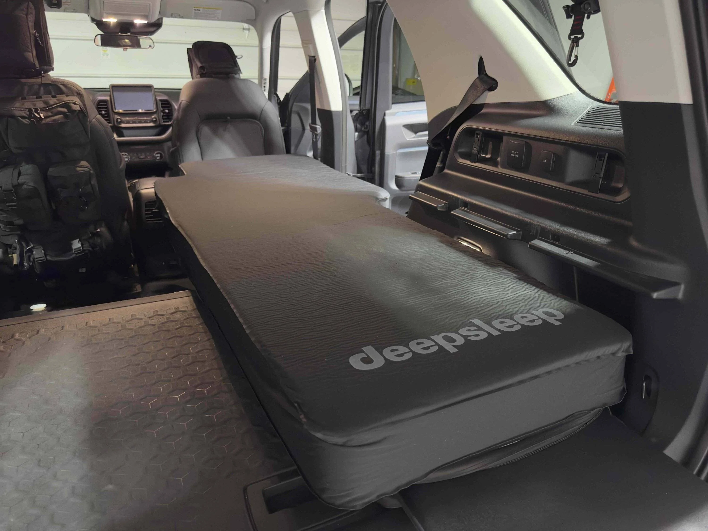

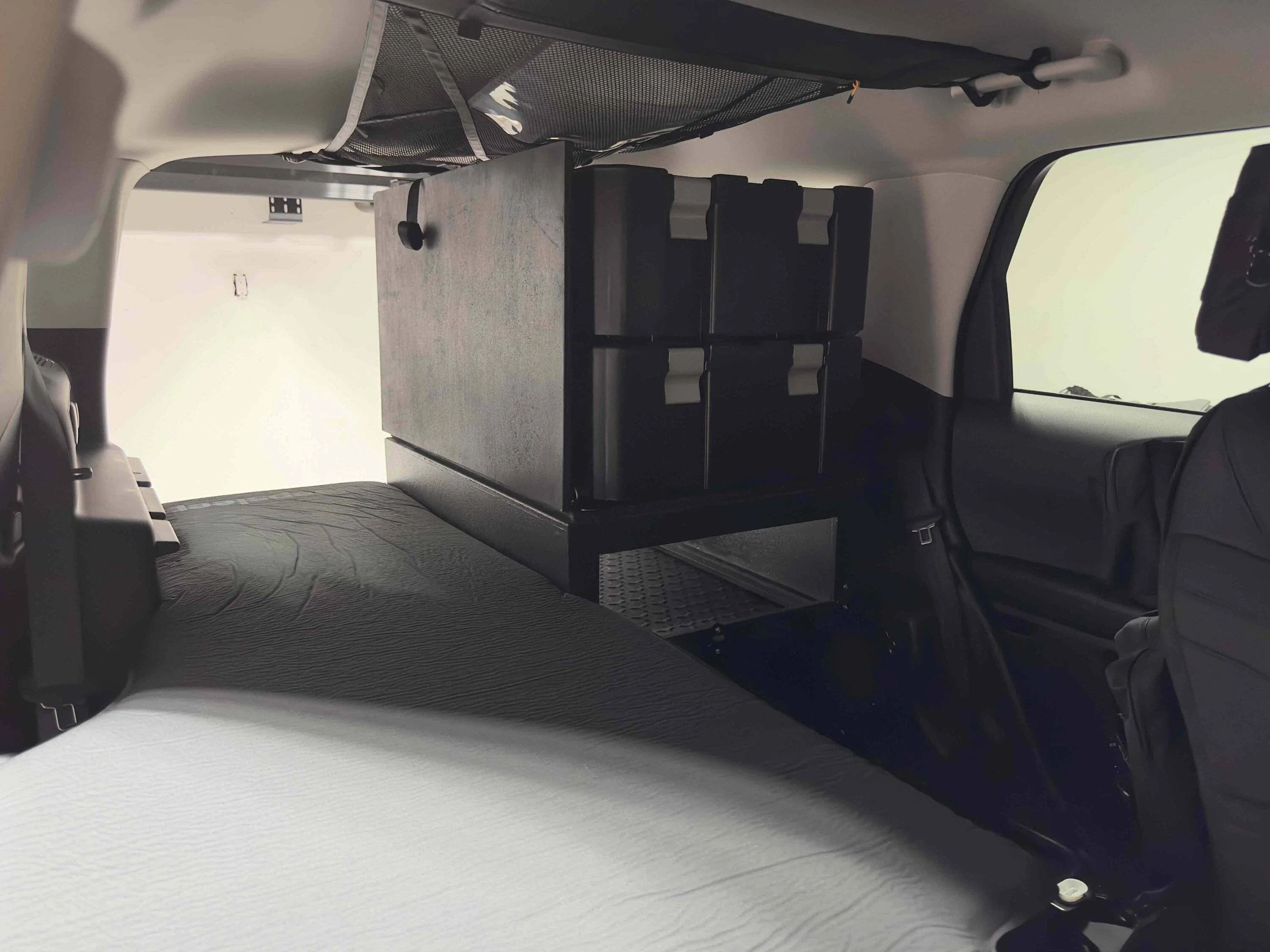

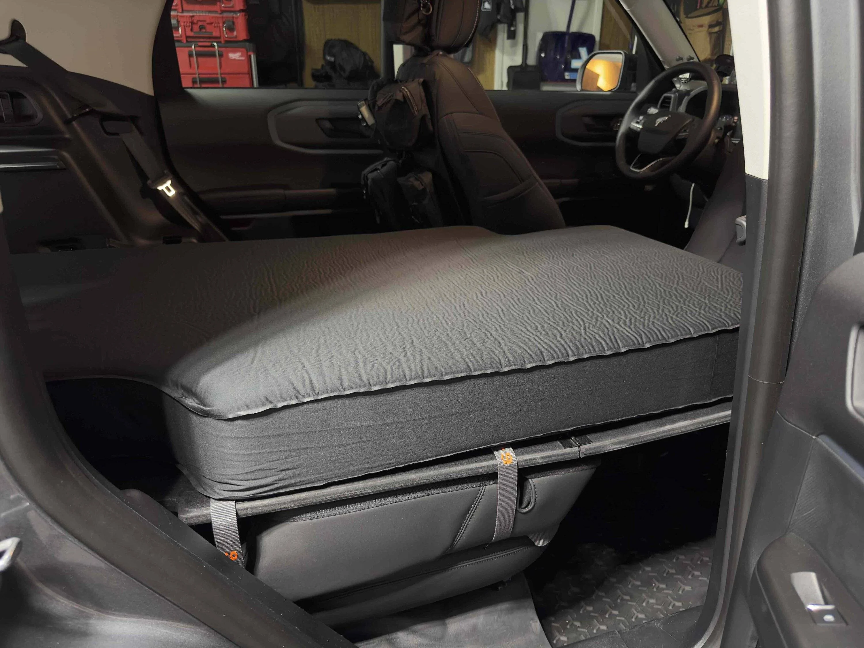

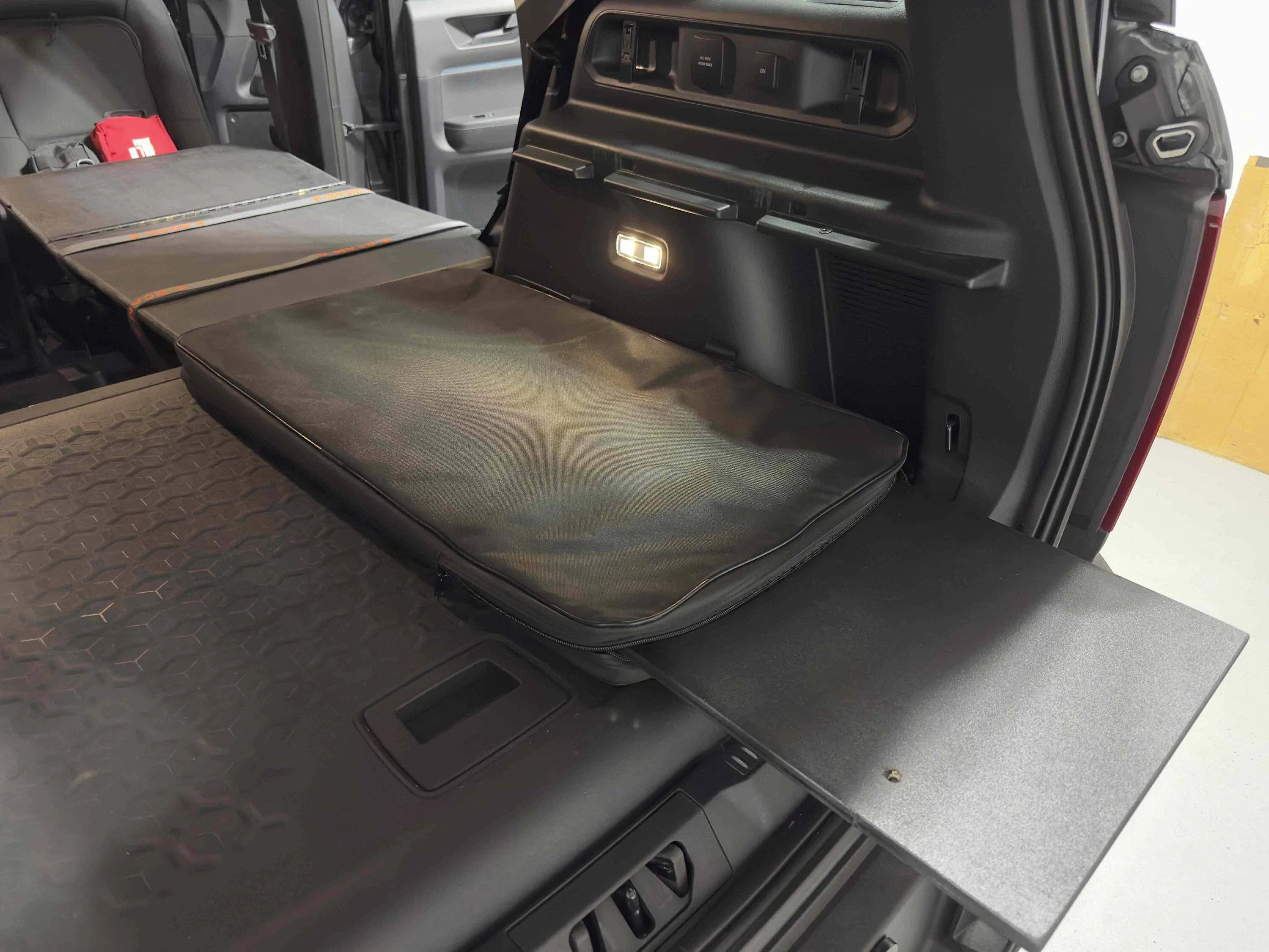

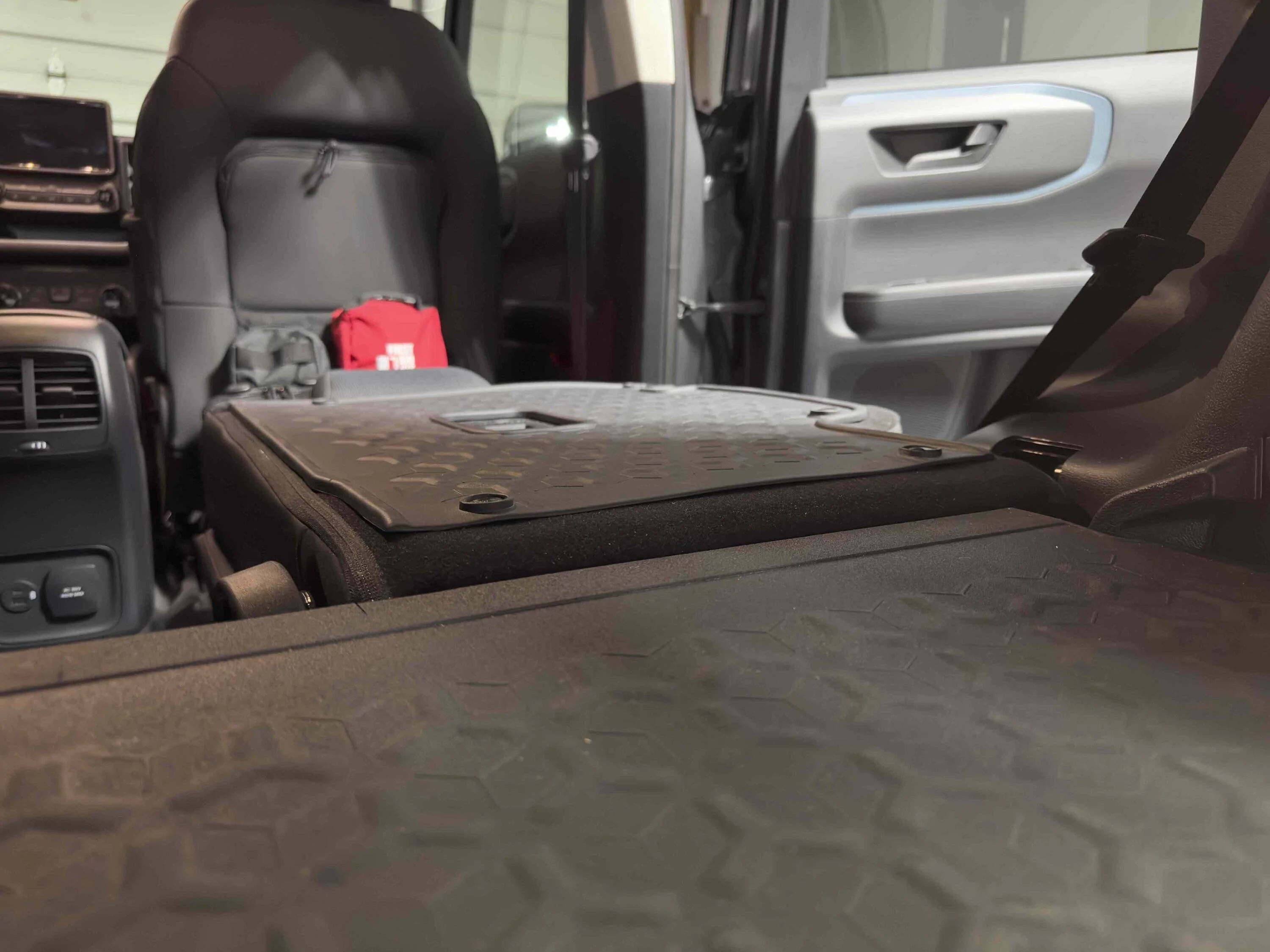

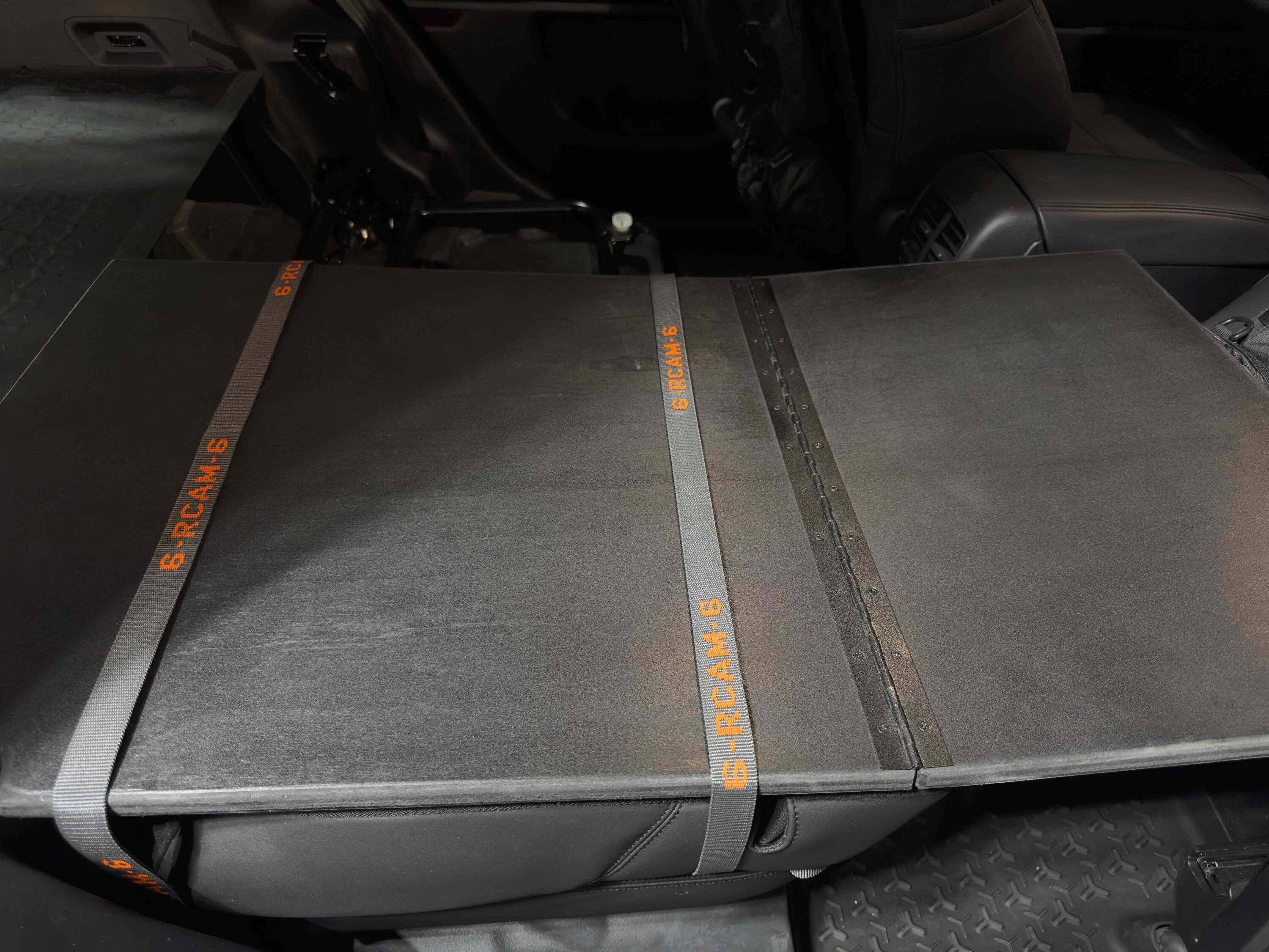

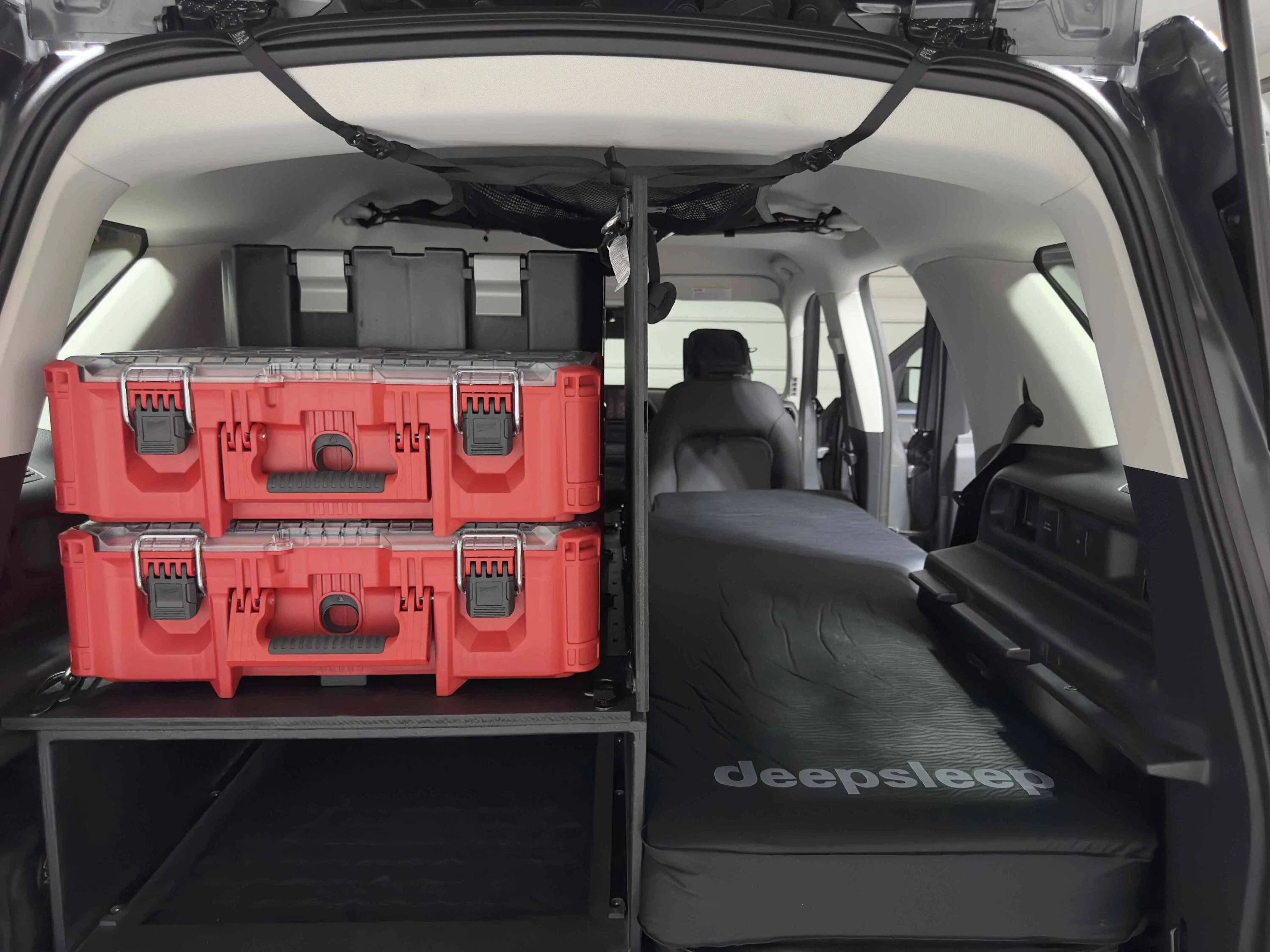

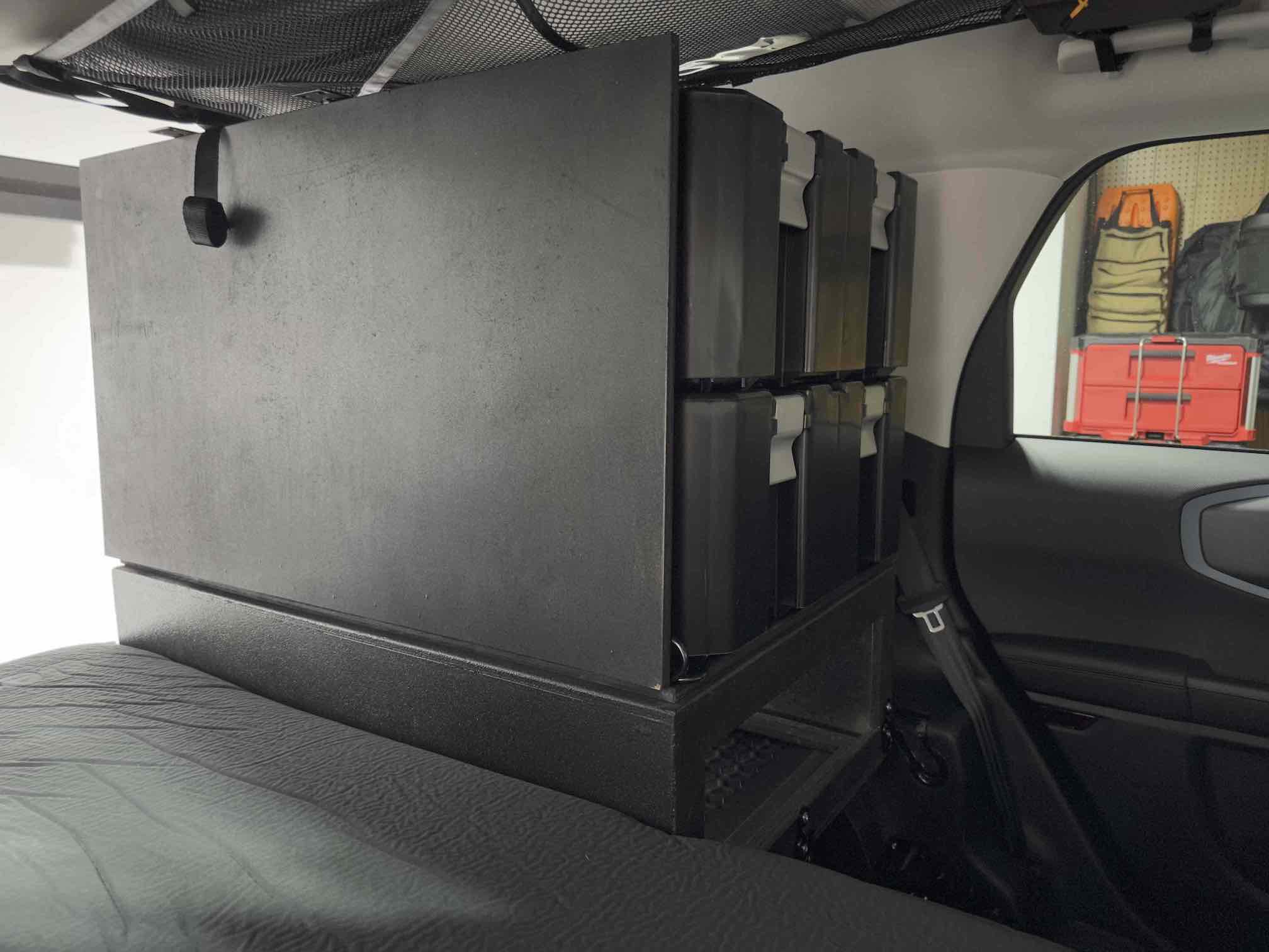

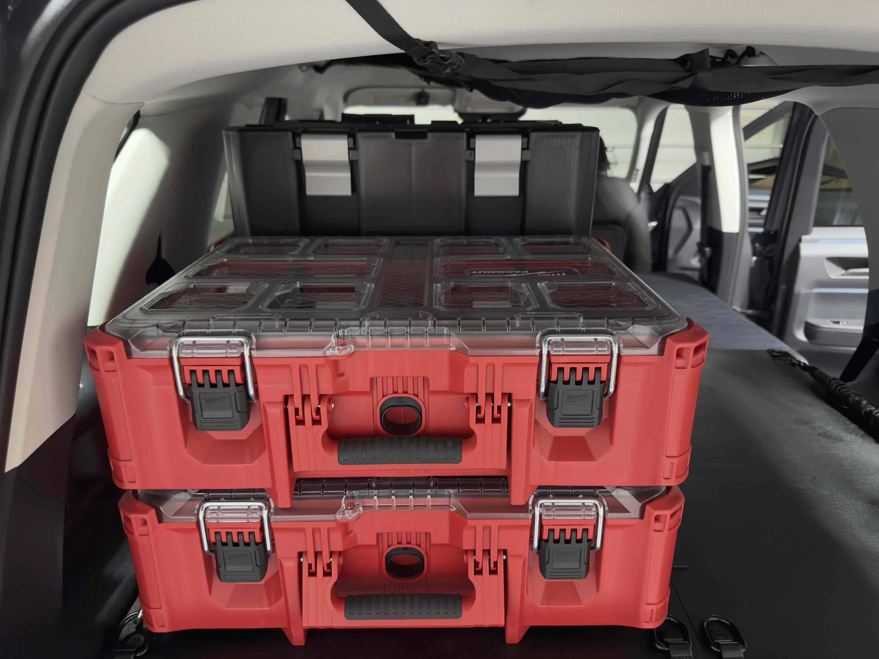

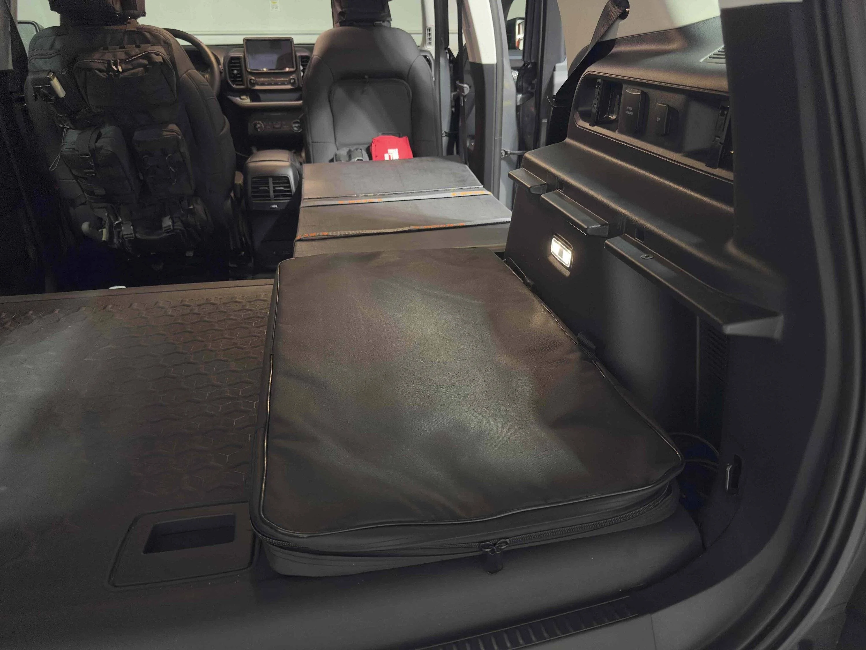

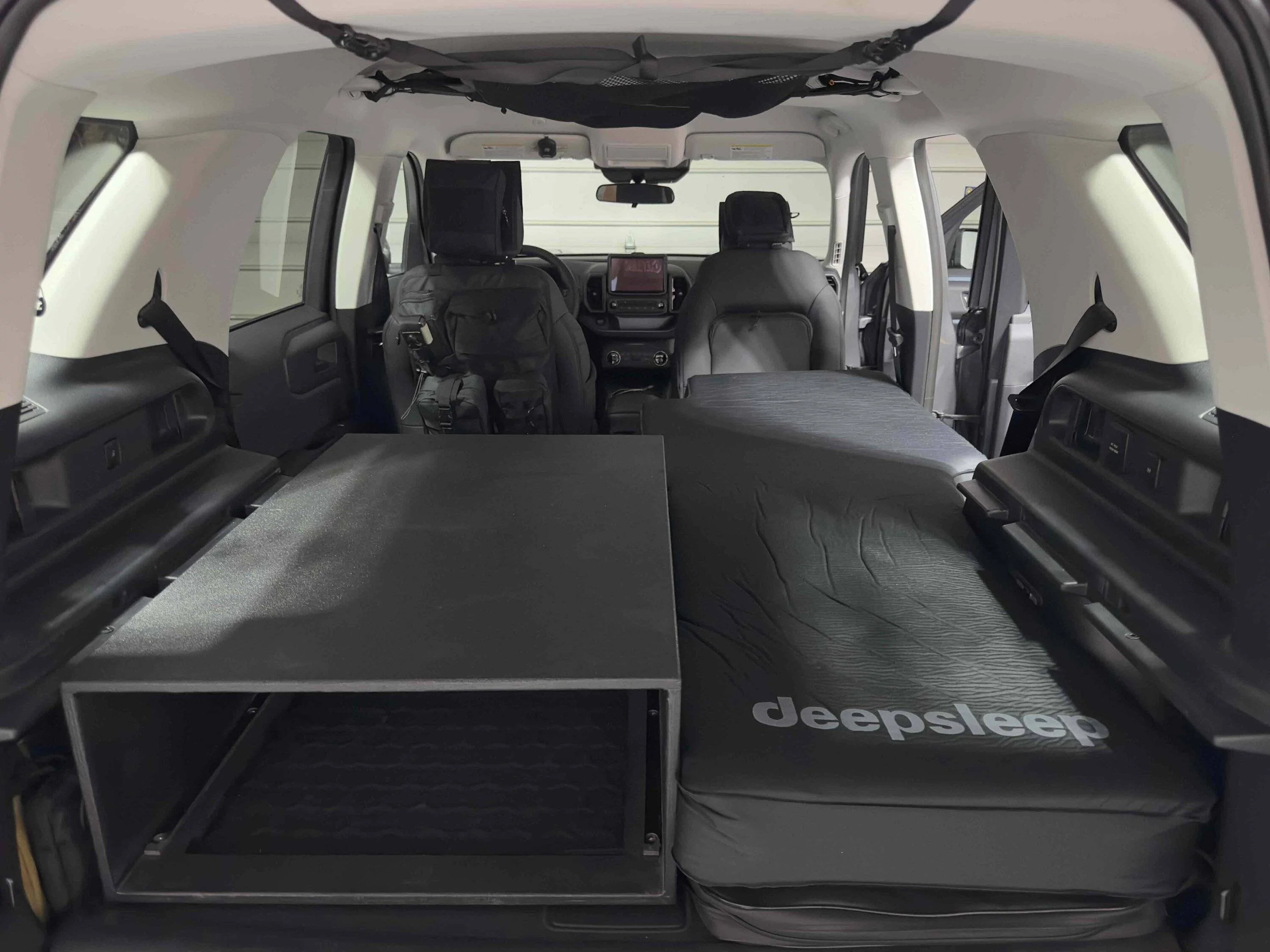

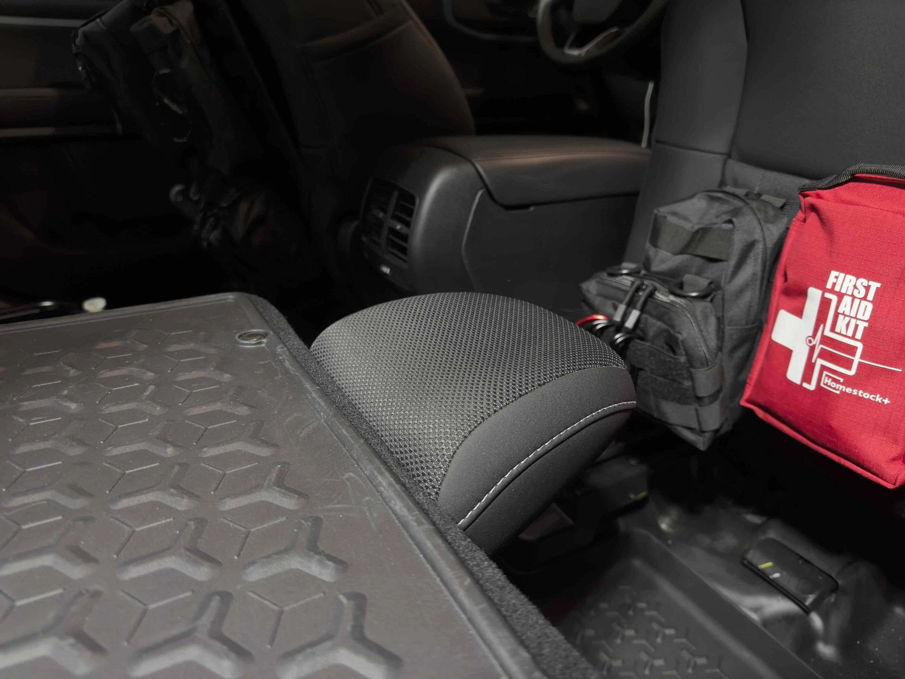

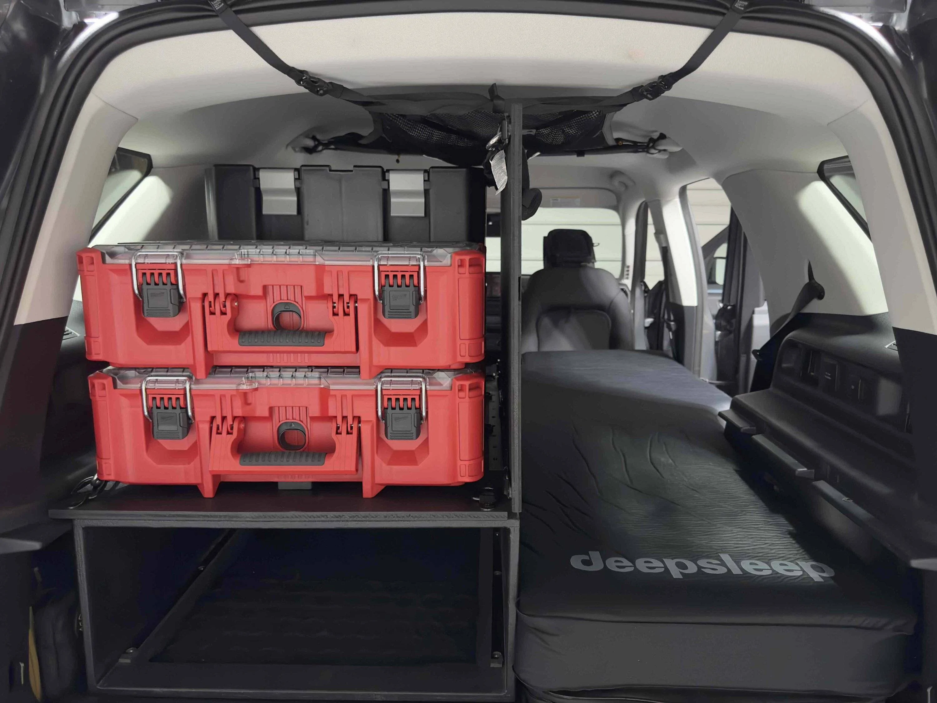

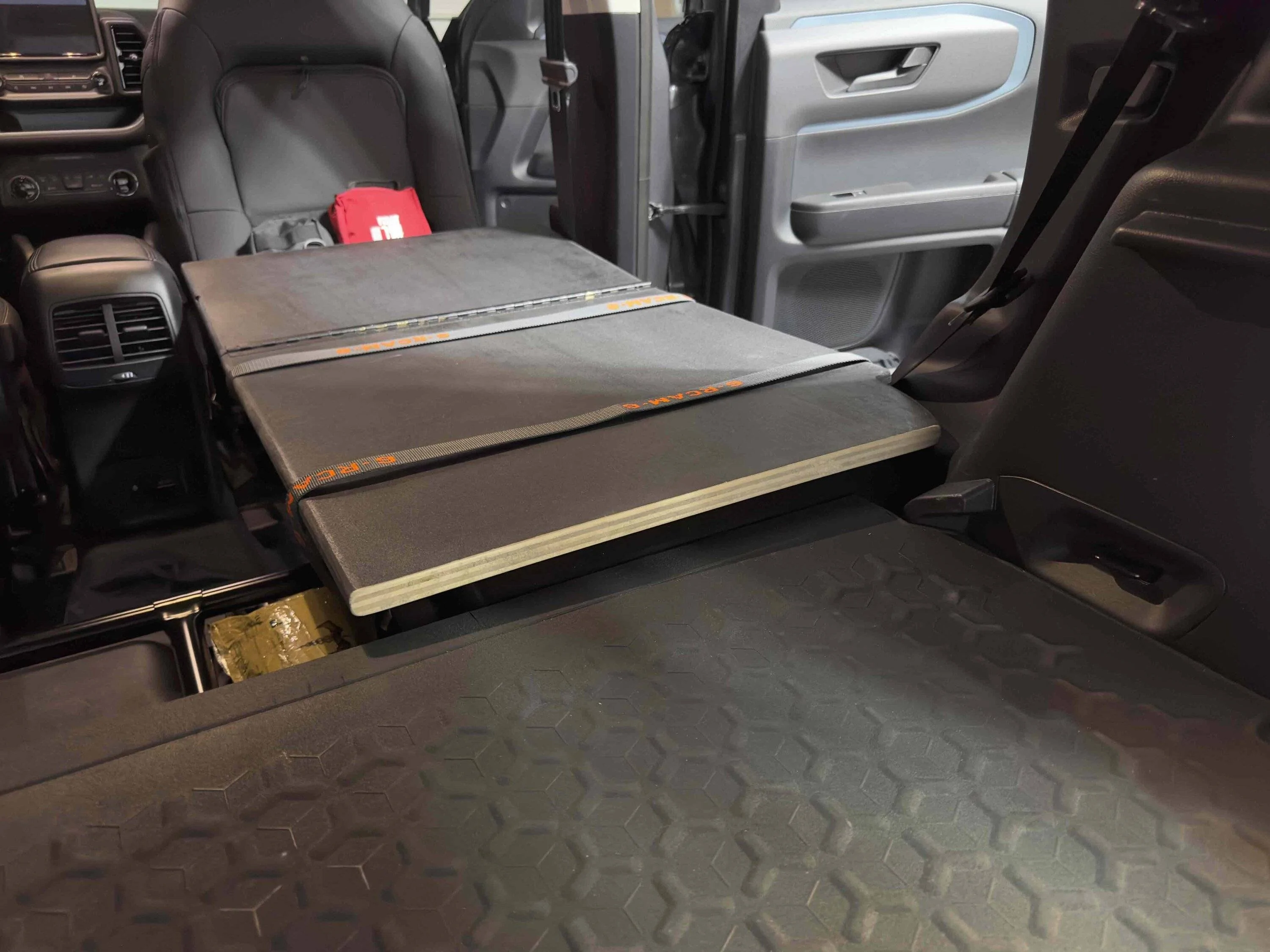

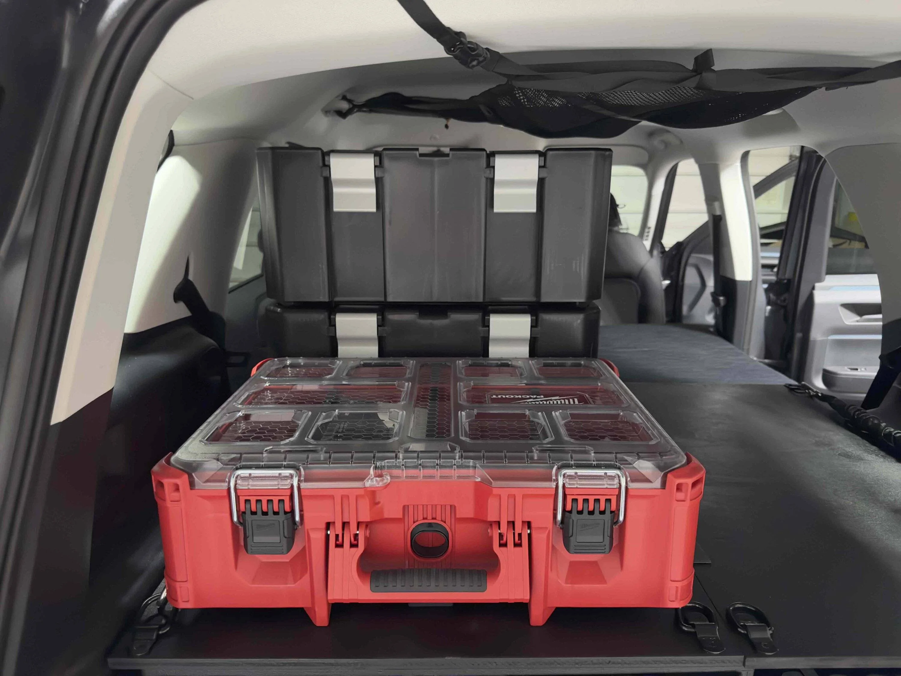

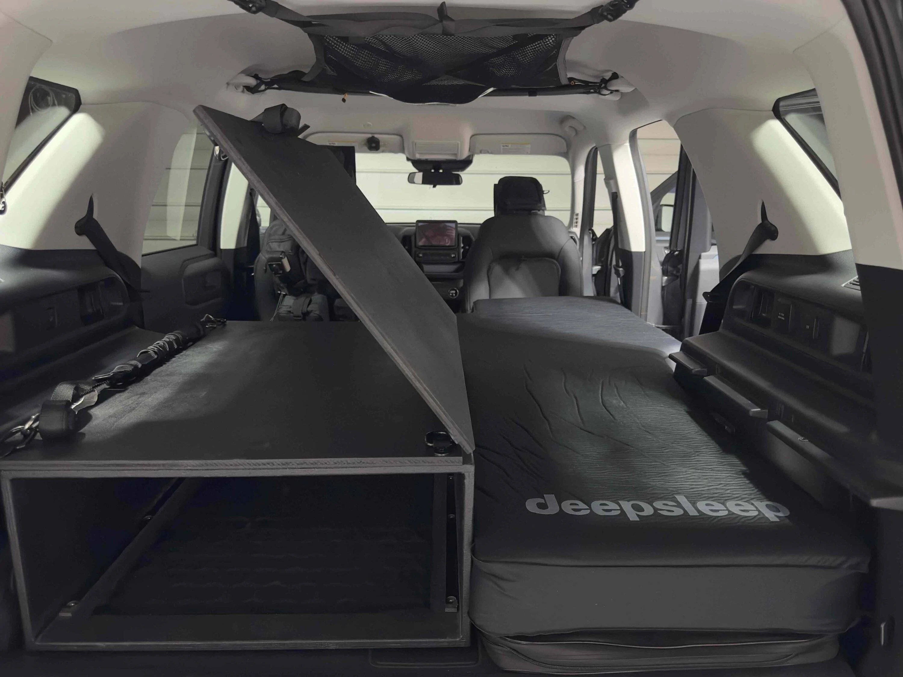

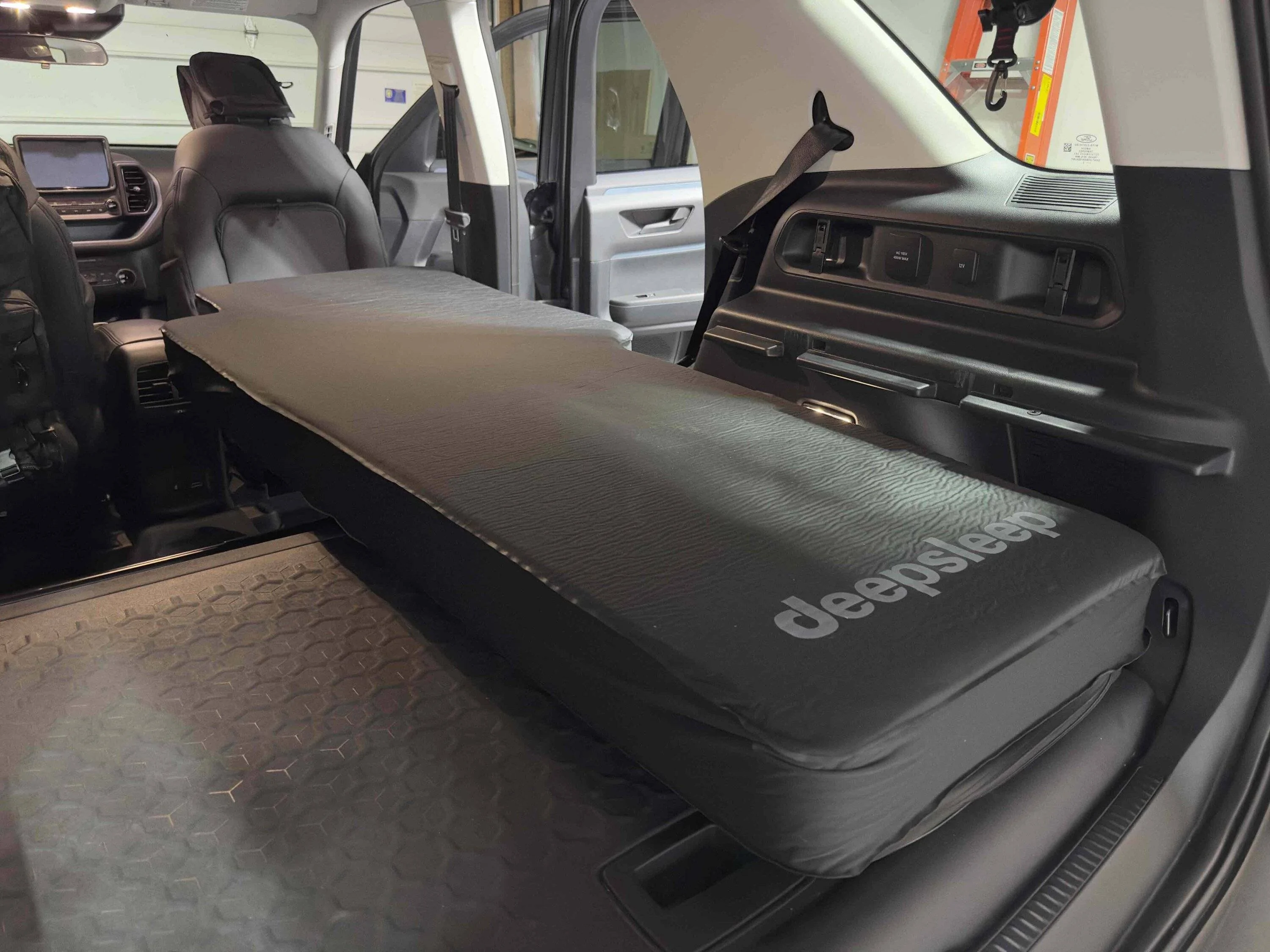

Here are some images and explanation Harold C, that might give you a better idea of the setup.
  1. With the passenger seat folded down (the storage container beneath the seat was removed), the seat only sits about an inch above the back deck. I also turned the headrest backwards, which makes is a flat extension, giving a few more inches of support.
  2. The 'sleeping board' is strapped to the seat with a couple of roller-cams to keep it secure. When the board is folded at the hinge, you can put the seat back all the way, which is nice during travel.

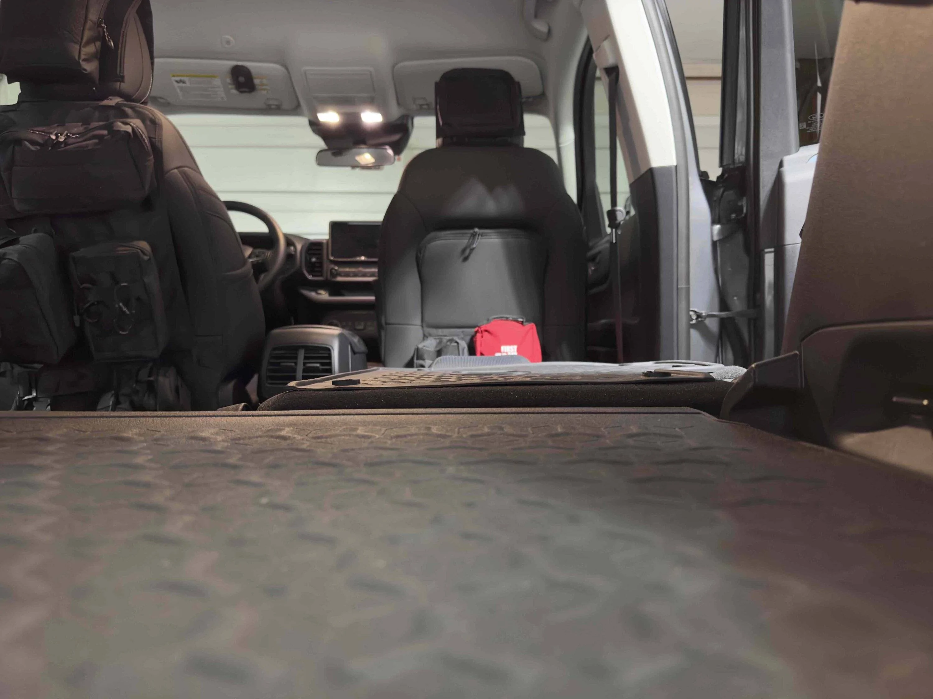

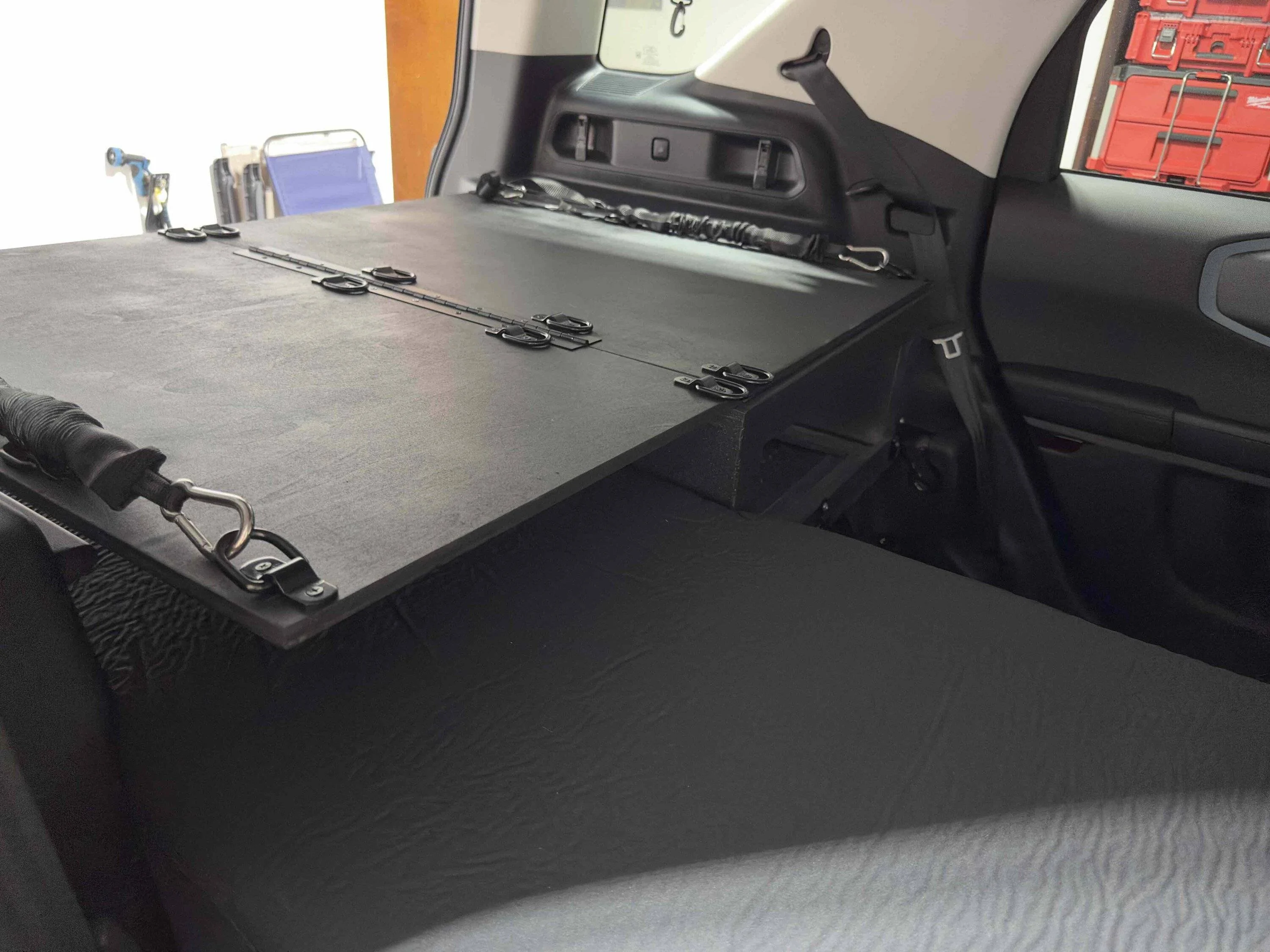

  3. Unfolded, the sleeping board extends over the backwards headrest, all the way to the seat.
  4. The sleeping board is made out of 3/4" birch plywood, so that adds 3/4" to the seat height over the back deck.
  5. I made a little table out of 3/4" birch, and with the bag and flanges to hold the legs, it levels out the back deck to match the sleeping board. You could put just about anything flat there, just to fill the height. And, even with the slight difference, once the mattress is in place, you don't really feel it.

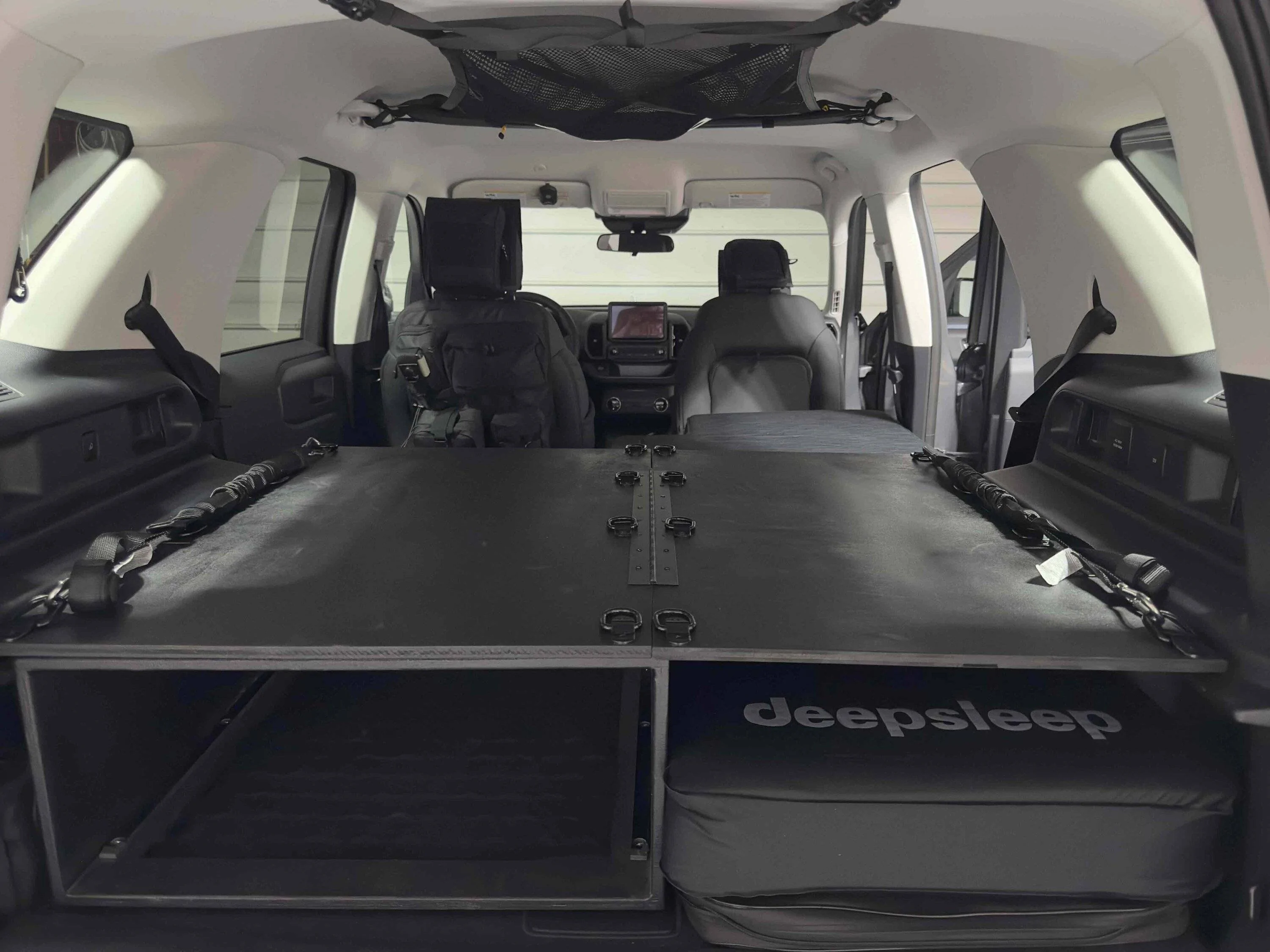

  6. Highly recommend the DeepSleep mattress. Amazingly comfortable and warm.
  7. On the other side of the mattress, you need something 9.5" to 10" in height to be able to use the custom shelf I made. You can use the one that came with the Bronco, but you have to find a place for it when you want to sleep in the back. I wanted something I could keep in place, but 'open' when needed. The drawer I purchased was exactly 10" high and supports the hinged shelf.

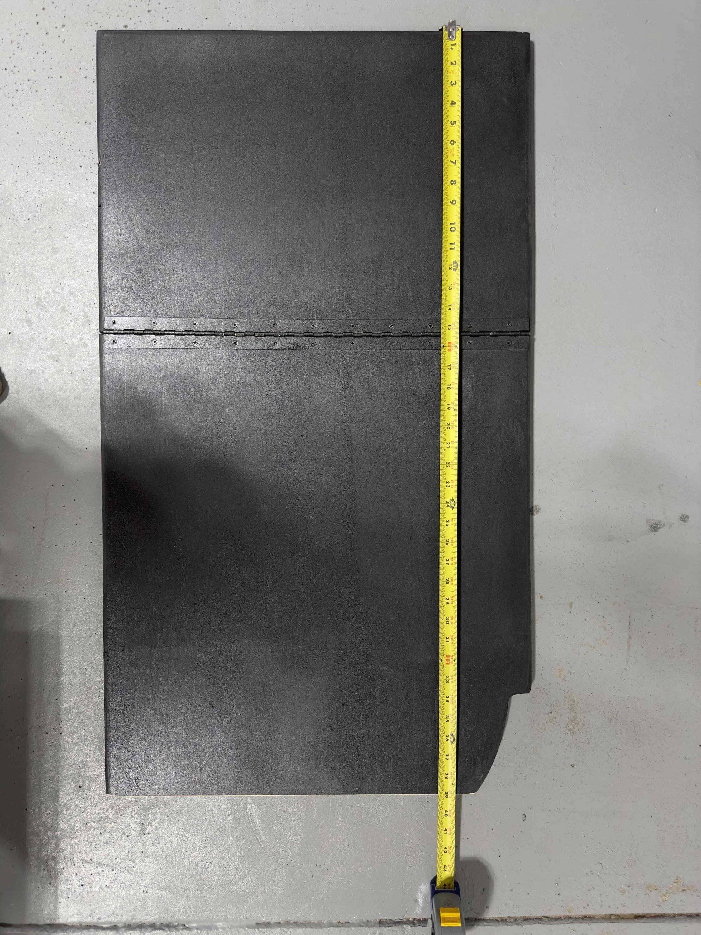

  8. You can make the shelf as deep as you want, I made mine to match the length of the drawer which is 32". Folded down, it makes a great workspace for my laptop when sitting on the mattress.
  9. On the cargo shelf, I used the factory version as a template. I made the hinge point at 22". This allows some versatility with using WolfPack's or Milwaukee Packout's, or both. And was the minimum room needed for the mattress. One could obviously change/adapt those measurements for any situation.
Hopefully this gives you some things to work with. Let me know if there any other details you want.
