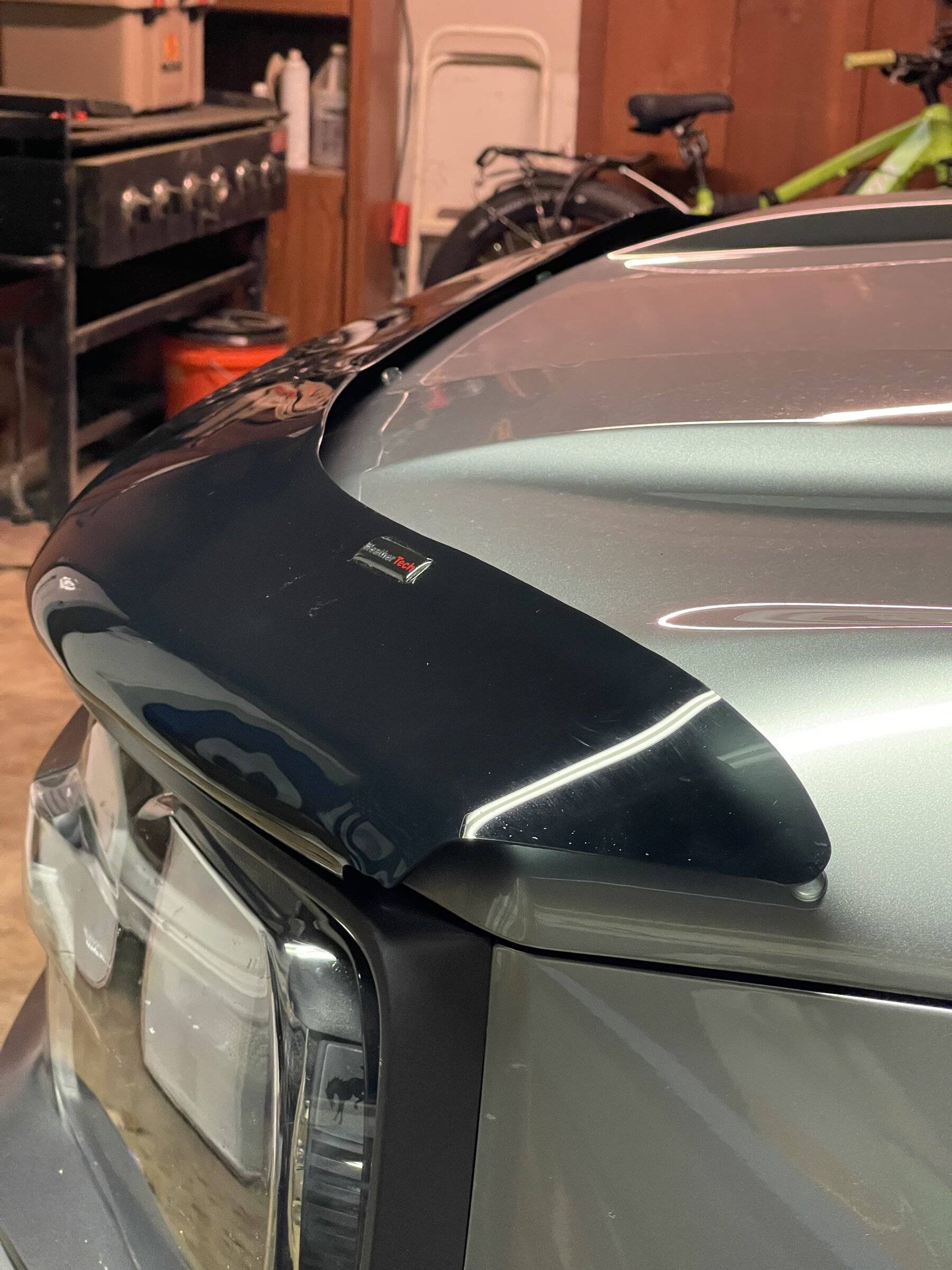

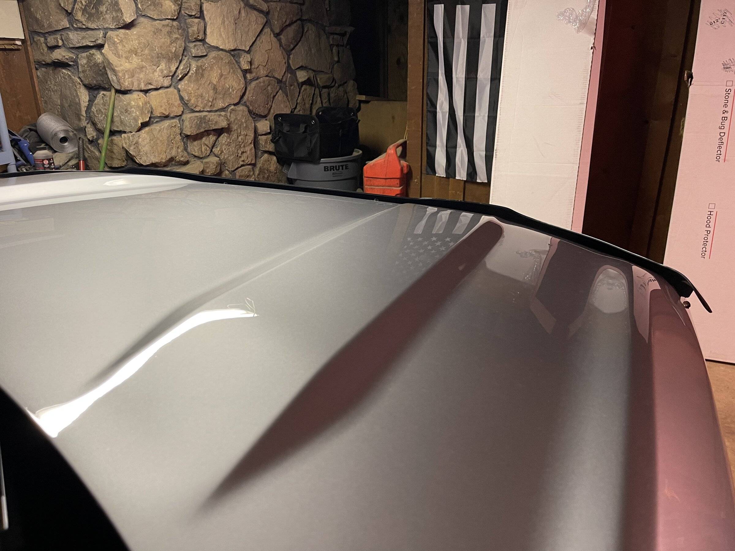

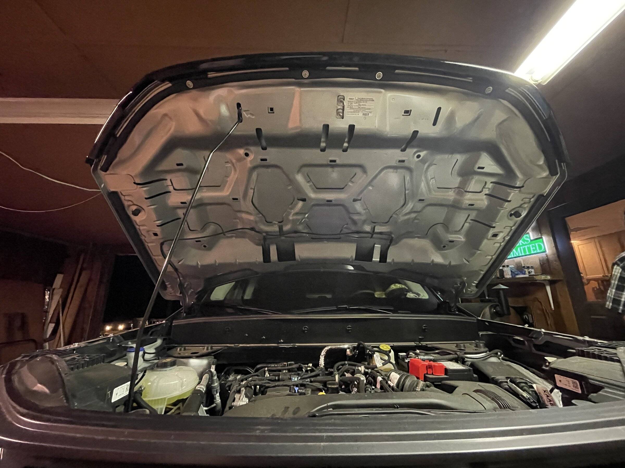

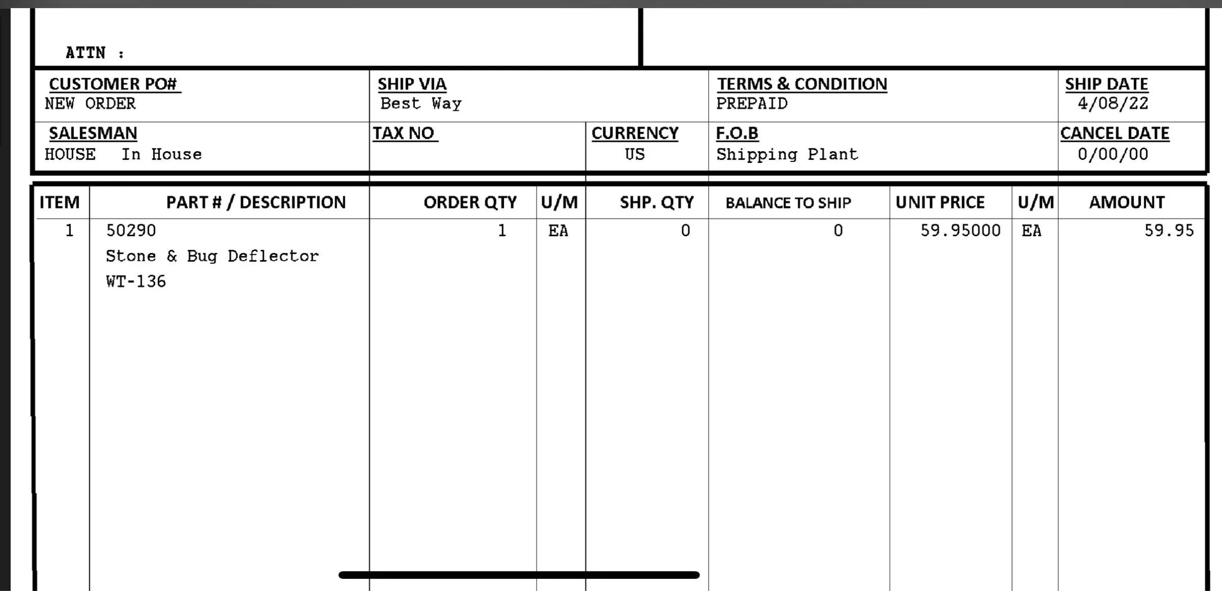

I ordered and installed the WeatherTech “stone and bug deflector” part number 50290. It does not attach to the face of the hood with tape. I did not like the idea of taping something to the hood…. It will hold moisture at times, and will be a pain to remove.
This model uses existing holes for the hood gasket to mount under the hood and float off the surface of the hood. Quick and easy install.
Ford Bronco Sport WeatherTech rock and bug guard, under hood edge mount AFE729B6-802A-46A7-8B47-C73778FAF0C7
Ford Bronco Sport WeatherTech rock and bug guard, under hood edge mount 4C57AE28-F331-45C3-941E-166B9E0FCF01
Ford Bronco Sport WeatherTech rock and bug guard, under hood edge mount C3F66FC7-081E-456D-A82D-7411576F4BD8
Ford Bronco Sport WeatherTech rock and bug guard, under hood edge mount 296AED8C-B685-4F4C-AC81-6902E40B19DE

Does this only protect the hood leading edge, or does it help keep bugs and rocks off the windshield?......Thanks

I can't locate that model number on their website.
I’ve had a few of these over the years, never get the stick on kind.
They help with bugs on the windshield to varying degrees but you have to be at highway speeds for that tiny uplifting wing angle to work.
My black BS has three small rock chips on the hood but only one is down near the leading edge.
This deflector like the ones I’ve had before are nice and help but if I had had one on I’d still have gotten the other two rock chips.
They are worth the money if you spend even a quarter of your time above 50 mph.
Looking cool ? That’s up to the individual.
Gas mileage hit, probably not on our Bronco Sport bricks as we absolutely do NOT have a low drag coefficient at all.
On a car with a low drag coefficient like my Mustang, a half mpg penalty at high speeds, but only noticeable because that car lived its life on the interstate.
But under the stated conditions the thing successfully saved my Mustang from hood chips, never had one.
It's supposed to. I've had mine on for three months. I have seen bugs fly in the updraft. Don't know yet about pebbles. So far, so good.
