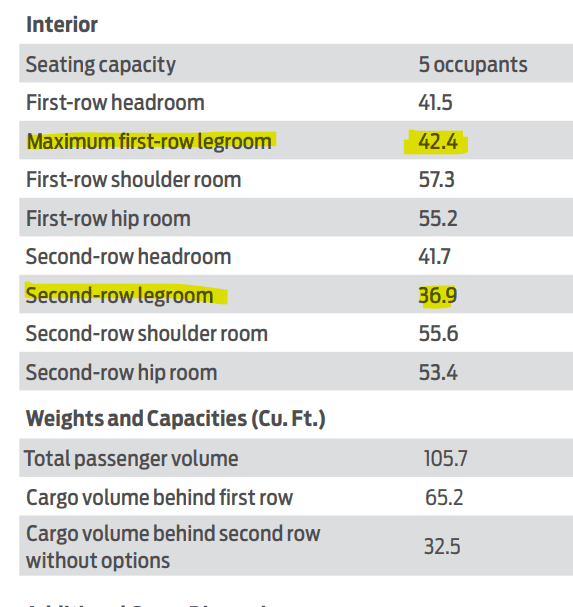

Hello.
I was looking at the official Bronco Sport technical specs and I got a little bit confused regarding legroom.
The 42.4 inches first-row legroom is refered as maximum, so I read that the seat is in its most rearward position.
But the second-row legroom, 36.9, is also considering the first-row seat in this most rearward position?
Because, if it is so, practical real legroom would be larger, since I guess it is not usual to drive with the driver's seat at its most rearward position.
I also have read that the standard way to measure second-row legroom is with the first row seat at 40 inches.

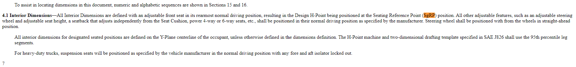

https://law.resource.org/pub/us/cfr/ibr/005/sae.j1100.2001.html
long document in the SAE....but I'm not sure it explains much. you are right, how do they measure the rear leg room?!!

well, page 6 of the document defined SgRP (Seating ref point). it says the front seat is at the most rear most normal driving position.
hm...what is a normal driving position??? I can only assume the seat is moved all the way back. considering there are cars the seats can be moved "not normal" driving position.
