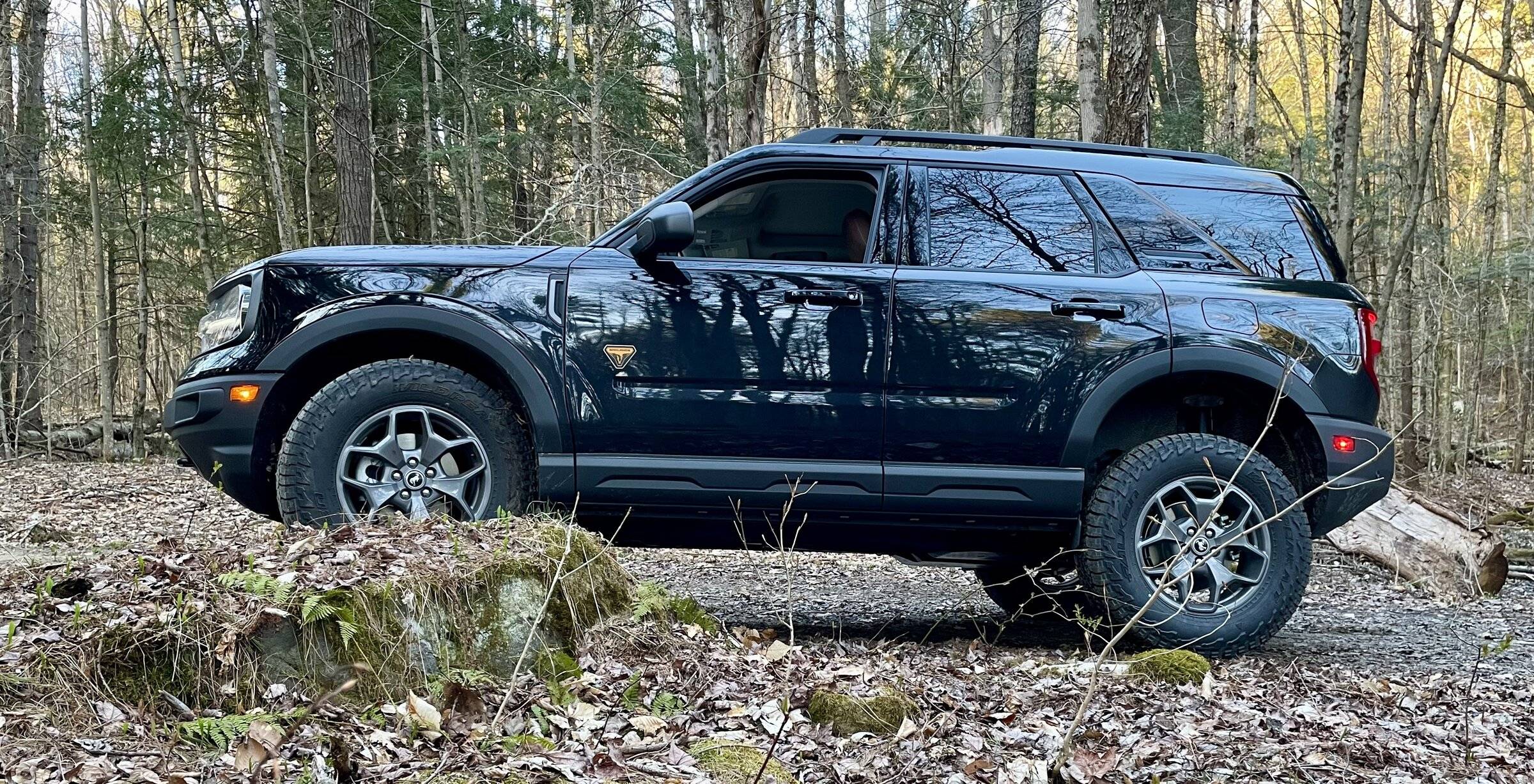

I tossed on 245/70/17 and get good amount of rub on the pinch welds/seams. Full lock is ok, but any type of off camber really pushes into the welds. Am lifted also. After pulling the wheel liner I see that it has the factory tack welds are not far from the outer edge near the tire. I’ve trimmed in other vehicles, but was just extra metal. Nothing structural or weld points. Even if I trimmed it, it still wouldn’t give me enough clearance since I wouldn’t want to remove the welds there. I mean I could run a bead down it and probs fix it, but I’m not gonna. My worry is even trimmed you don’t get a lot of clearance in the wheel well. Mud, snow, debris, etc. and then stuffing the tire in is gonna cause more issues than I can correct with trimming.
I’m gonna swap to same tire in 245/65/17 next week probs. The 70s work on street but actually off-roading not so much. Barely stuffed

Thanks for the post. This has been the general consensus. Trimming the pinch welds on a unibody is not recommended. Adding a small lift doesn’t really help much either.

This just seems to confirm that if you are going to go offroad then the 245/65/17 is the size limit without any trimming. A lift doesn't make any difference, other than the suspension needs to be compressed a little further before the rubbing starts. The ECU is mounted in the front of the driver's side wheel well, which is an area that needs trimming on some sizes of larger tires (not sure what diameter that starts at). All in all, 29.5" diameter is the "stock" limit, or maybe somewhere between 29.5" and 30".
