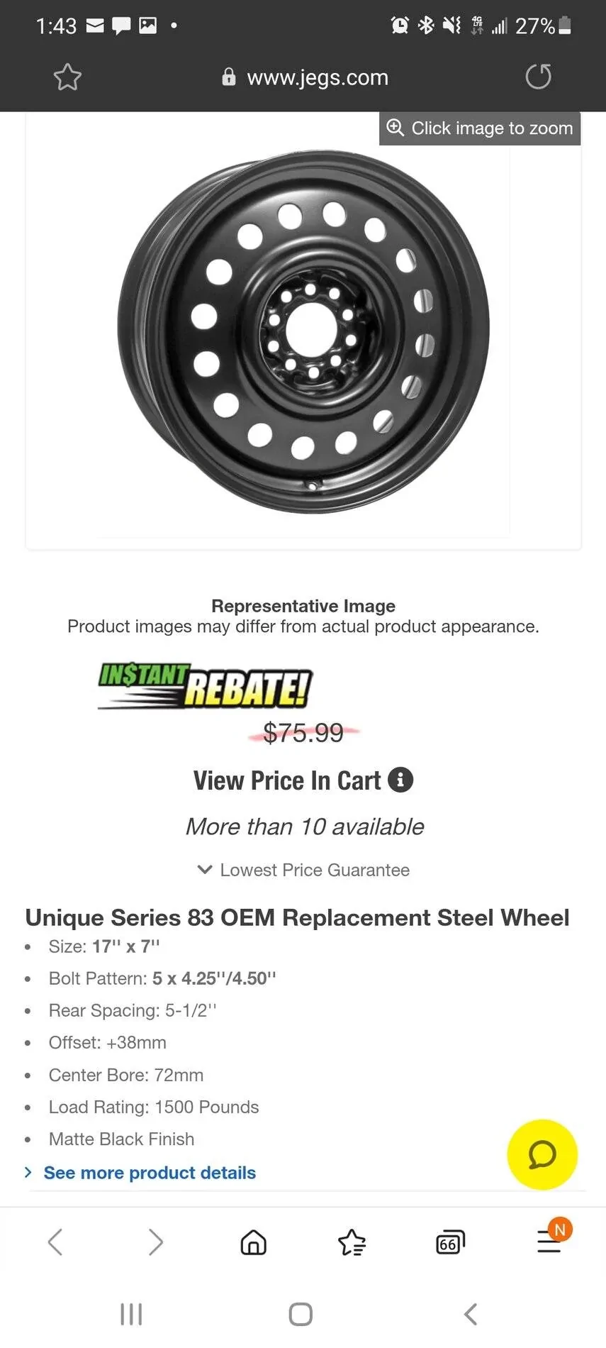

Wanting to pull the trigger on these. Anyone know for certain they'll fit fine? Will be putting some 245/65/17 on them.

Closest match Iā€™ve seen. Offset is within 3mm, same width. Larger center bore shouldnā€™t matter.

It's what I went with for my full size spare, so it had better.
