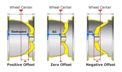

Typically speaking, offset and backspace are essentially two different ways of looking at the same thing. They determine the location of the wheel and tire assembly when bolted to the vehicles hub.
Offset is the measured distance between the hub mounting surface and the wheels center line.
With X being the determined offset, the hub mounting surface on positive offset wheels is X amount forward from the wheel center line. The hub mounting surface on negative offset wheels is X amount backwards from the wheel center line. The hub mounting surface on 0 offset wheels is the wheel center line.
Backspacing is the measurement from the hub mounting surface to the very back edge of the wheel.
Generally speaking, the higher the offset/backspace, the more the wheel will tuck inwards towards the suspension or away from the fender. The lower the offset/backspace, the more the wheel will push out away from the suspension or towards the fender.
For Example:
*If the offset on a 9" wide wheel is +12mm, the hub mounting surface will be 12mm forward from the wheels center line. Measuring from the hub mounting surface to the back edge of the wheel, the backspacing is 5.5"
*If the offset on a 9" wide wheel is -12mm, the hub mounting surface would be 12mm towards the back of the wheel from the wheels center line. Measuring from the hub mounting surface to the back edge of the wheel, the backspacing is 4.5"

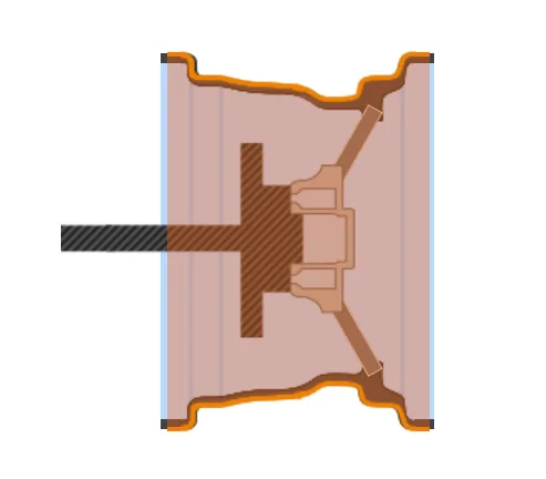

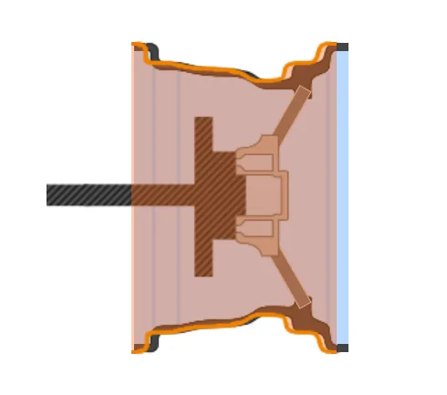

Here's a visual, orange is the 17x9 +12mm offset and blue is the 17x9 -12mm offset. In this example you see the lower offset extends further out both with the inside lip of the wheel as well as the outside lip of the wheel.
