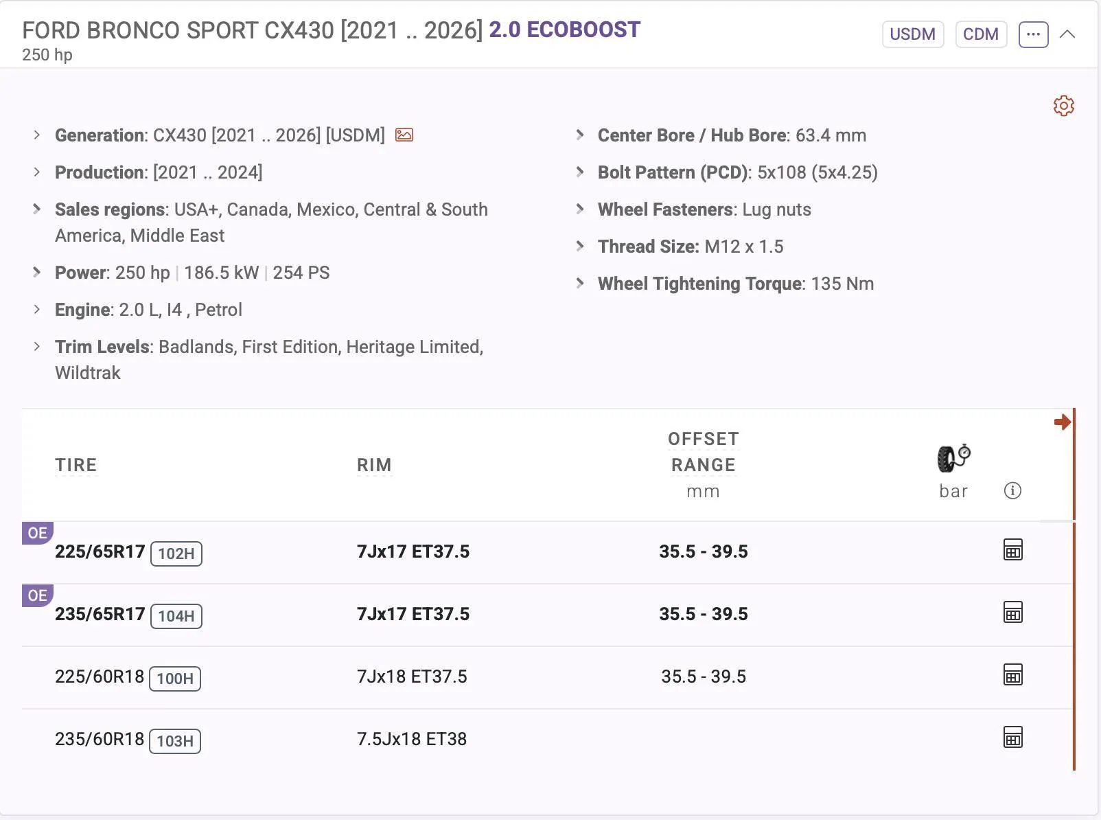

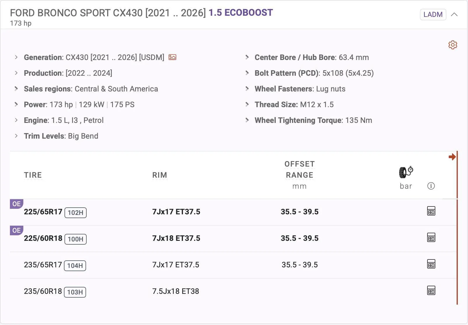

The 2021 Bronco Sport's factory wheels specs are:
17x7" or 18x7"
7" width
+37.5 mm offset
Note: these are the same specs as the Maverick pickup's wheels

Please put the hub-centric diameter in the first post.
Please also add the lug dimension 5X108 = 5X4.25

7" refers to the width of the wheel between the wheel rims. 245 is the width of the tire tread. Wider wheels can accommodate wider tires. When you look at the specs for most tires they will list required wheel width.
OEM tires for all trims are 225 width. The Badlands has an option for a 235 width tire.
