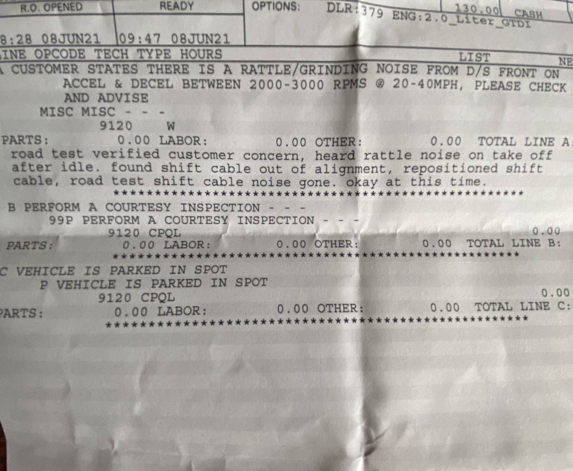

Whether or not it is a bad sound or not, I would bring it in to Ford to look at. I have the same issue and I had mentioned the loose shift cable to the tech, but was told that they spoke with an engineer and that these noises are “normal” and due to the solenoids in the transmission preparing for a shift.
Now, I do not think these are “normal” noises personally (and likely the shift cable/other issue), but what I do have is a service record saying I brought it in for this specific issue with a detailed explanation written for it, so if it becomes a larger issue I have a paper trail.
Hope they fix it for you though ?

I have that exact same noise. My son works for Ford and he spoke with an engineer who said Ford can repair the cable that is causing this noise by "adding a noise dampening weight." It is going to the dealership next week to be looked at. Fingers crossed.
