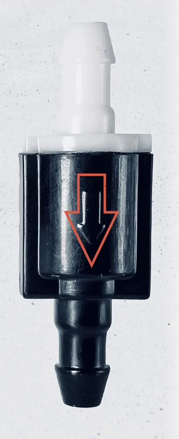

Both front and back were leaking. I installed this on the front by the tank. Plugged back.

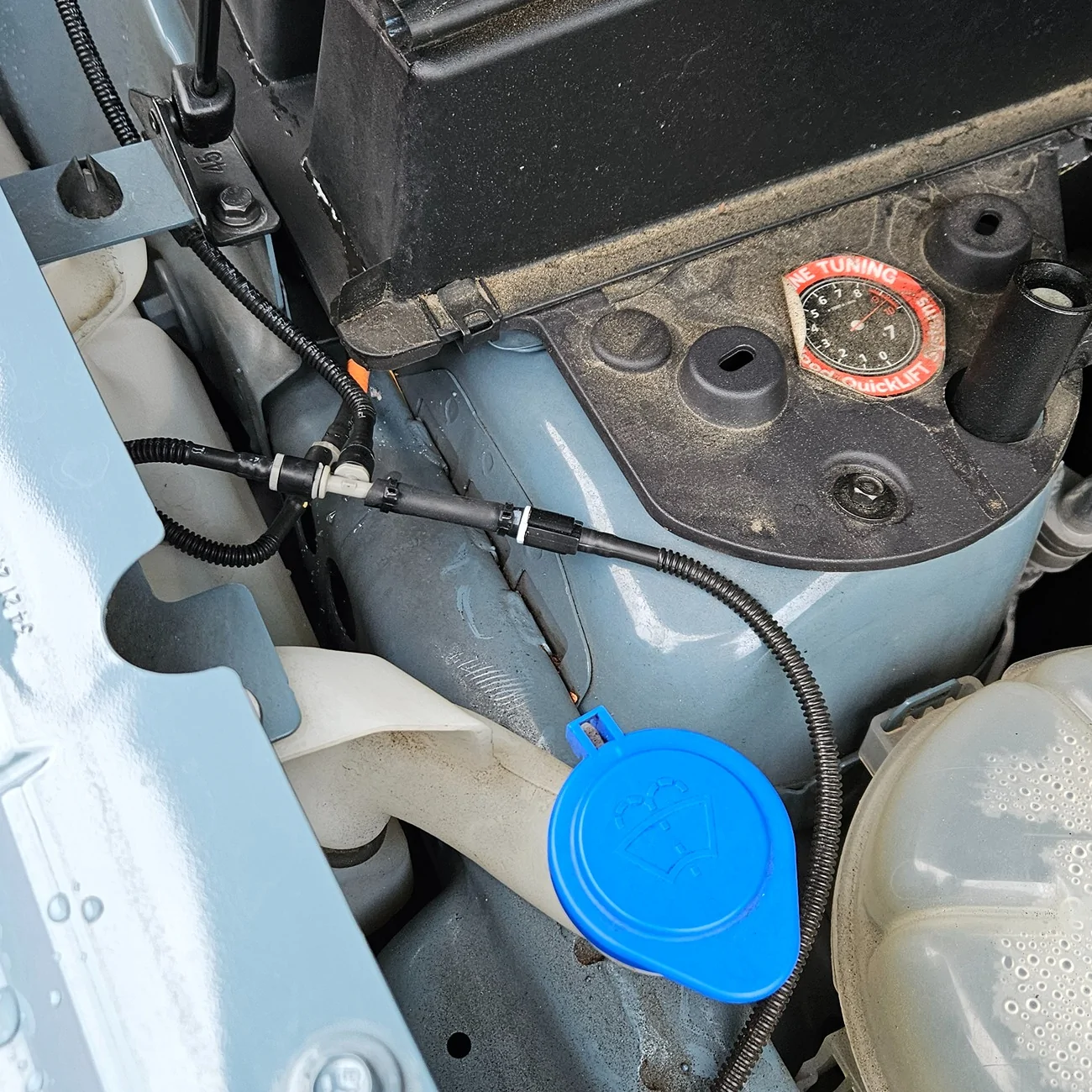

@Chief of the Boat … Did you install the check valve close to the tank or close to the front camera?
I’ve seen owners do either option and both seem to work

Here you go.
Ford Bronco Sport Washer Fluid Leak From Camera Nozzle 20251017_084309
Professional install! Thanks for the clear pic.
after using the front camera washer have you noticed any residual flow or dripping out of the front camera washer until the fluid in the length of tubing (on the camera side) past the check valve drains out?
