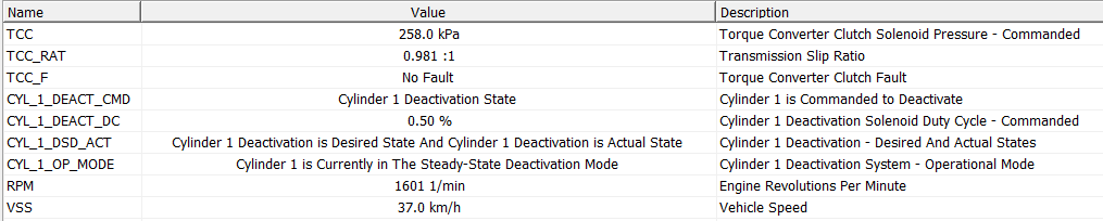

I have been tracking this down and have isolated the issue to this. Low load condition, low speed, low RPM, torque converter is locked up and it is in a reasonably high gear, 5th. So basically you have a two cylinder engine propelling your car at low speed in a higher gear. Perfectly normal to experience a mild shudder in these conditions. I don't like it but it is normal. I am wonder if Ford will program out cylinder deactivation at these lower speeds. I will post some freeze frame data concerning this issue.
Ford Bronco Sport Vibration on 1500rm 10mph BS BB 1.5 Bronco Sport shudder.PNG
