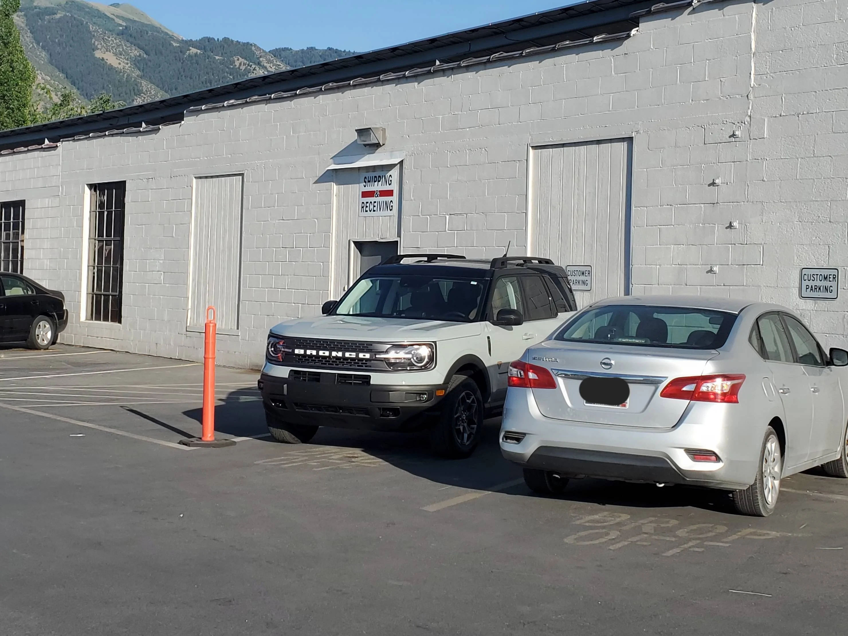

Well, when I went to get in today, the battery was deader than dead. I had to jump it and drive it down to the dealership where I left the keys in the drop box and we drove the truck home.
I'm guessing it's a module, solenoid, switch, or something like that which isn't turning the fans off and they just run until the battery dies.
Obviously I'm not real pleased with a two-day-old car being in the shop already.
I hope the diagnosis is quick and the parts are available ??
This wasn't the sight I wanted to see
Ford Bronco Sport Two Days Old - Already In The Shop 20220710_191734
I'll let you know what they say.
