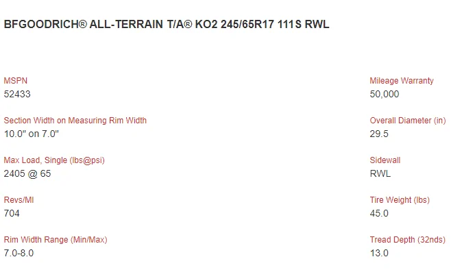

Discount tire lists the 245/65/17 KO2's as 34.57lbs, but I see tiresize has them at the 44lbs.
How have you liked your AT3W's? Are they loud?
The BFG's own printed specs has the 245/65/17 at 45 lbs:
Ford Bronco Sport Tire Comparison 1690127896865
I have always run KO2s on my trucks and I love em, but I just didn't want the Sport to feel like it has lead feet - especially with the 1.5L Dragon.
As far as the 235/65/17 AT3Ws I put on, they have been really solid. Noise has not been a factor really at all. They feel like better contact to the road than the OEM Contis, although I will say that the factory tires were very smooth. The Falkens are still a nice smooth ride, but not as smooth as the Contis - which I personally viewed as a pro - it is supposed to be a rugged vehicle, not drive like a Lincoln. The rain handling on the Falkens has been really good. I got caught in a real deluge the other day, lots of water on the road at highway speeds. Never hydroplaned once. Excellent grip. Couldn't have asked for better.,

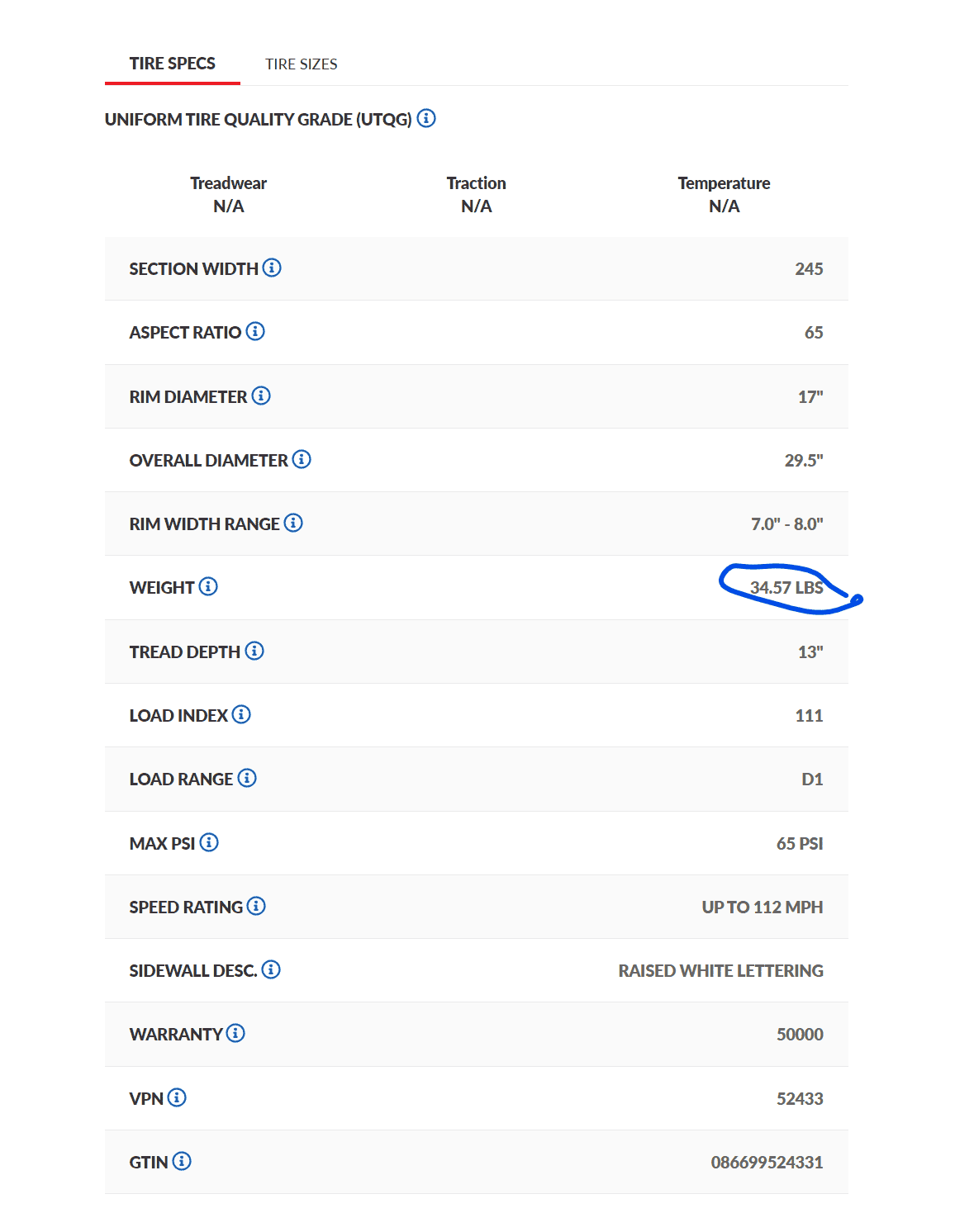

Here is discount tires specs on the KO2
How has your MPG been performing since the change?
Ford Bronco Sport Tire Comparison 1690133708932

My apologies for the conflicting information @omahafordowner . I would default to the manufactures stated spec here. Most LT tires in this size are 40 lbs + in weight. Thank you for calling this out, I'll forward this to our product team.

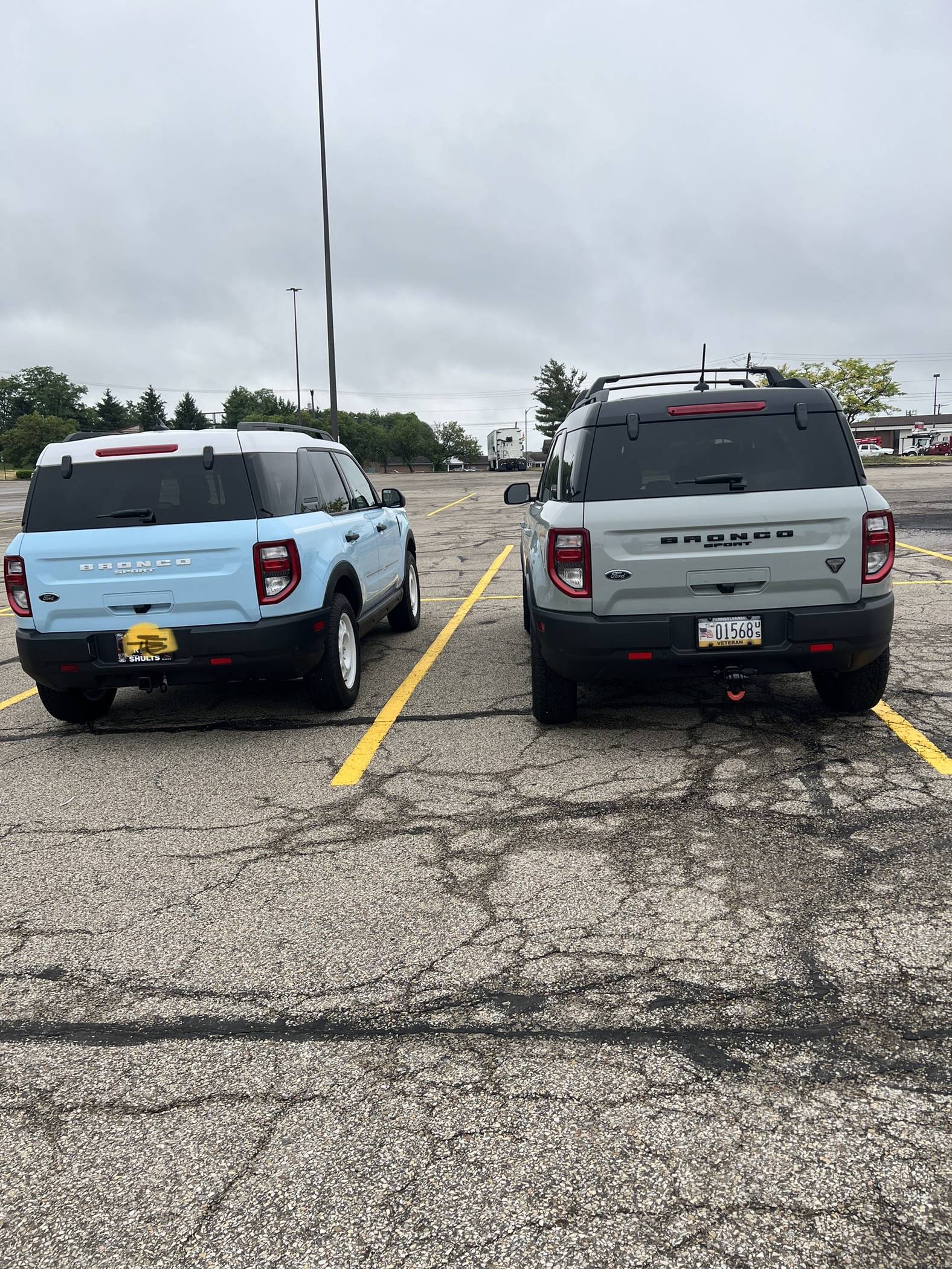

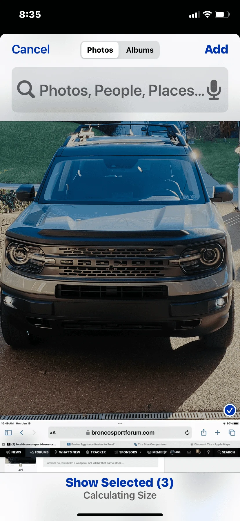

I'm very interested in hearing more about these tires, are you running stock suspension, no lift? No issues? How do you like them overall? According to the specs they are slightly lighter and slightly taller than the 245/65/17 AT3W which for me is making them my number 1 choice.

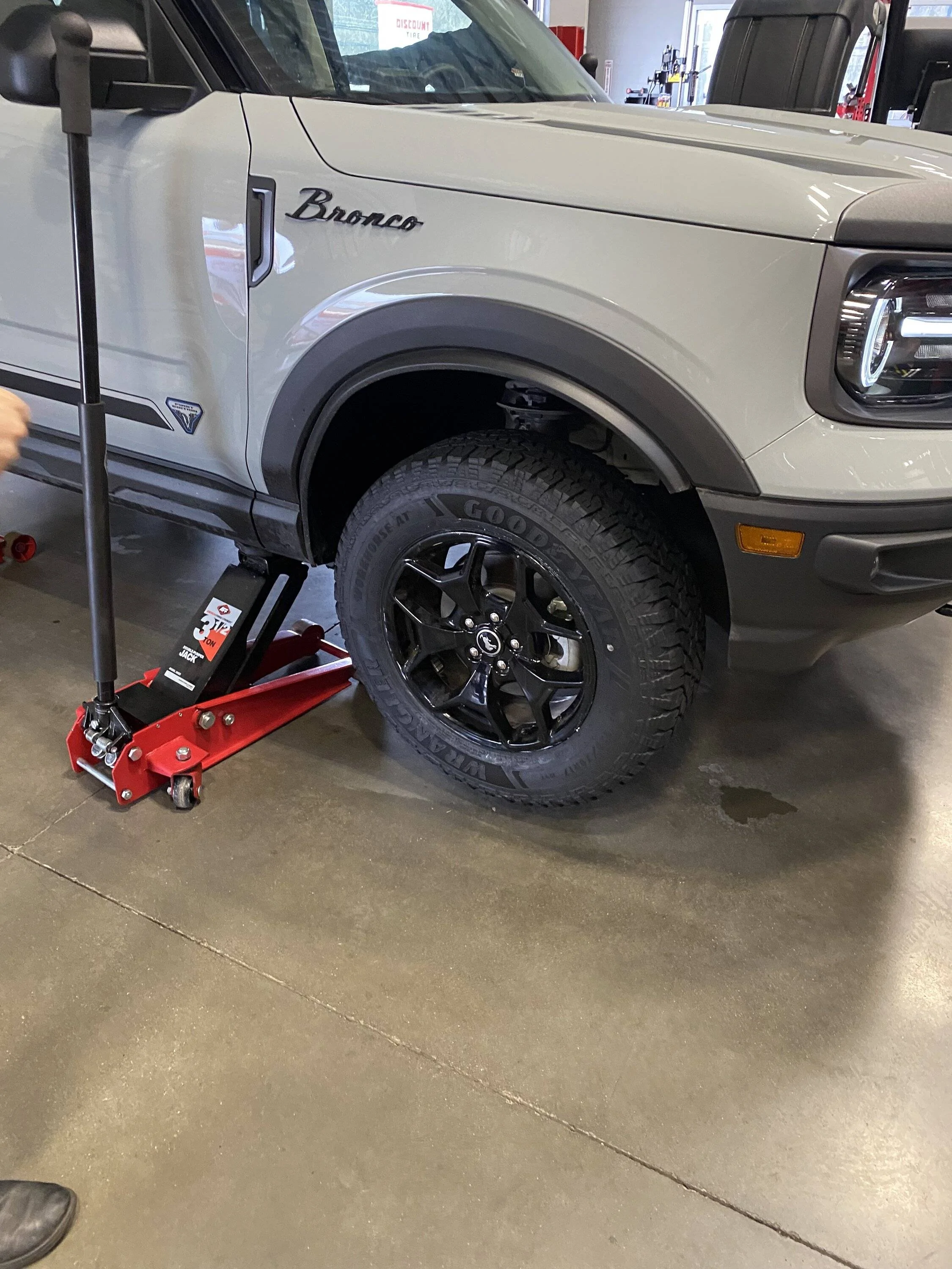

235/70/17 on stock first edition , 30 inch tall , that is max height without any change in lift.

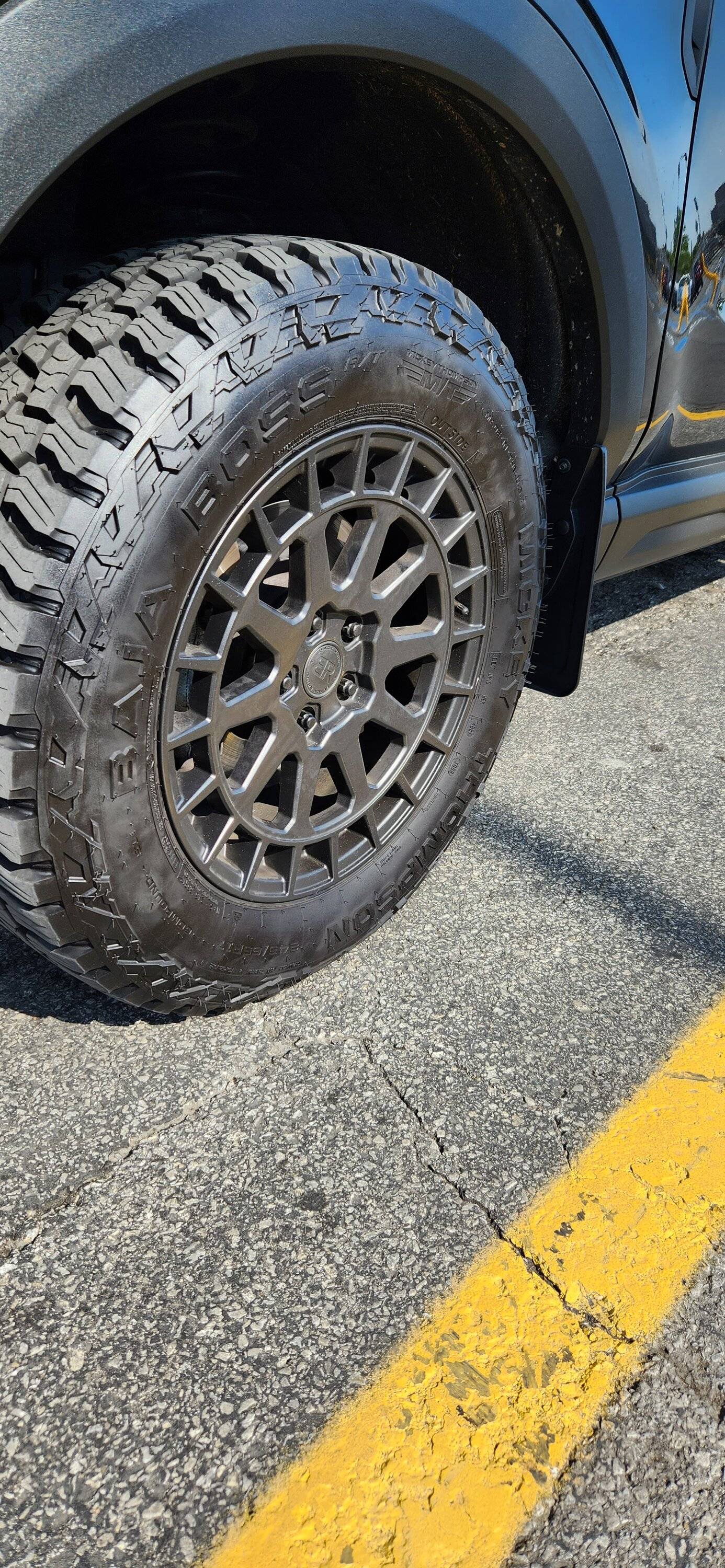

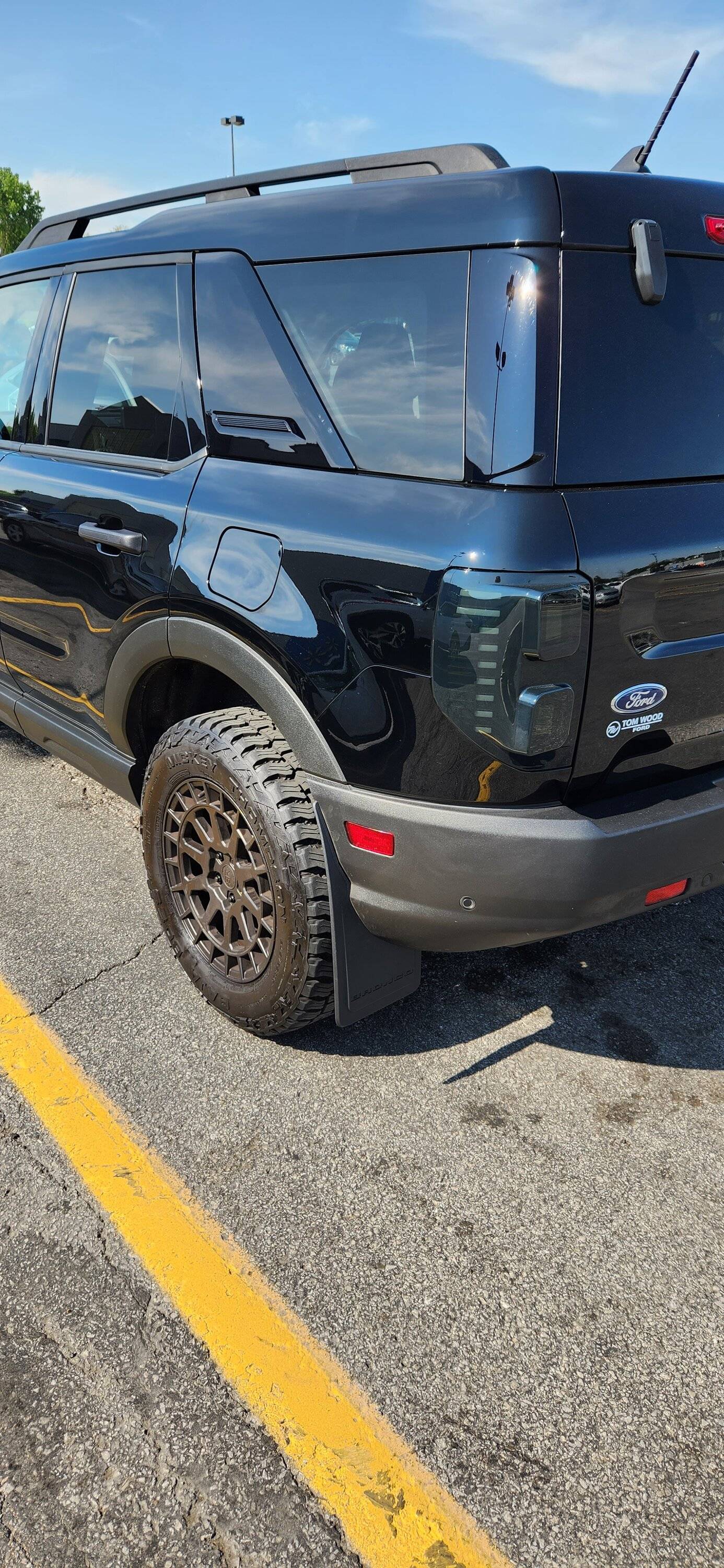

I have the RC lift, otherwise stock except replacement wheels along with the tires. I like them a lot. They have a nice aggressive look and provide good snow traction. I've really only been "soft-roading" so I can't get into much about the deep mud performance or extreme off road conditions.
Sidewall design is supposedly very strong. The tread pattern is very nice on the eye and is asymmetric so it has a good mix of on road capability and siphoning for wet environments. The mix of on and off road tread design helps reduce road noise as well, which was a big concern of mine. The tires can be rotated to any corner because of the asymmetric design as well. I do notice a bit of under steer in the rain, but I also purposely try to slide it around a bit in the rain so take that with a grain of salt. 60,000 mile warranty :like:
There is no rubbing at all and it gives a nice look overall. I would recommend them.
