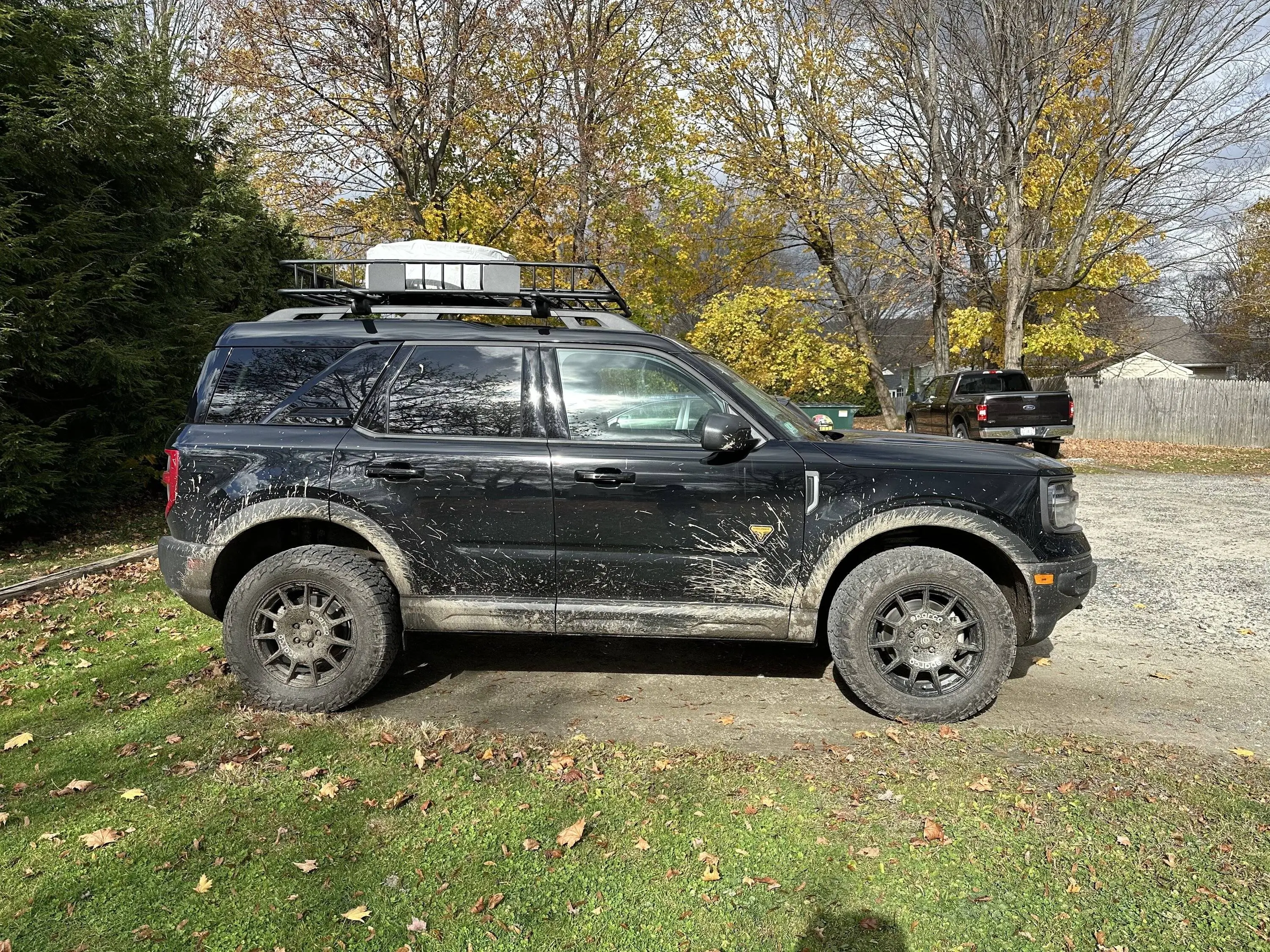

235/70/17 Goodyear wrangler , they will cut the snow better than 245

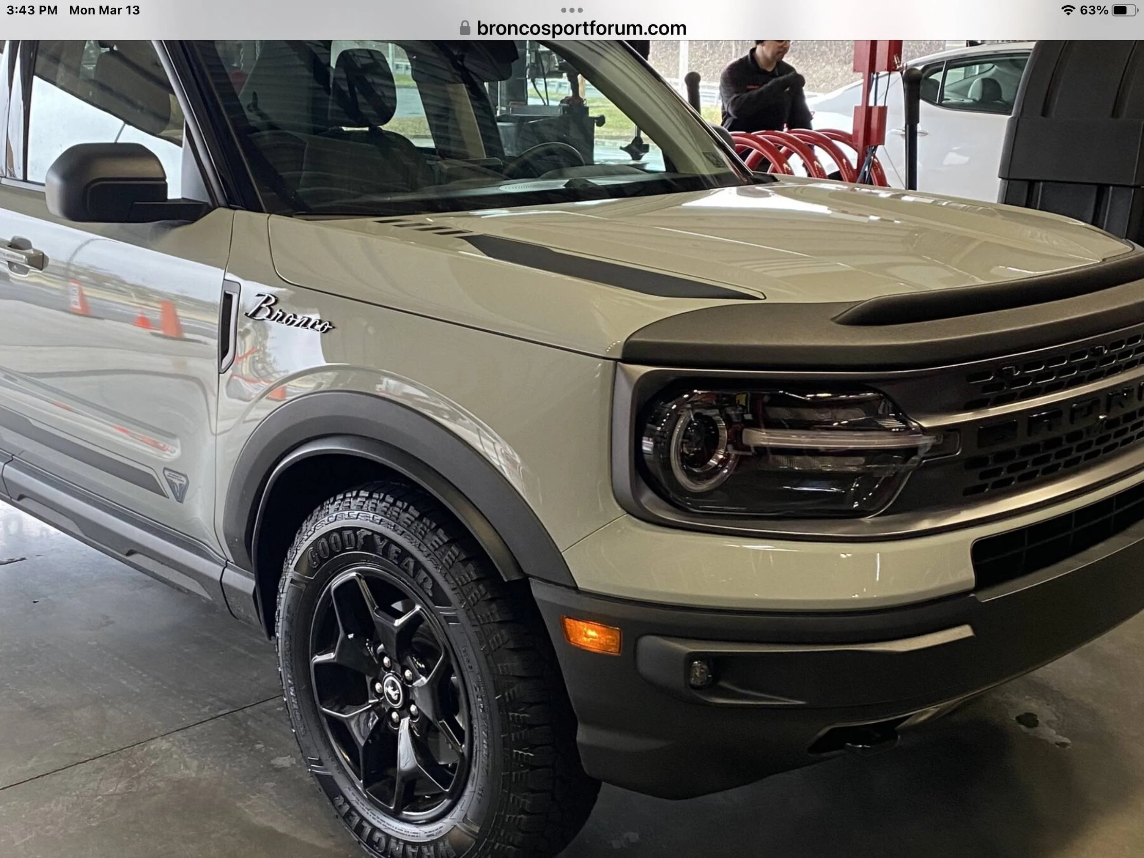

wildpeaks 245/65/17. They’ll get you out there and get you home.
The tires sizes are small enough that no matter which width you choose you won’t see any real difference in the snow.
I’ve run the KO2 and I’ll never run them again. Had them in 35s and they wore weird, got loud, didn’t balance the best and don’t clear out that well in mud and snow. I ran them one winter and switched them out. The tread is hard and when really cold they don’t grip the best initially. Cold rainy slushy they suck.
They’re heavy tires. Lots of people swear by these things, but no one I wheeled Jeeps with runs them or would ever again.
I ran wildpeaks on my truck and wheeled that. The tires are durable, quiet, and they balanced great. Even with bigger tires.
The Duratrac is a good tire. They’re soft compound so they ride pretty quiet. They balance easy and are decent in mud and snow. The tread blocks chip easier than the other two and they have a really thin sidewall. They don’t clear thick mud the best. But don’t think the BS is going through 2 foot deep mud pits. Get good mileage out them too.
I’m biased, but I’ve had good luck with wildpeaks on my last two rides.
Cooper stt pro would be my pick if they were available in small sizes. Hands down, best tire I’ve ever run. But were 35s and 37s.
