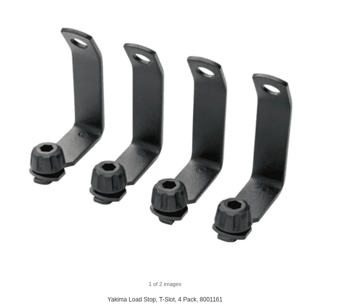

eTrailer states "You can use the Load Stops for Yakima HD Bar, JetStream, FlushBar, and RailBar Crossbars - Qty 4 Item # Y01161, which will also fit in the T-channels of Thule Wing Bar Evo crossbars." But they are out of stock now.
I have the wingbar and it doesn't work, it is for the aero... It may work on some of the others, but the fixed t bar on the load stop is what causes issues with certain setups. I haven't actually checked to see if it works on the Yakima LnL platform.

These are the Yakima stops I am talking about.
Ford Bronco Sport Thule load stop for Wingbar Evo? Yakima Load Stops
