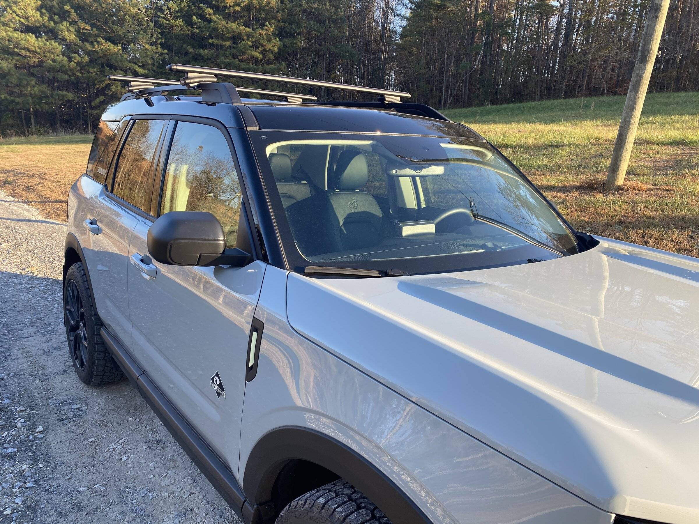

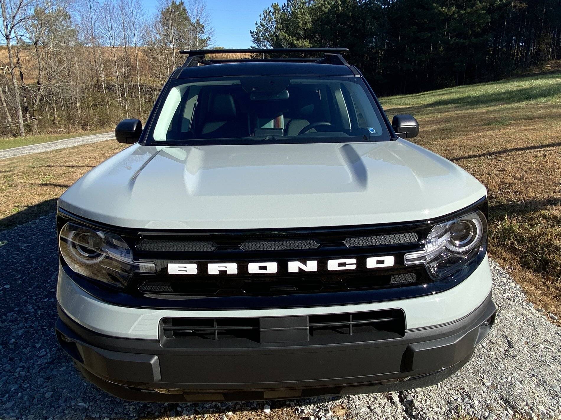

Just installed Thule Evo crossbars on my OB. Bronco Baja blanket’s peeking out from the backseat, too.

Just an FYI...the Thule bars are on backwards. It does seem to look like its right, but the fatter side is supposed to be the leading edge. This will reduce any noise you have experienced so far. Great choice thou!

??‍♂This is my very first vehicle that wasn’t a Ranger or F-150, so I’m a total newb cross bar installation(roof racks/rails in general!). I definitely appreciate you looking out for me, tho. ✌?

I think I had the Thule logos on the passenger as the correct orientation in my mind & completely disregarded that whole step in the instructions but I kinda like it better anyway from a strictly aesthetic aspect-at least until I figure out exactly what I wanna do with the roof & can afford all my camping & trail mod ideas. The whistle is pretty minimal, actually, & not really an issue when bangin it out w/that B&O system.????

It's a common mistake since it totally looks right... But having this forum to help and learn from each other makes it so much better.
If you have a whistle not just wind noise that is caused by a gap most likely under the bar around the towers. There is a sliding plastic measuring piece and the other you should have cut to place. Sometimes during install the towers push the sliding measurement stick a little, closing that gap could solve the whistle at least.

Oh, & I already cut the rubber strips & stuck them underneath & that did make a big difference-almost unnoticeable now but I think I have a constant ringing going on in my ears anyway!

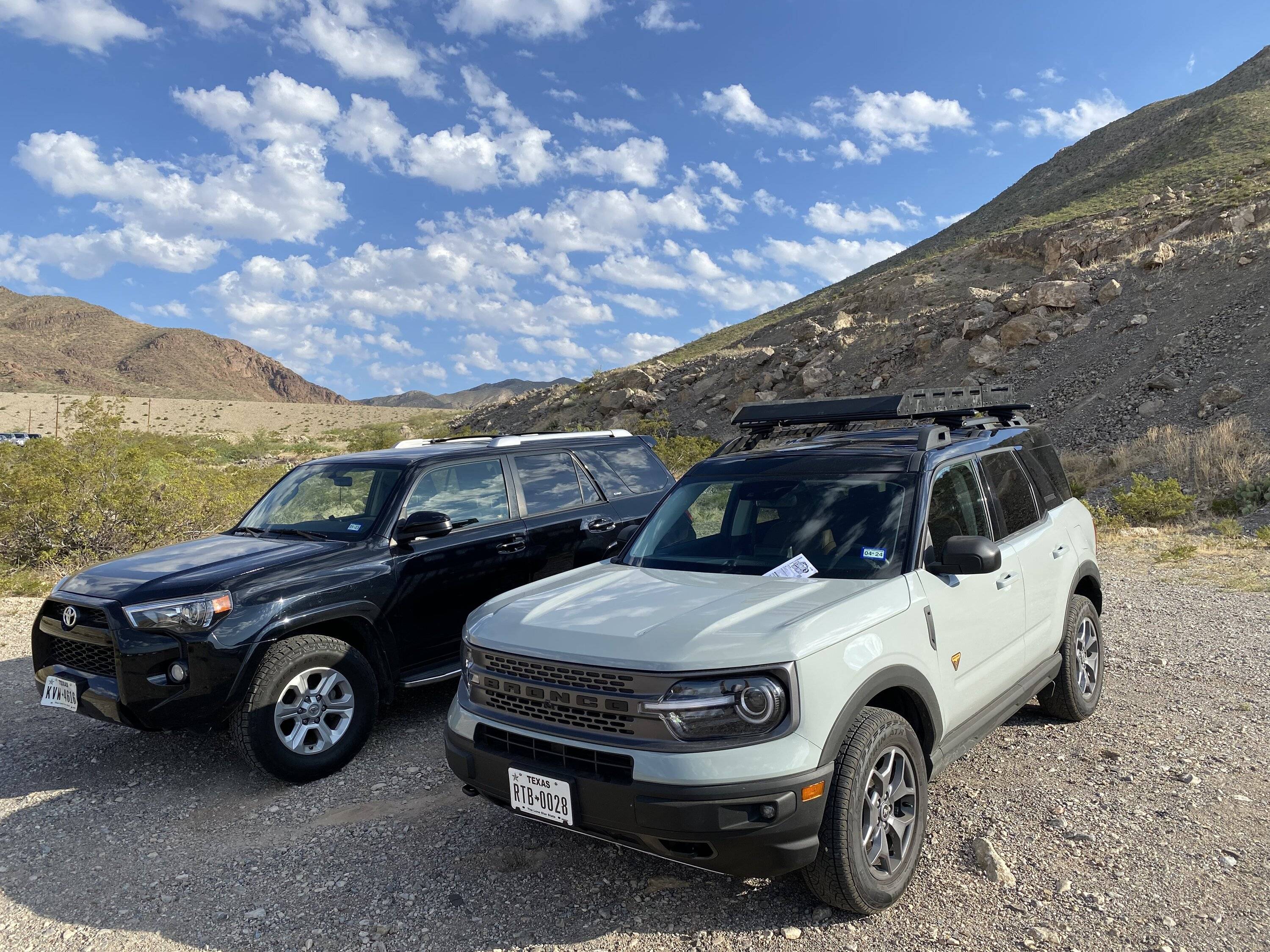

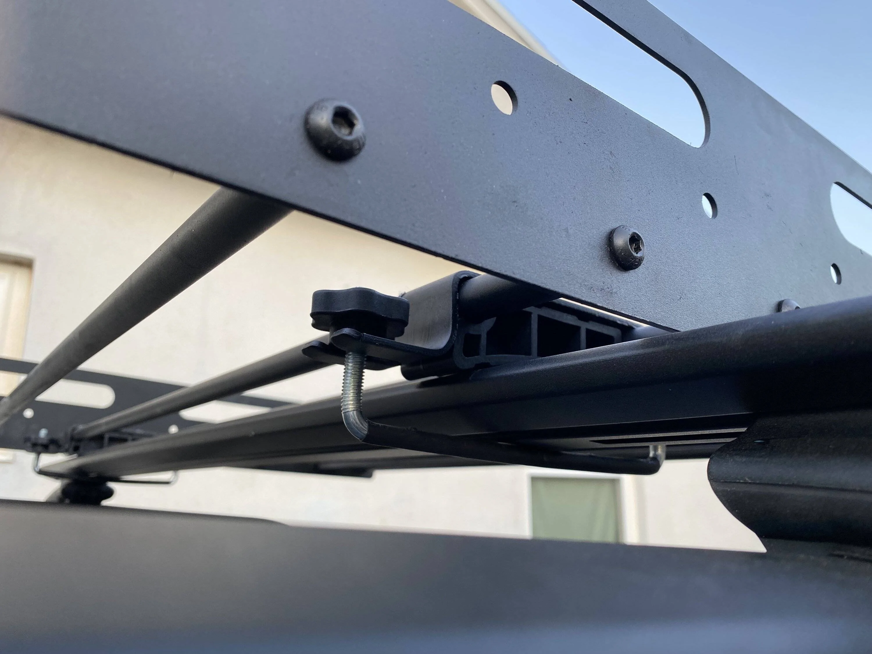

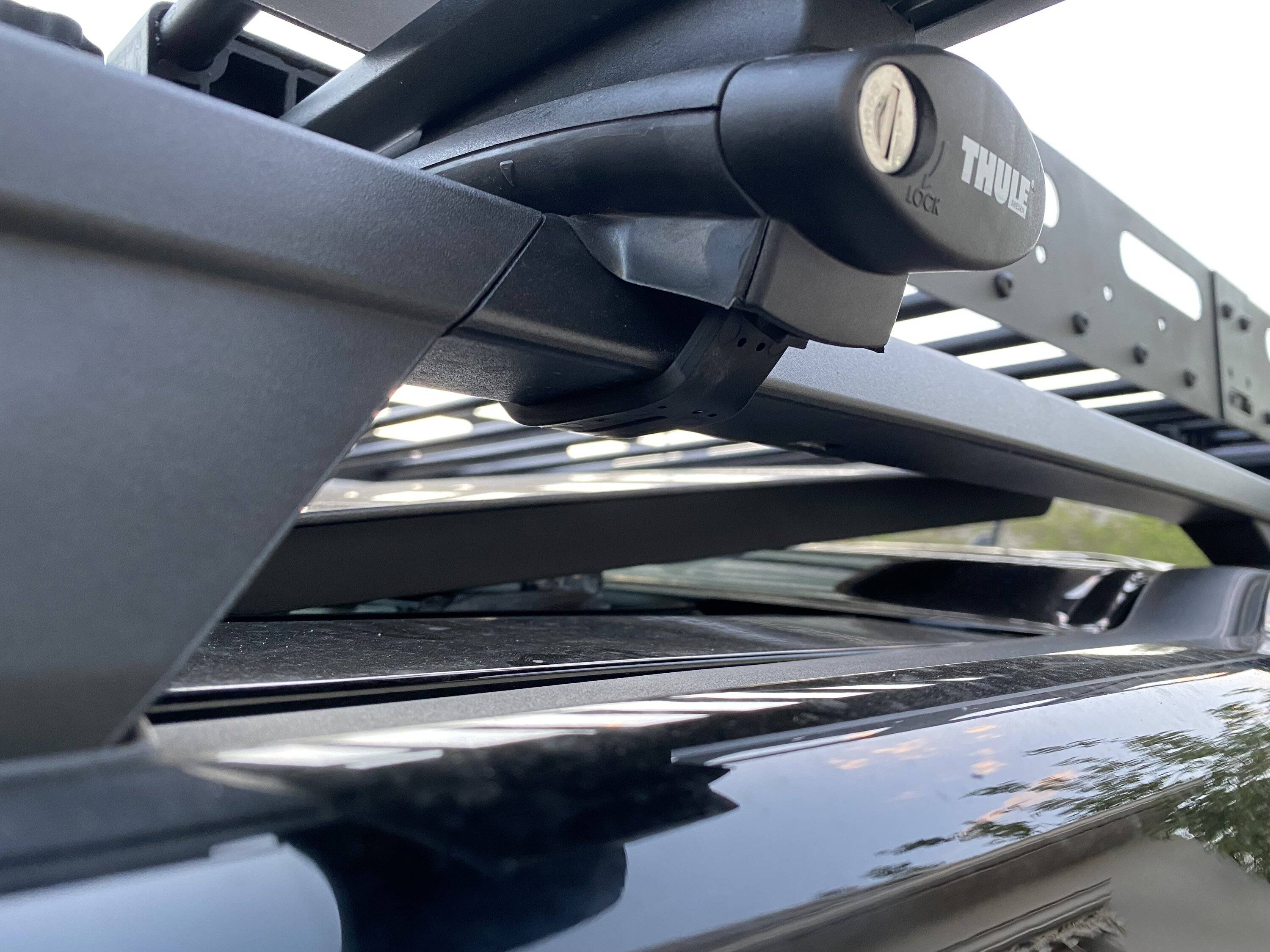

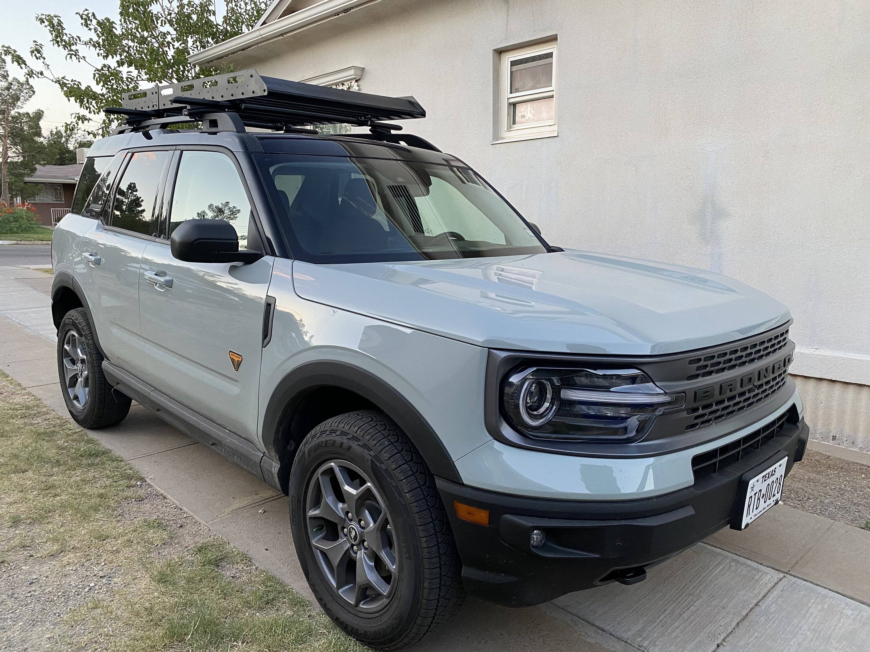

Great bars... I also bought those crossbars and the Thule 450R legs... Cost more than other options on Amazon, but felt more secure after I tried a generic brand of crossbars. However the rack onto is... an Amazon generic I paid $200 for... Happy with it so far.
