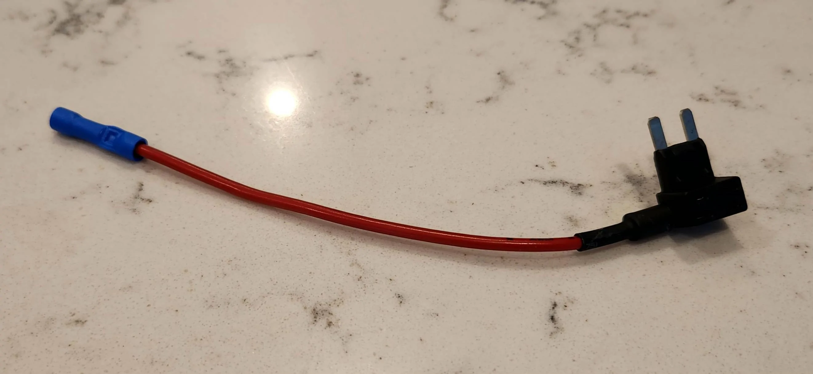

I want to wire up my fog lights that are rated 10 Amps. I plan to use an Add-A-Circuit in the interior fuse box. The 15/16 slot is rated at 15 amps (listed as unused in the manual). Can I use the original 15 Amp fuse for that slot and put a 10 Amp fuse that feeds that new wire?
Yes. You can (should) put the original 15A fuse in the Add-a-Circuit. You can put a 10A, in-line fuse in the new circuit.
