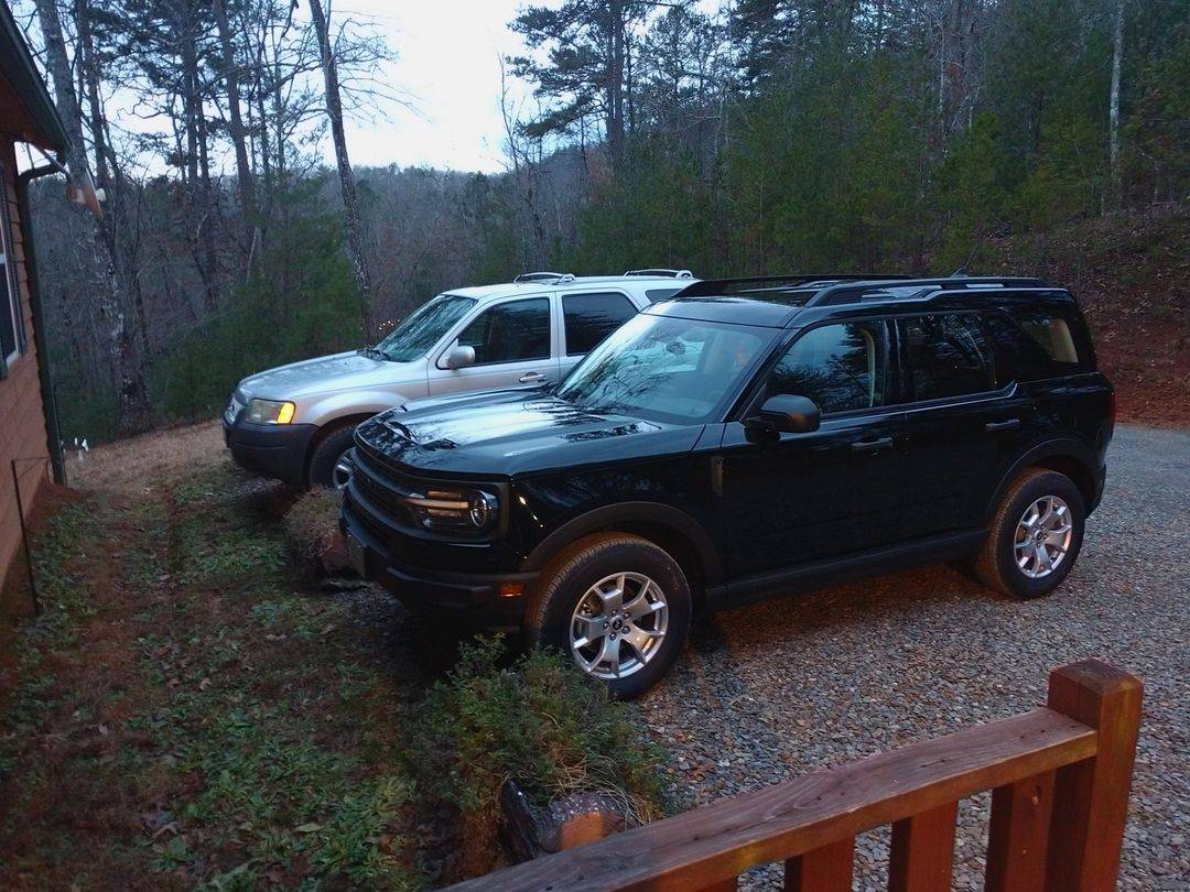

Tire pressure makes a big difference in my Base model with my 17" Continentals.
My Tires are 'All Season's' with low unbroken treads of only 10/32" tread depth and that makes for a more rigid tire tread that transmits more road Imperfections into the suspension.
On my 2004 Escape My Yokohama's have deep blocky treads, 13 or 14/32" and I feel almost no road surface Imperfections.

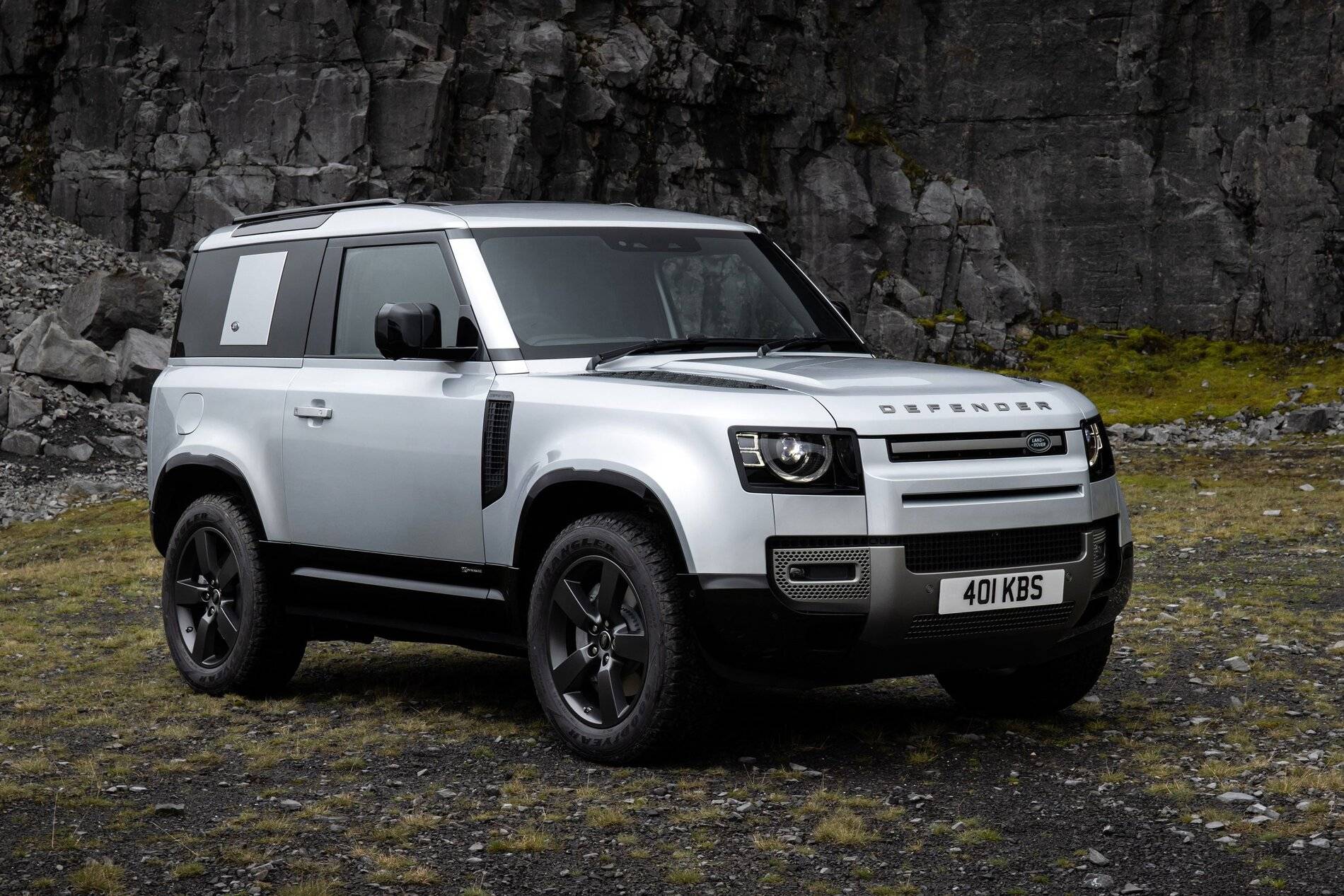

I don't compare my Baby Bronc to a car or an Urban SUV like the Escape Nor the Current Off Road champion like the Jeep or any of the Oriental vehicles.
I compare mine to the Land Rover Defender that comes in at $46,100 for the base model to the 90 at $83,000, that gets 18 city and 21 hwy mpg's.
In your Face Land Rover :p
