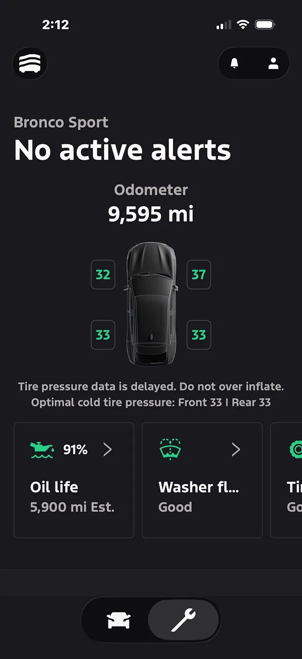

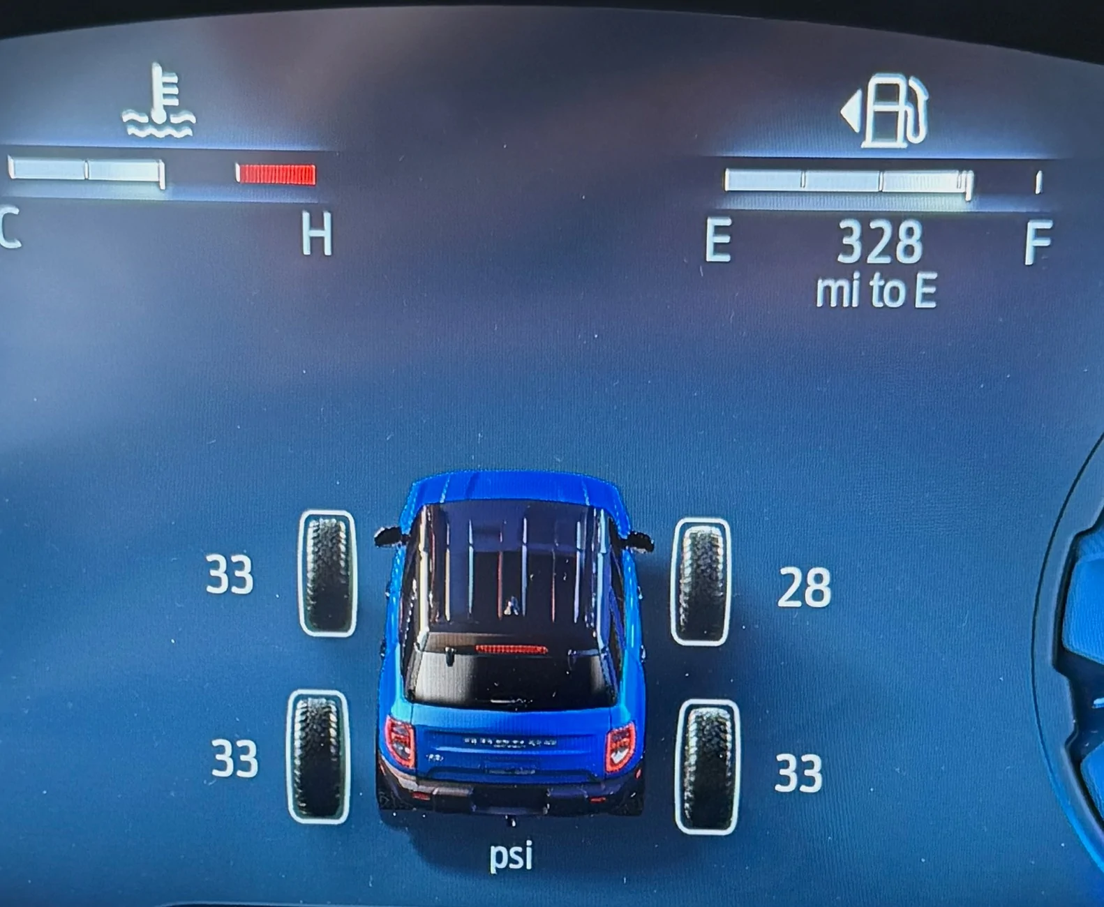

Received a RF leak detected message when the pressure was reading 28 PSI. I checked the tires visually, by touch, and with a magnet and did not find a nail/screw.
Ford Bronco Sport Suspected Bad TPMS Sensor IMG_3739

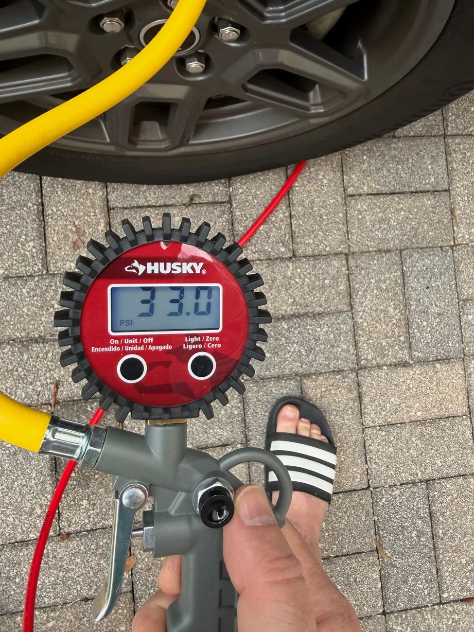

I don't have a digital pressure gauge yet (plan to get one that attaches to my pancake comprerssor tomorrow), so I used the readout on the cluster to fill all the tires to exactly 33 PSI, which I confirmed after driving the vehicle a short distance. Now the RF is reading 37 PSI. It seems to be intermittent. When I drive the vehicle the pressure is all over the place.
Ford Bronco Sport Suspected Bad TPMS Sensor IMG_3738

Before I picked up the tire inflater, the false low reading on the cluster caused me to over inflate the tire to 38 psi.
Confirmed bad. What other evidence does the dealer need?

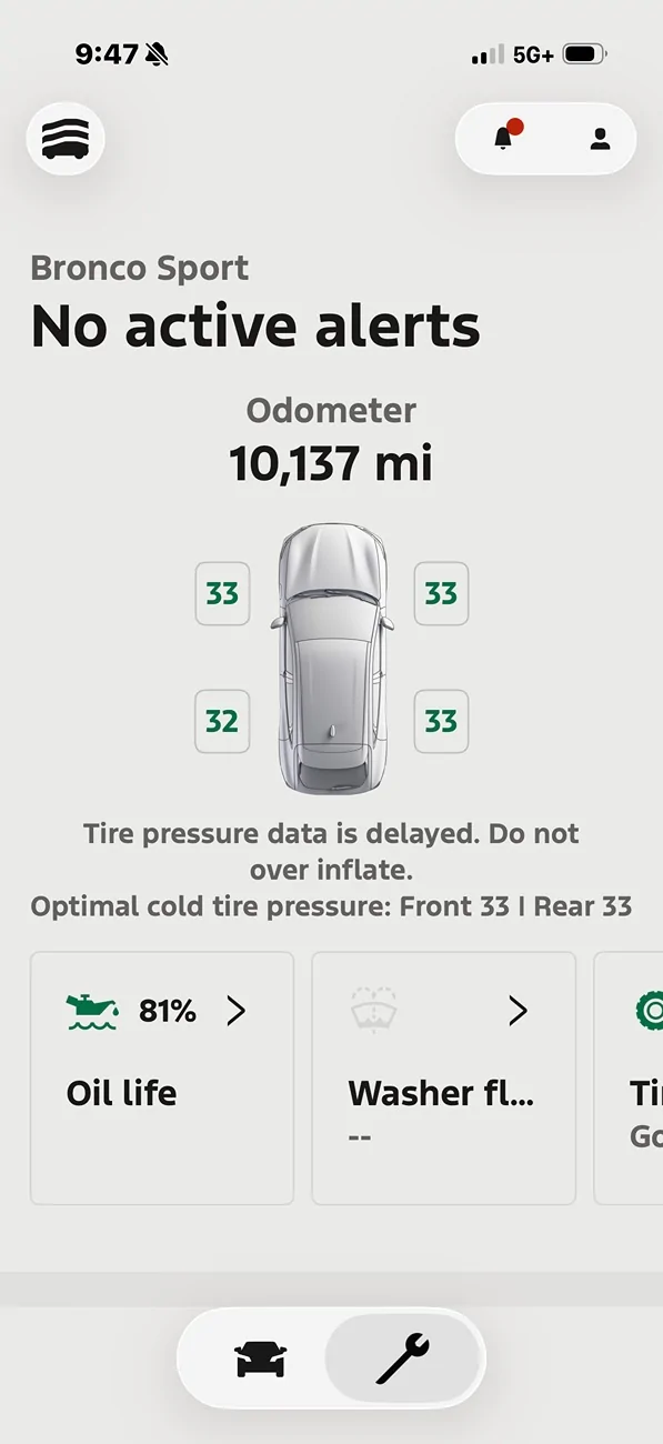

Took my 2025 BSBB for its 10K service. I showed them the pictures of the bad TPMS sensor reading vs the tire gauge. The service rep indicated they will perform a recalibration. My response was the sensor is reading all over the place, not just a static offset and I would like the sensor replaced under warranty.
They initially said they can't replace it under warranty because there were no codes and no flashing lights on the dash. They monkeyed around with it for 30 minutes, came back saying they were going to try some sort of module factory reset. They monkeyed around with it for another 40 minutes and said their tools were giving them trouble and were going to replace the sensor no charge.
Would have saved both of us time and their labor if they had simply listened to me in the first place.
