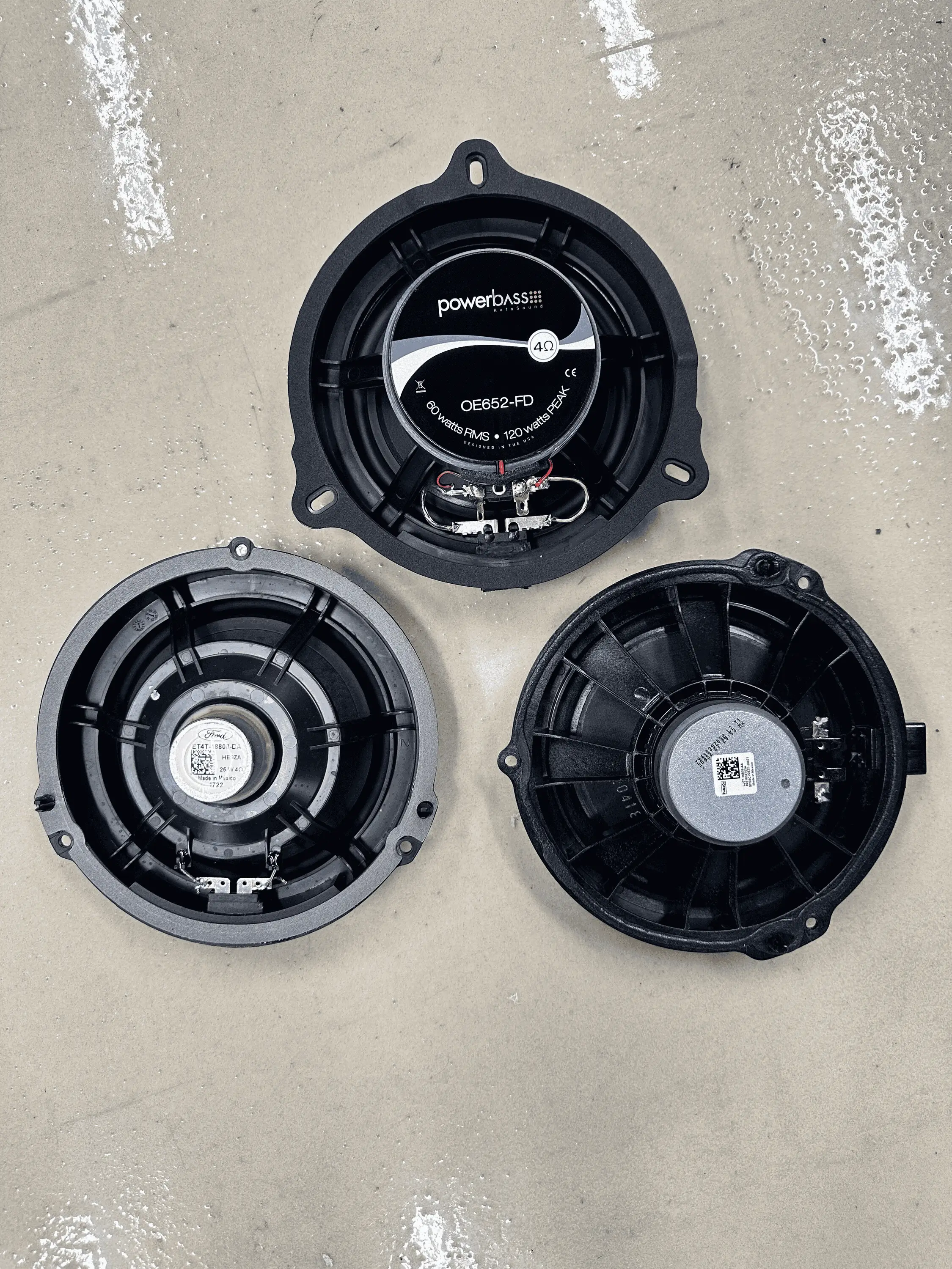

From what I have seen, the speakers in a BS with the B&O system are no different than those without the B&O. Here is a comparison photo I took of the stock speakers (bottom left & right) versus the PowerBass.
Ford Bronco Sport Stereo upgrades 1685535788293
You can see the difference in magnet sizing. Just look at how small the magnet in the back speaker is (bottom left). The front is only marginally better. What you can't see is how much better the cone is and the surround. I think just about any aftermarket solution would be a major upgrade from the garbage Ford supplies.
non B&O gets speakers like on the bottom left for all doors. B&O systems get speakers with larger magnets.

But apparently the larger magnet speakers in the B&O systems are only in the front doors.

Actually that's not true. The B&O speakers do have larger magnets and are of a different impedance.

That being said the B&O speakers are better than the regular speakers. Maybe by not the margin you are hoping for and there definitely is more amplification.

I think the point is acceptability. I like music, especially well-recorded, well-produced music. I don't need audiophile quality to appreciate it, but it does need to be acceptable. I'm in the camp that OEM speakers are so bad that I'd rather not listen to music with them at all. Replacing the OEM speakers with a modest upgrade such as the Powerbass option brings the listening experience into the range of acceptability.

As covered earlier, the front door speakers are "upgraded" in the B&O system but they are still essentially paperweights. The B&O does have more speakers and you are correct that the amplification is also more and probably better quality. In the end, I'm left questioning the $1k (or whatever it was) cost of the B&O and thinking that just going to aftermarket from the beginning might have been the better option.
