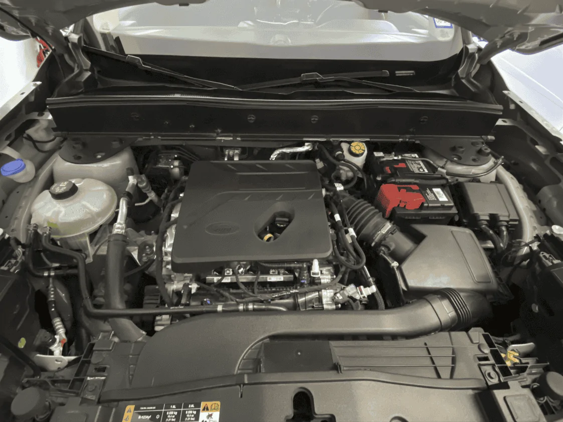

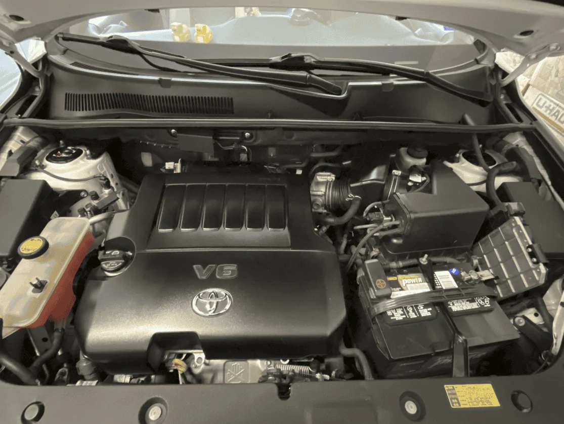

I was cleaning both our vehicles today and saw that my rav4 engine bay is full and my BB has a ton more space inside.
(I took pics of both of them)
Anyone else think that the BS can fit a bigger 2.5 to 3.0L engine? There's plenty of room and engineers can make a new innovation for sure to make it powerful yet economical :)
Let's take out the turbo and just put a 3.0L NA engine in there and zoom the roads with the cruising songs we like.
Thoughts??

The 2.0 in engines run pretty good, if you mash the gas and the wheels aren't pointing straight you can get into trouble quickly, the 2.0 has some torque steer. I don't really think it needs more power, but a tune could be interesting.
Thoughts?
Ford used its Duratec 3.0L V6 in the 2001 and later Escape. That engine produced around 200 hp and returned around 20 mpg on the highway. Toyota's latest iteration of it's venerable 3.5L V6--arguably the best mass-produced normally aspirated V6 in the world--was used in the last-generation Tacoma. It produced 278 horsepower @ 6000 rpm, and 265 lb-ft torque @ 4600 rpm. Compare that to the 2.0L EcoBoost's 245 hp @ 6000 rpm, and 277 lb-ft torque at 3000 rpm. Although the Toyota engine produces more horsepower, the EcoBoost makes more torque. What's more, the EcoBoost produces it's maximum torque more than 1500 rpm earlier. Low-rpm torque makes a car much more "drivable" in normal, every-day circumstances--you don't have to wait for the engine to rev up to get useable acceleration.
This improvement in drivability without a significant loss of horsepower is one of the primary reasons the overwhelming majority of auto manufacturers have moved toward small-displacement turbocharged engines. They're far lighter, and offer similar power than their normally aspirated brethren. And because they are significantly more fuel efficient at low-power demand, they provide owners with flexibility--with the EcoBoost you get "Eco" or "Boost" as the situation demands.
All-in-all, the 2.0L EcoBoost is a great fit for this vehicle. I think a normally aspirated V6 would be a step backward.
