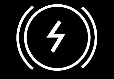

Ok, I went in and out of maintenance mode three times on my car using the procedure I posted. I did not need the additional step you posted to exit maintenance mode, but there were a couple of differences from the last time I tried the procedure:
  • When the system enters parking brake maintenance mode in addition to the notification I now see an amber colored brake symbol in the upper right-hand corner (see below).
  • I no longer see a notification the brake mode is "Normal" when exiting maintenance mode, but the brake symbol in the upper right-hand corner goes out.

Interesting- I'll have to go see what mine does. There are so many notifications that flash by that it's hard to keep track. FYI here's the web site where I happened across the modification to the instructions:
