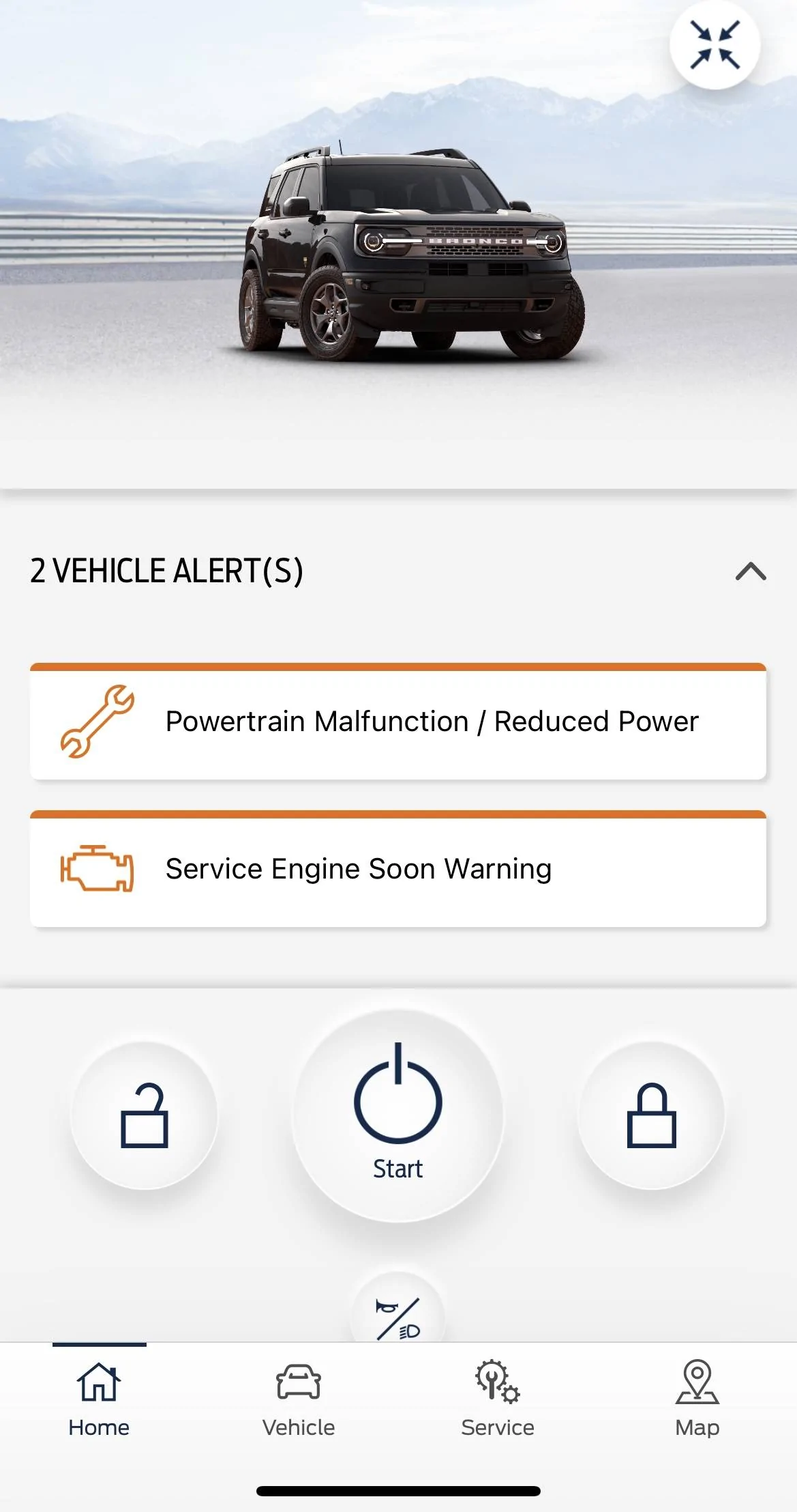

Yeah it shows in the app
Ford Bronco Sport Service Engine...already. 9D184681-5571-4EA5-ACCD-19C861ECC785
It’s hesitant over 2k rpm and is shifting clunky. Even idle is off. Found the code.
Code:
P25B4
Definition:
Turbocharger/Supercharger Wastegate A Stuck Closed-looks like turbo might be bad, feels like turbo is bad to me. I can’t win with this thing
Code:
P25B4
Definition:
Crap, doesn’t sound like as easy of a fix as mine was but crossing fingers that it is ?? I know, it’s very disappointing to have brand new vehicles and have problems this early on.

Was told bad wastegate and are going to replace. Few days out though. Still doesn’t explain the loud bang when it shifted
