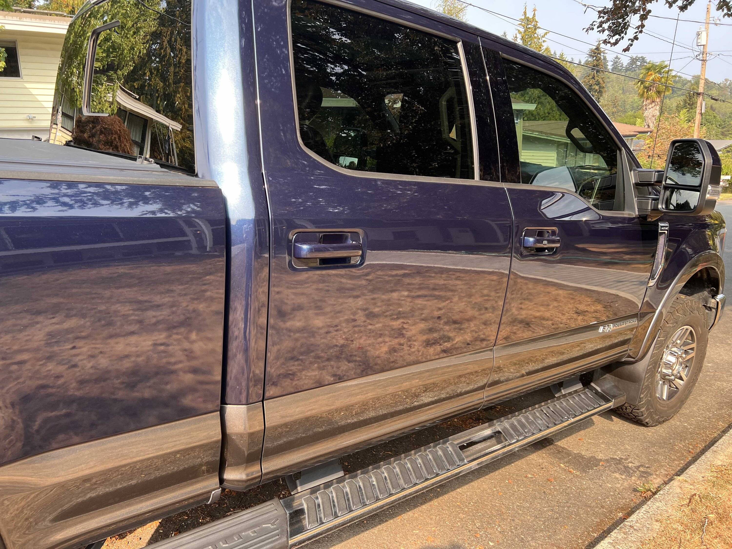

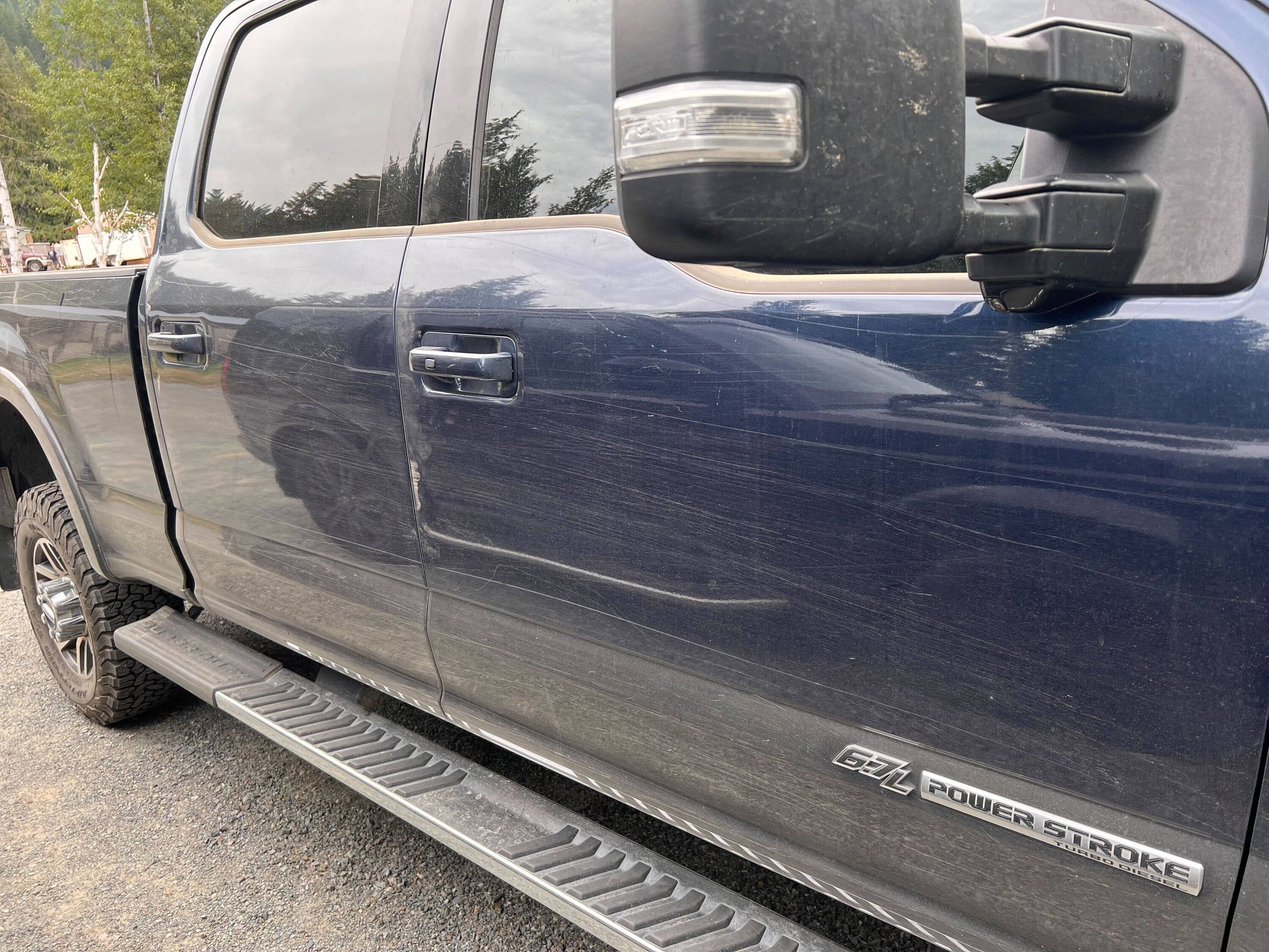

Okay, did this looking for a fabled fly fishing hole up at our lake place in Idaho (pic 1) Fortunately, nothing broke through the paint layer but is looked like hell. Used the stuff listed above in post 3 and this is how it came out. (pic 2 and 3).
I think most people are afraid to start working on the paint on their expensive vehicle. if you take it slow and slowly work up the speed if needed, you'll be just fine. Now, i have friends "stop by" on a regular basis asking to take a scratch out or their kid backed into the garbage can, etc.
