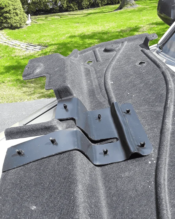

Just wrapping up the passenger side nerfs
Same supplier and manufacturer
3" Ionic
Brackets no issues
This is the modification I felt was needed for the rear felt splash guard
Rear bracket intersects liner
Cut was in formed section which makes liner rigid
Needed to strengthen cut area
Kydex
Heat gun
Push pins
Bracket mount spiral bolts
Spiral bolts driver side no prob
Spiral bolts passenger side....strong language recommended
3" Ionic
Brackets no issues
Kydex
Heat gun
Push pins
I had my install planned for today, but it rained. Thanks for the info. I guess I should order some Kydex before I get started. Did you jack up the Bronco for the installation?

Kydex is a farvorite around here for non-metallic fabrications
Molds to any desired shape
Fairly rigid, depending on the thickness of the material
Managed to squeeze underneath without ramps
Once the brackets are on loose fit confirm bar holes line up then snug
Those spiral bolts
Drivers side went in slick
Passenger side however for whatever reason required demonic cursing

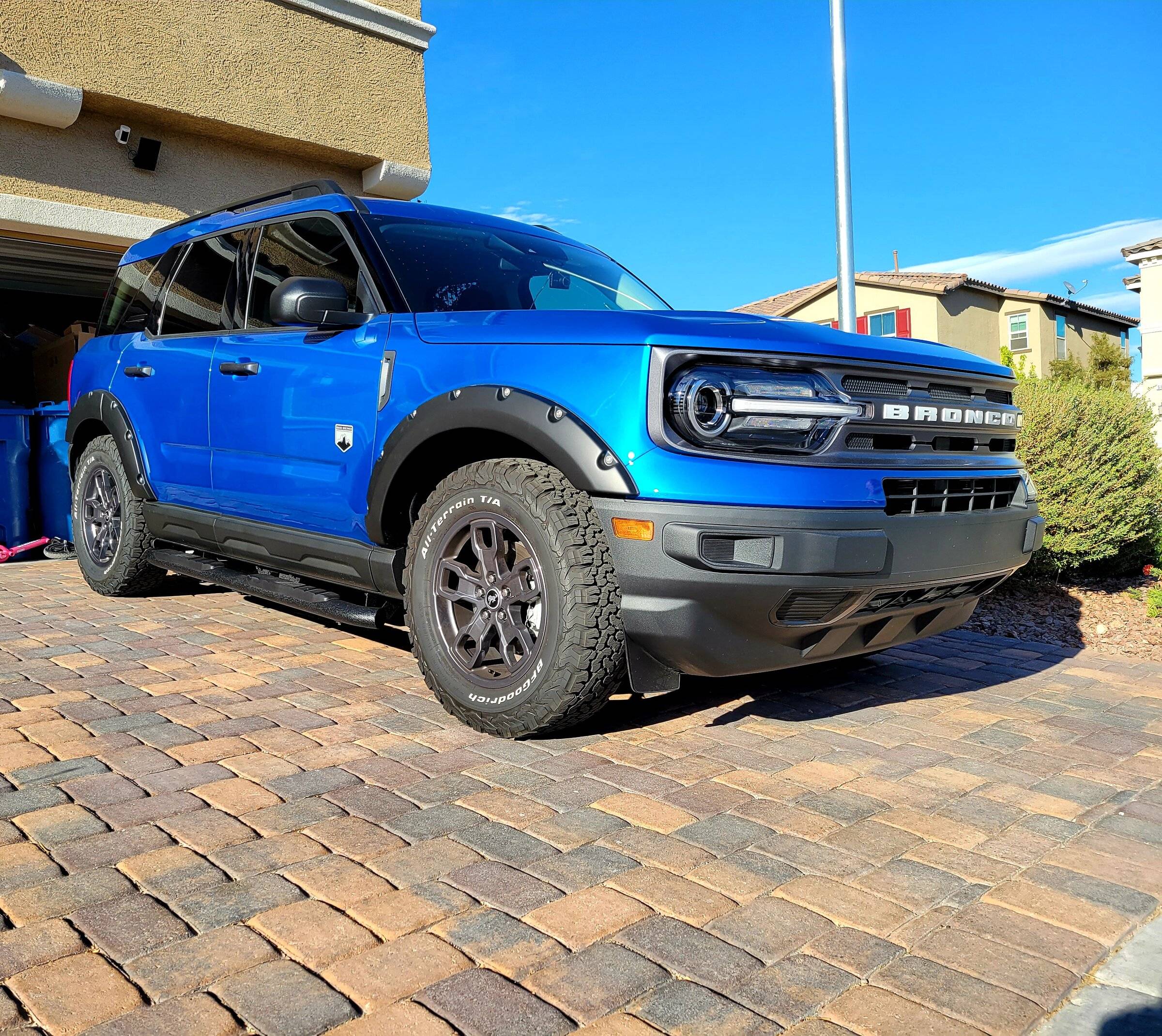

Off topic, not normally a fan of white letters on the tires, but with the bright blue and the fender flares...looks awesome
If you get the BFG's you gotta put those whites out
