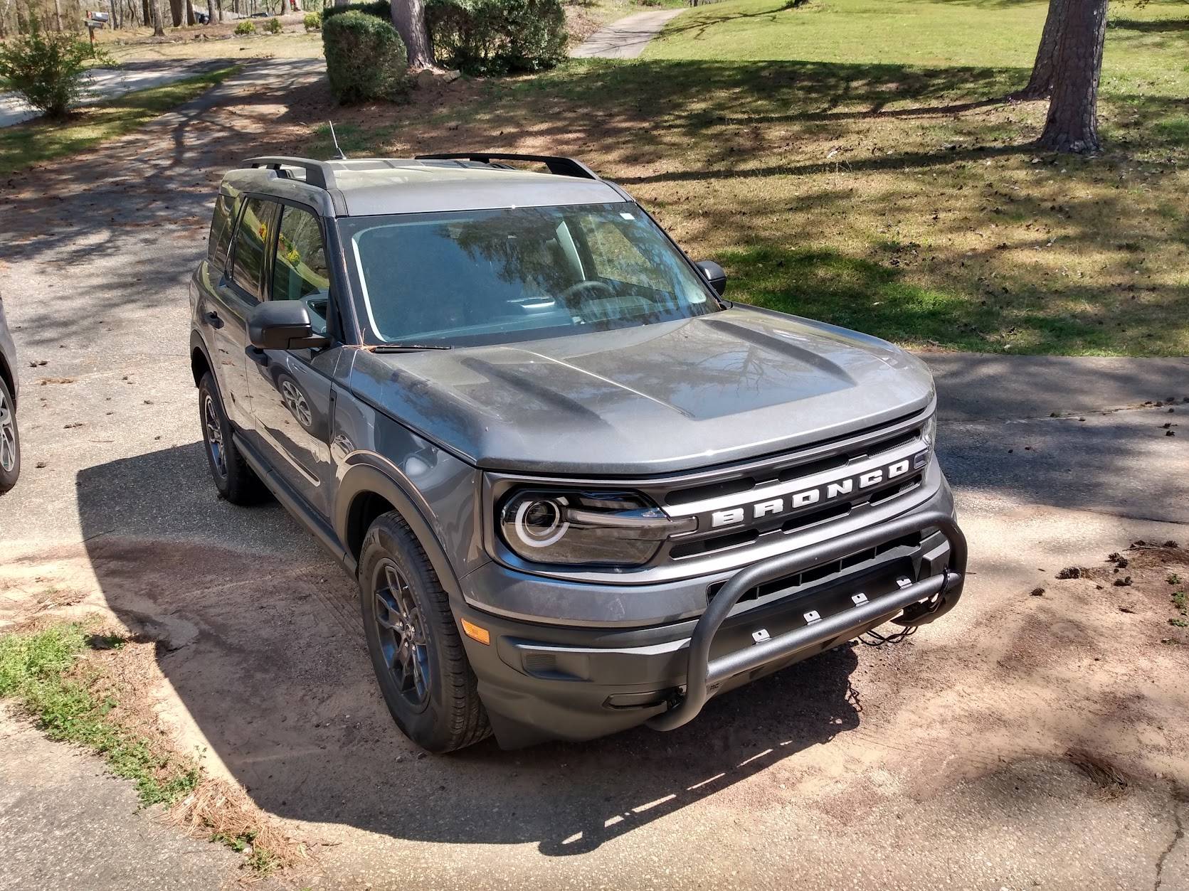

I made up some shims to fit behind the brackets to clear the lip. The measurement between the two mounting points for the bull bar is now exactly 36". The bumper should fit back on. I'll give it a shot when I have two extra bodies to assist later so that we don't scratch the paint.

If anyone else experiences this issue, I'm guessing that Rough Country will have corrected the problem with their brackets. If you do experience this problem, place enough spacers ahead of the Bronco bumper to make the bracket clear the lip. Flat washers will do fine if you don't have a bunch of scrap metal like I do. This would have been an easy fix if Rough Country or I had noticed the lip in the first place. It's really easy to miss unless you can get beneath the vehicle.
I would not recommend this kit for the inexperienced or the faint of heart if you plan to install it yourself. You have to be extremely careful to avoid scratching paint and generally f'ing up various clips, plastics, trim and other assorted stuff and you'll have to cut two slices in your bumper. I will say that the materials are solid, and the coating is well done. I'm happy with the look and it'll match well with the other stuff that I'm putting on the Bronco.
