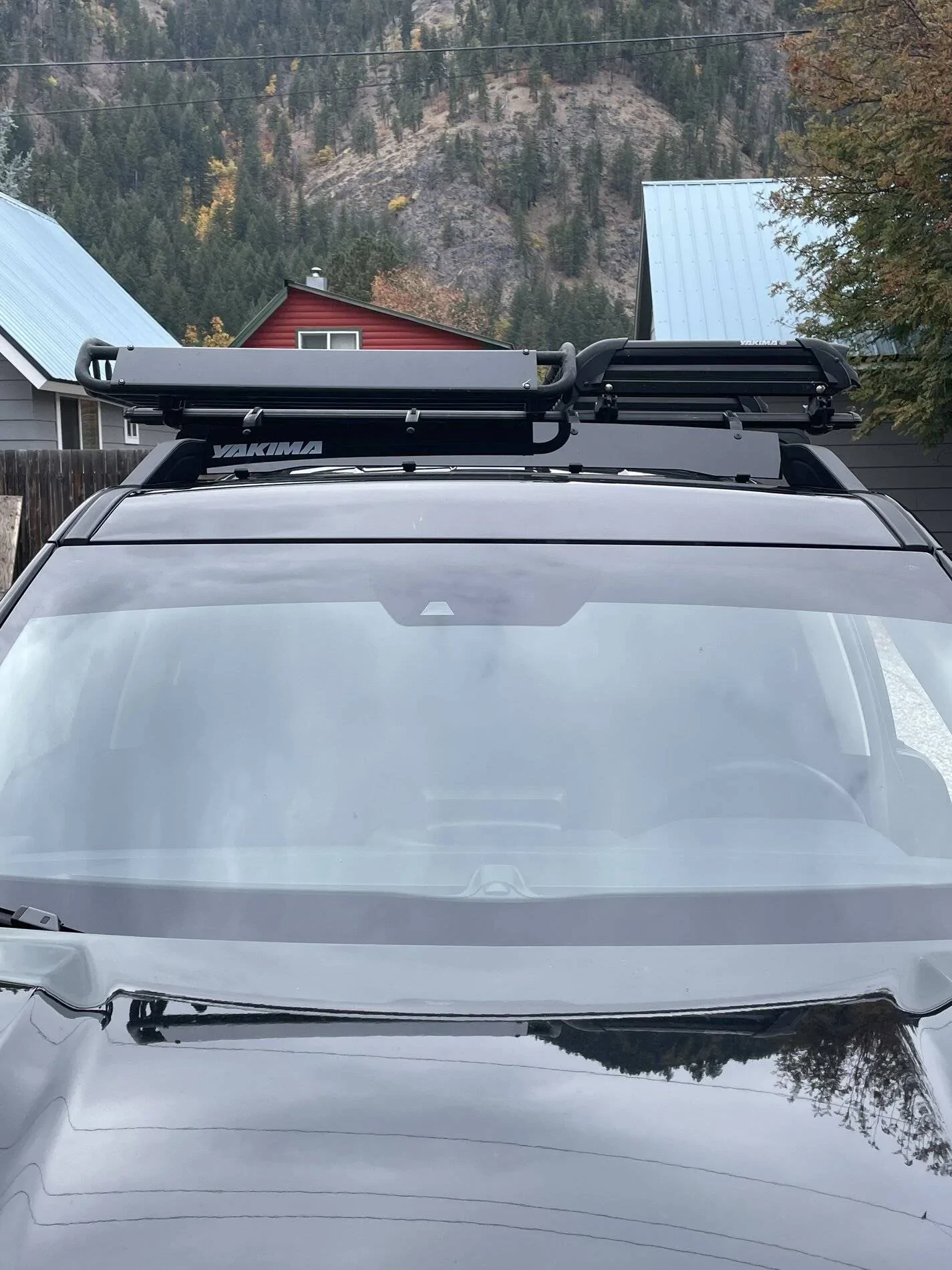

Just added a Yakima fairing to my rack set up. Bout a 46” as the 40” are sold out until February or March. Had to trim like 1.5” off each side but was super easy and fits better then the 40” would have by covering that extra 3” of space.

Just took it out for a test ride and seemed like it did help with noise at under 60mph. Seemed about the same above 60mph but didn’t drive that long in the 60mph area. It seemed to help the mpg a little in the 15mile drive…so we’ll see how if changes things after a week of commuting.
