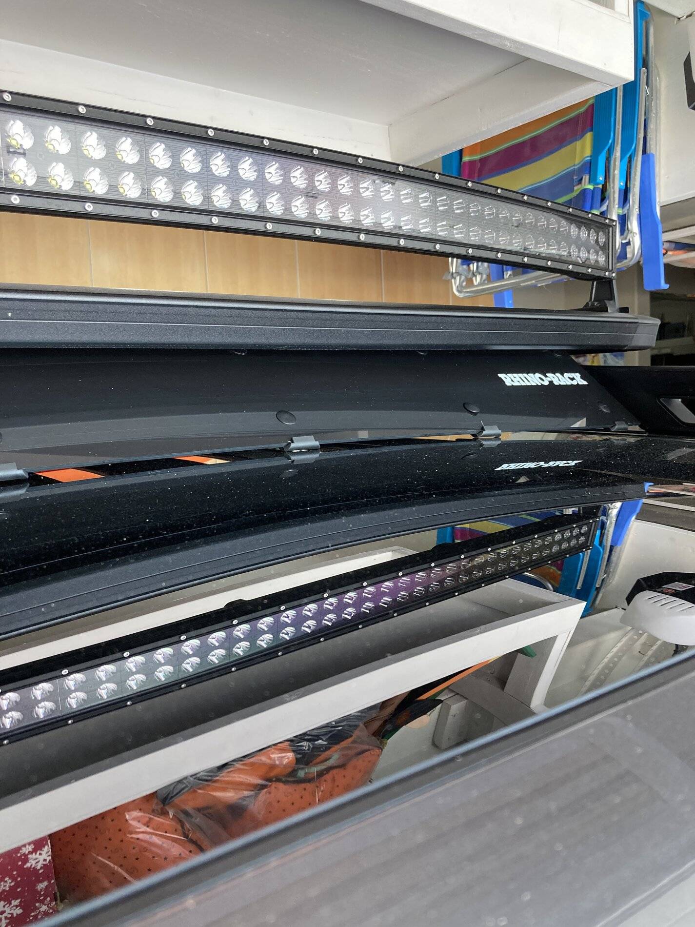

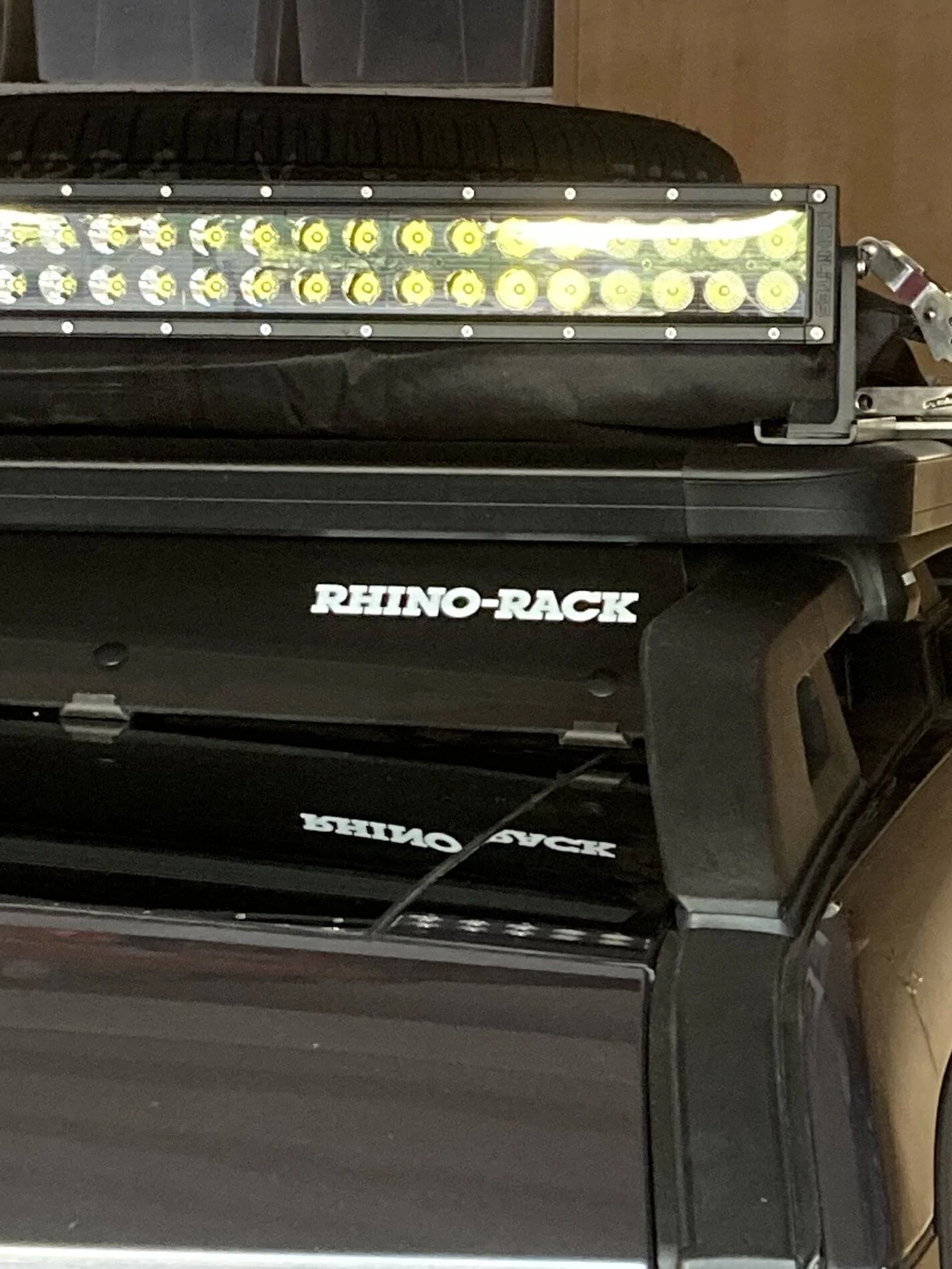

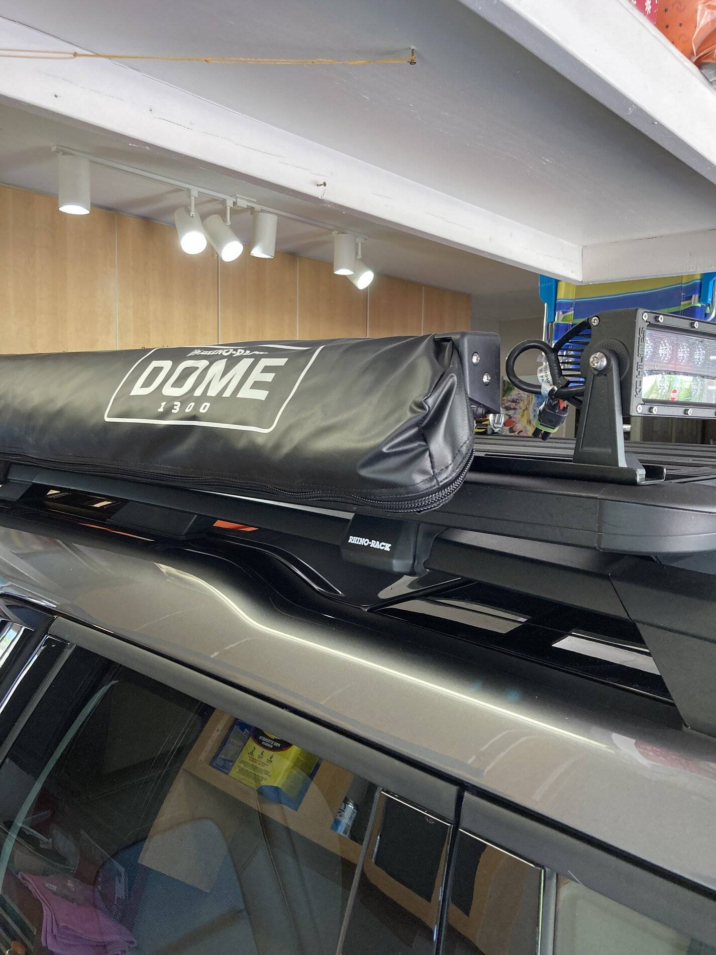

Since I haven’t seen too many mentions of Rhino Rack platforms on here I thought I’d post what I installed over the weekend. I wanted a lower profile platform rack that was still aluminum and light weight. Rhino rack has an option on their website for the BS but it runs the length of the roof and would cover the sunroof on my Badlands. After a lot of close measurements I figured I could mount the 52x49 and still have a full functioning sun roof. It’s close and took a little adjustment but here is the result!

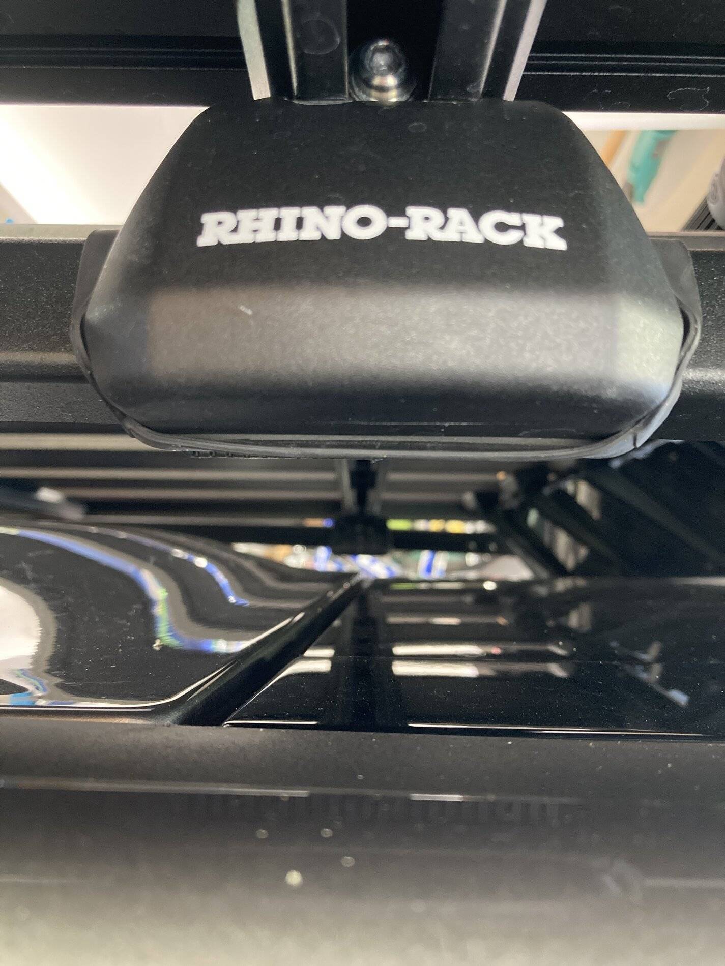

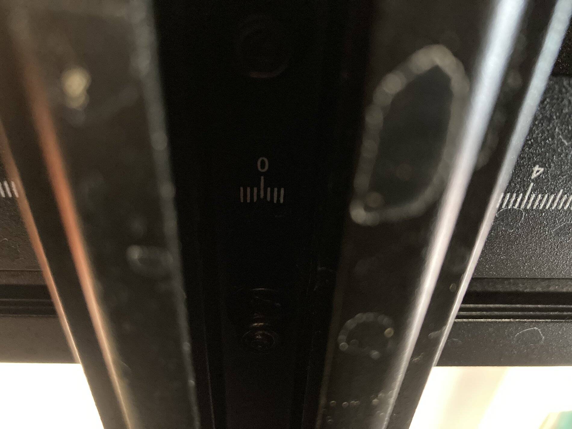

So the adjustments I used to position the 60x49 Pioneer Platform I installed were to space the 3 cross braces as follows:
Front crossbar at 46 cm
Center crossbar at zero cm
Rear crossbar at 46 cm
One of the cool things about the Rhino Rack is they have a “ruler” imprinted right on the underside so super easy to make sure you are aligned correctly.
Once the crossbar spacing is set, I installed the SX feet so that the rear attachment point was at the rear most end of the factory side rail (see photos).
There was plenty of room for the sunroof travel and the leading edge of the rack aligns with the sunroof opening perfectly when fully opened, so you get a full view.
I also reduced the wind noise significantly by installing the wind screen from Rhino Rack.

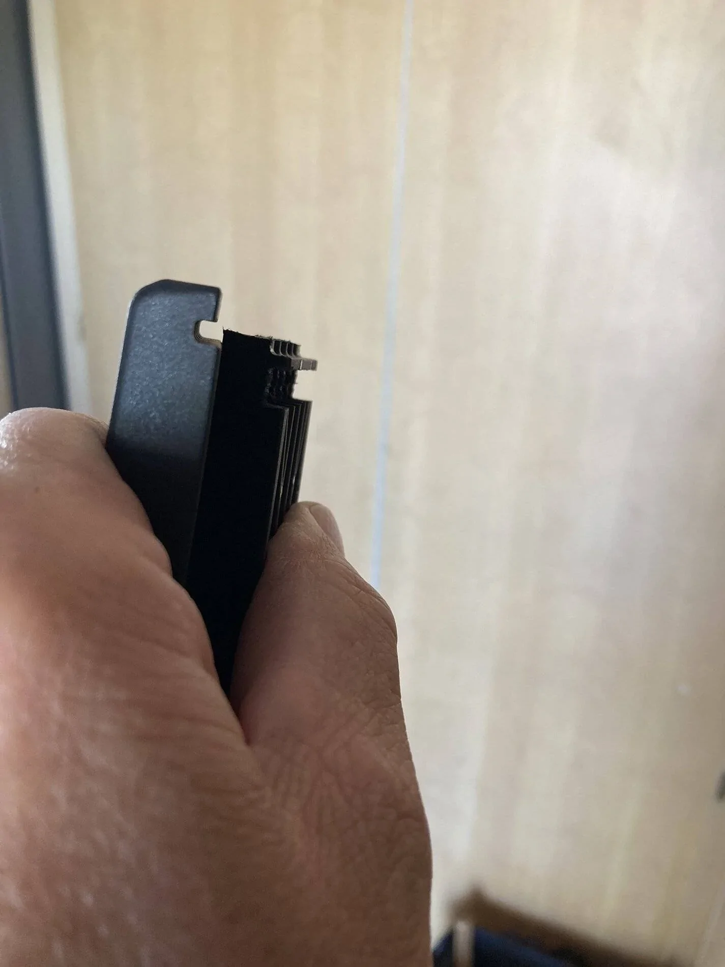

Yes I was able to install the wind screen and feel it did help with the wind noise overall. I ran into an issue with the windscreen kit as provided thought, due to the newer Pioneer Platform design, the spacing for the outer support arms needed a little modification. I did the modification simply by adjusting the spacing on the clamp (see photos). I contacted Rhino Rack USAbdirectly for other options but was told they didn’t have an updated windscreen kit yet.

The plugs for the holes actually came with the kit, so I can’t recall since I just measured and chose the drill size. Really just large enough to get Allen key through, maybe 1/4 inch. Maybe these photos can help.
