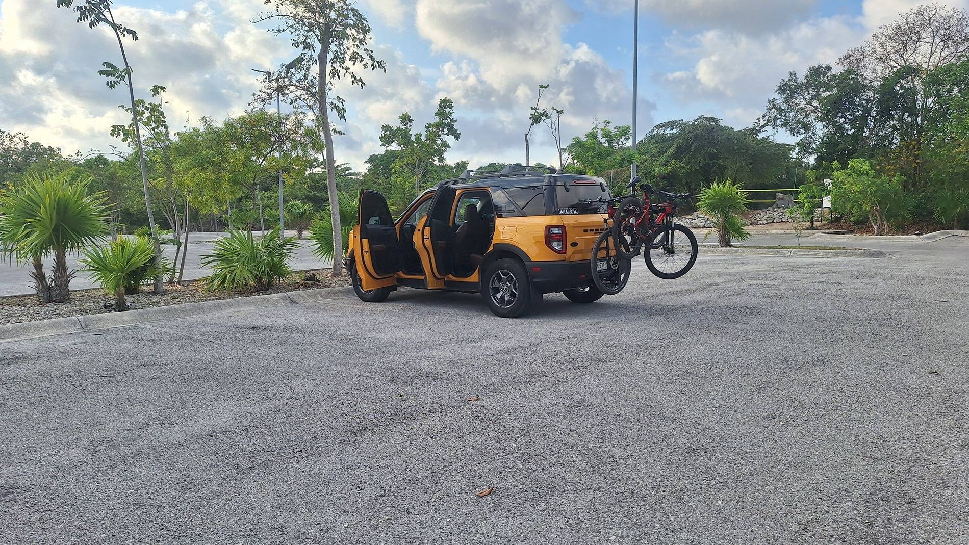

2023 BS BL I don't have the 360 view camera option, I do have the Tow Package, I carry 2 bikes, I never had any trouble backing up, only a long beep telling me there's something back
Nice bikes! Are you thinking you will go Ebike someday?
Some ā€˜21ā€“ā€˜24s models like your Badlands have backup sensors (including rear cross-traffic alert) so that long beep has to be disabled each time the vehicle is started
The 2025s on some or all models have the rear cross-traffic alert and pre-collision assist with automatic emergency braking which is what some 2025 owners are reporting happens with their bike racks

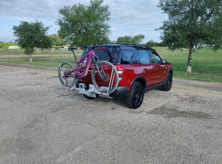

Hi, it's in the "Features" menu. Not in the settings menu. I found it and turAssist. "break assist."
THANK YOU!!!
I was going insane following all of the wrong posts. Scared the crap out of me the first time it slammed the brakes on.
