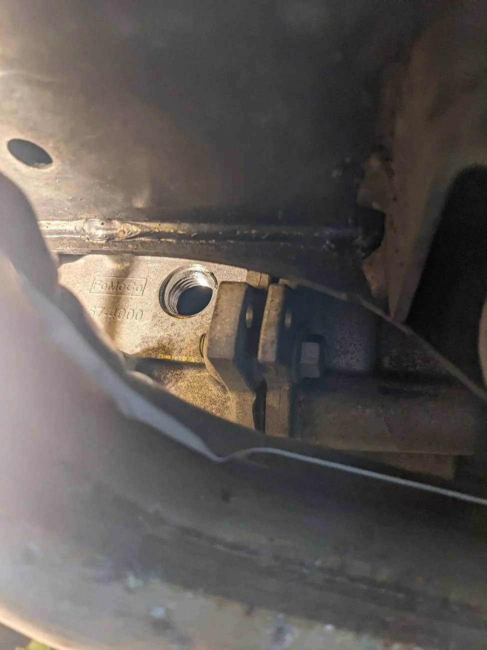

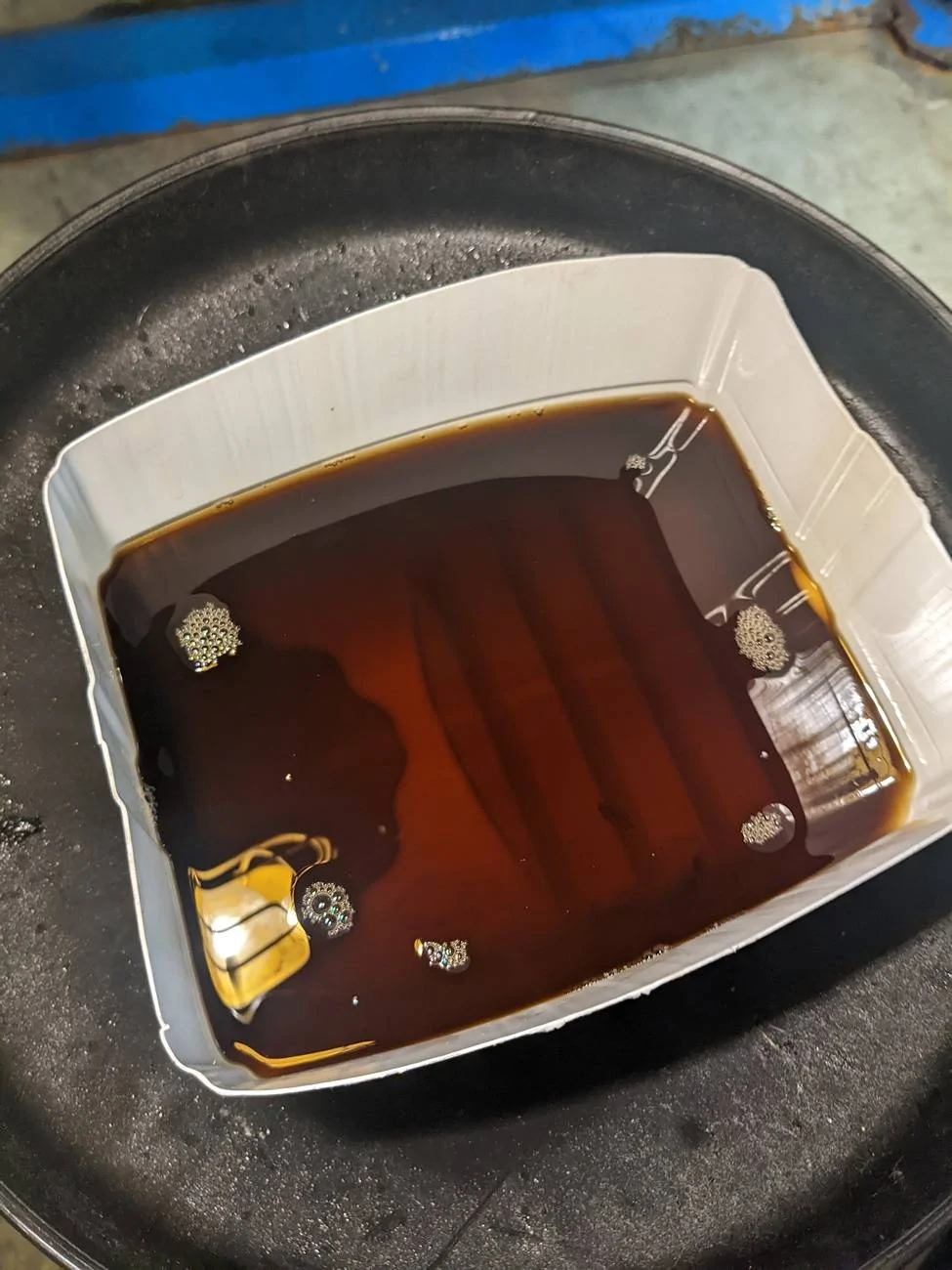

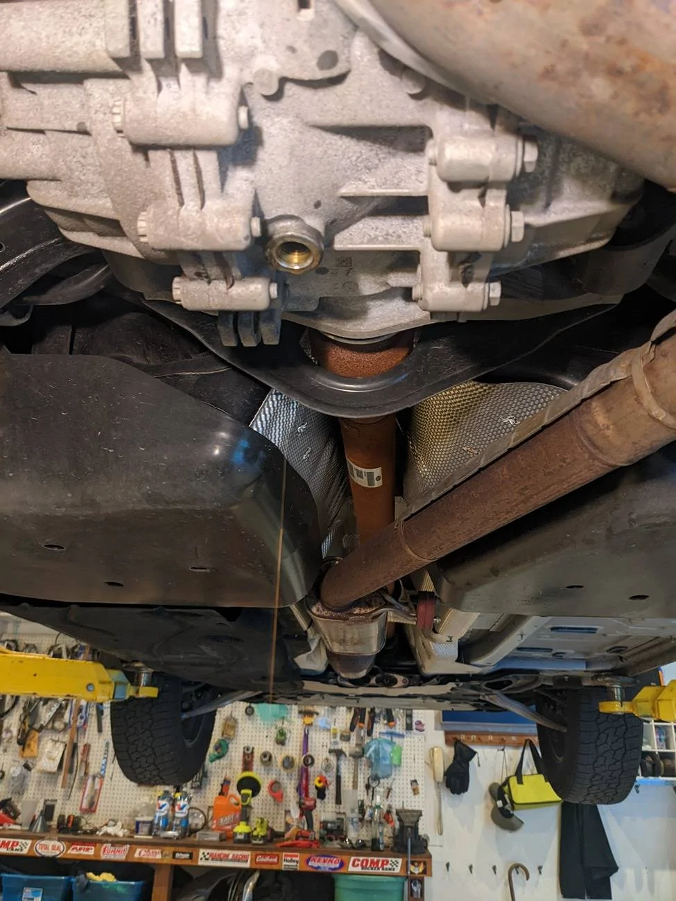

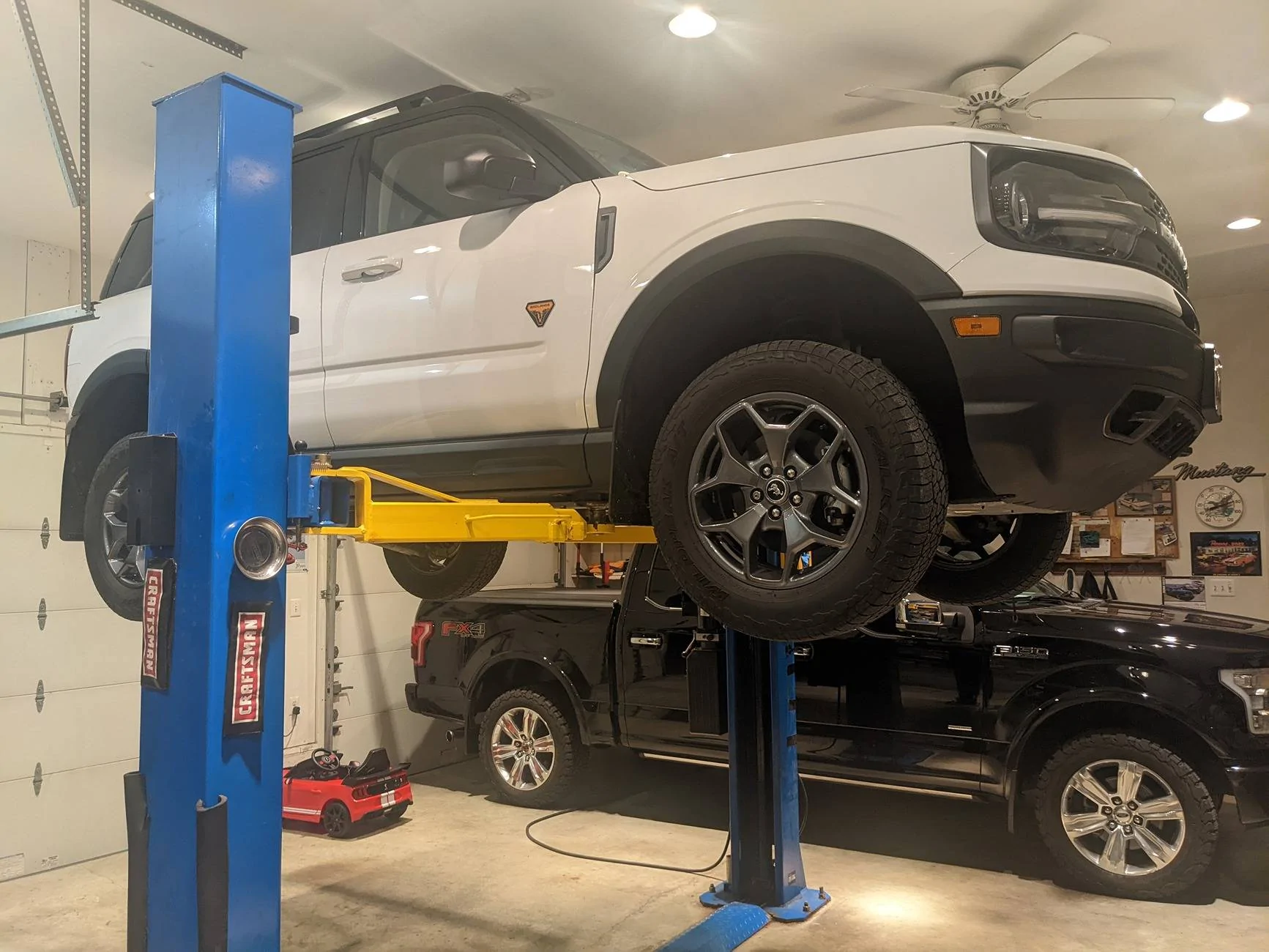

Drained and refilled RDU fluid due to the '21s vent tube issue where water dirt can get in. 23k miles. Fluid was not low and not very dirty either. Drain plug had magnet.

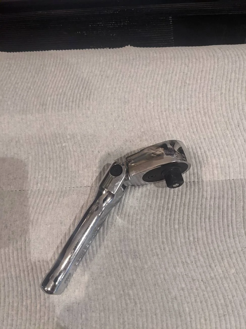

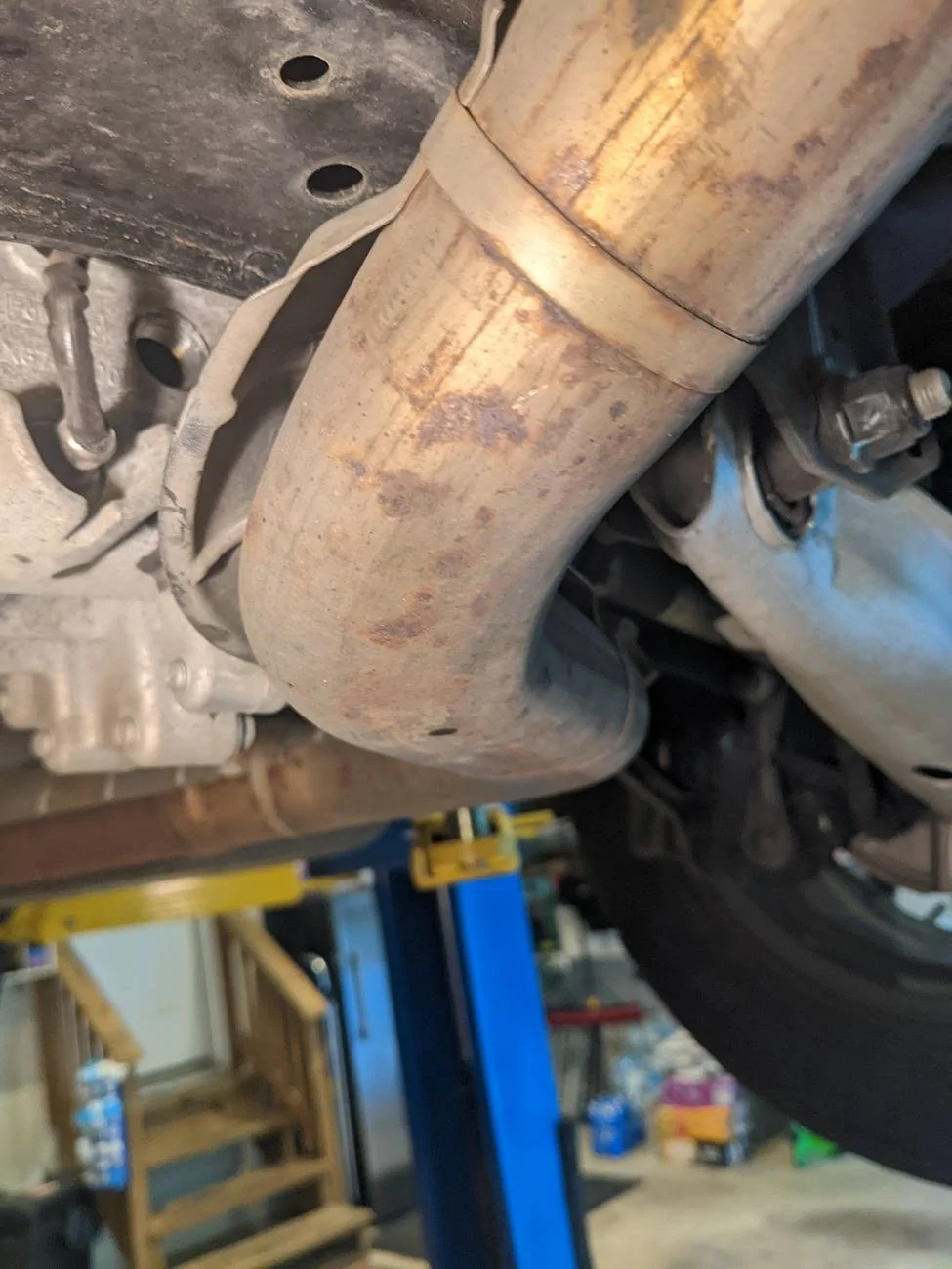

Had a hard time getting fill plug out with exhaust pipe in the way. Used 3/8 ratchet with bendable head which was able to reach up in there
Used fluid pump to get gear oil back in. Teflon tape on plugs. Do not over tighten because plug holes are tapered and you could crack housing like I did on my old F150 transfer case.
Other then fill plug remove replace challenges not hard at all. Make sure you turn plugs in with fingers to get started to avoid cross threading.
Eye balled up vent tube in wheel well. Its up there behind felt liner. Mine is straight up early design. Plan to come back and add a loop down to mimic the '22 redesign. Will post up later.

Up on lift

To remove the fill plug I used the flexible head ratchet alone and no other parts were removed.

I didn’t have a ratchet with a bendable head so I undid the muffler at the back ( removed bolts that screwed the hanger brackets into the frame). Was worth the extra 5 minutes to me as I was able to remove with a normal 3/8 ratchet end and screw the plug back in rather easily. Just supported the muffler a bit so that no damage occurred further up. Silver greased the bolts that go back into the frame as a precaution.
