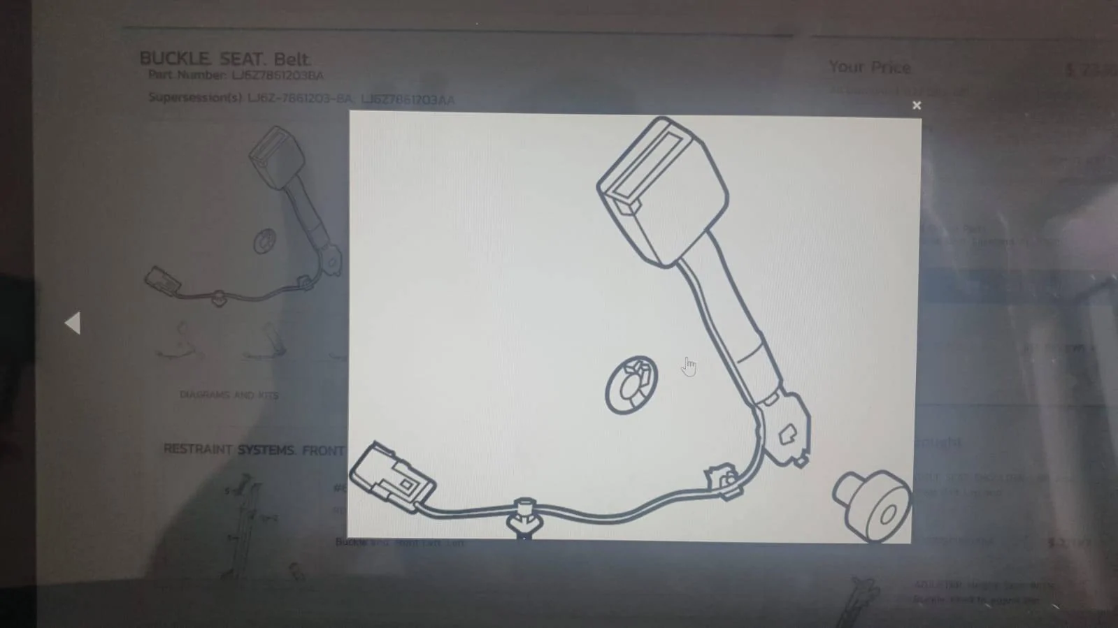

So following up from last weeks temp fix. I decided to change out the seatbelt buckle for good. Safety first!
Plus the part is not expensive, about 30 dollars I paid. I do not recommend to get one from junk yard, again, safety first!
I saw there are some info across different forums that you need to take out the entire seat to change. It is a good way to do it, but I want to share how you can switch it without taking your seat out for people who don't want to take apart their interior.
Tools you need:
T50 bit: short bit that can fit in the gap
Long 1/4 wrench: this will hold the T50 bit. I have a shorter 1/4 wrench, so I used a steel pipe to make it longer and get more leverage.
Part you need:
LJ6Z7861203BB
I bought it from fordparts.com, picked up Second day from a dealer. The website may prompt you it is a wrong part that does not fit. I had it fit perfectly and it is the same.
Here are the steps:
1. Shut down the car and raise your seat to the highest.
2. Unplug the buckle cable from below, it is easy to trace.
3. Use the T50 bit and 1/4 wrench to take off the seatbelt buckle. Maybe easier to do it at the back seat.
4. Replace the buckle with a new one and tight the screw, make sure it is real tight.
5. Turn on the car, you should not getting this message anymore, but if you have Forscan, go in there and clear the DTC for RCM.
Voila! You should not get this anymore.
