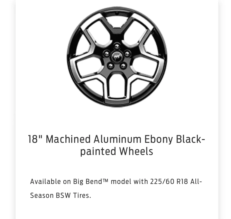

These are the optional 18" wheels and tires for the Big Bend.

I have used separate winter/summer wheels and tires for decades. I will say that the winter tire should be narrower than the summer. In snow/slush you want the tire to dig in and get down to the road (if possible). A wider tire in the winter is more likely to "float" or "hydroplane". If the summers are 225/60 R18, then I would look for something like a 205/70 R17 though that is just a guess on the "70" part of that.
Currently I run 235/35 R19 in the summer and 205/50 R17 in the winter on my VW Golf R.

The only 18s listed on the tech specs are the standard OBX tires which are 225/60R18 Michelin Energy Saver A/S. The only optional tires listed for the BB are the Continental A/Ts. I don't know that this answers the question, but it gives a reasonable possibility.
