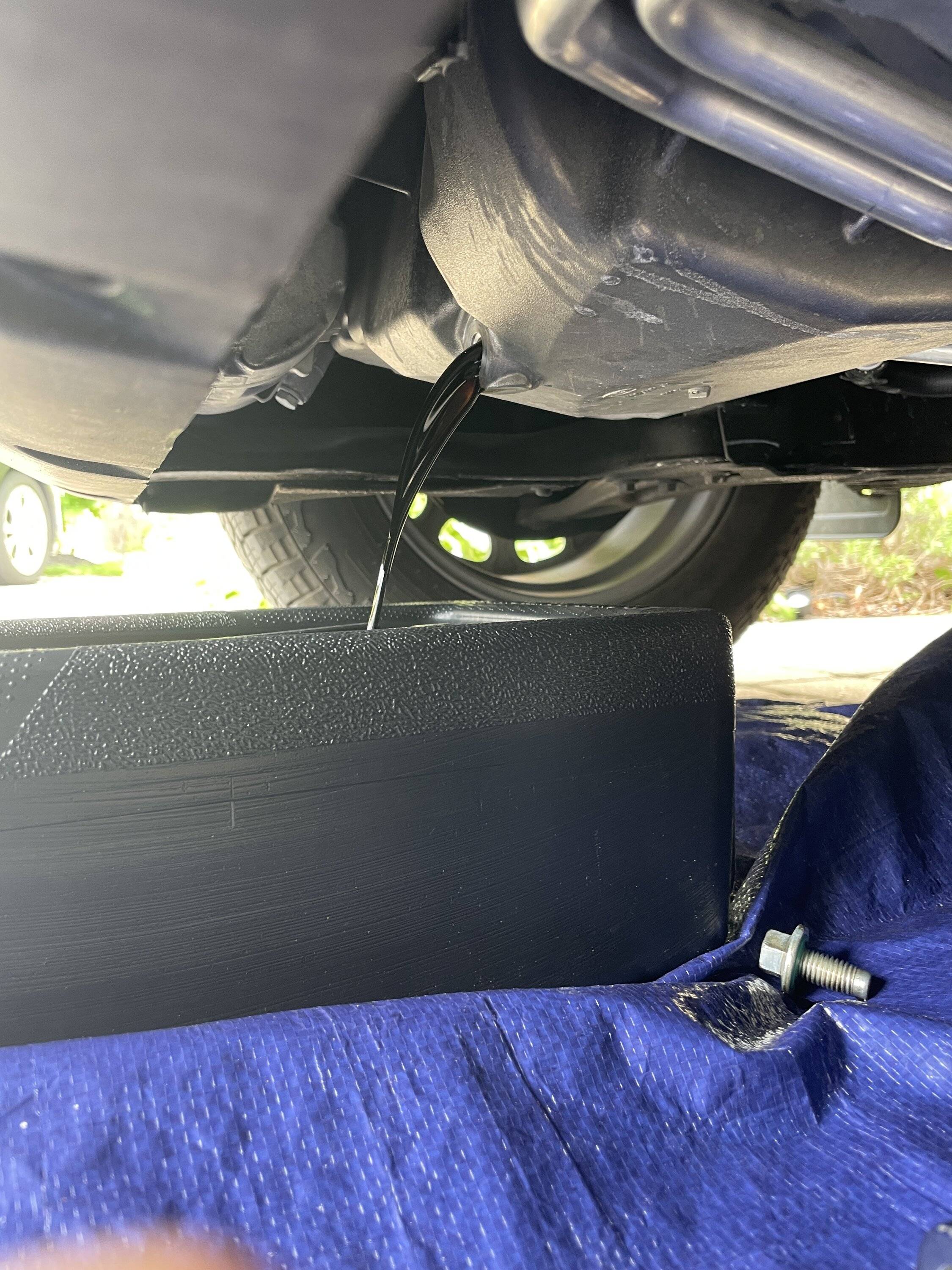

Good day, recently changed the oil in our BL but I didn't see any sort of washer on the drain plug.
Does anyone know if there is a part # for it and if this should be replaced each oil change? You can see the drain plug on the bottom right of the attached picture.

Edit: Checked in at the dealership. For anyone wondering, the drain plug has a gasket on it and is meant to be reused. They said that you can keep reusing it as long as it is not cracked/damaged.

There is an o-ring attached to the drain plug.

I recently did my first oil change (3000 miles) and when I removed my drain plug I also noticed no plug gasket. Looked like there should have been one to me. I wasn't looking directly at the pan drain, but stuck my finger around the drain and the washer came off on my finger. It was stuck to the pan. Looked good so I reused it. No leaks.
Yours may have dropped unnoticed into the drain pan.
