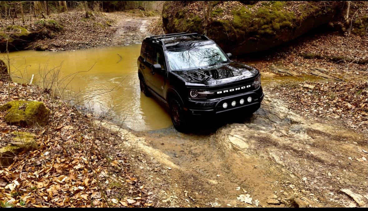

I have the rough country nb. Install wasnt bad and I have round leds for it.
Main reason for it was to add the lights and a little extra layer when going through the backwoods.

Thanks for responding. I've seen the RC one and do like it. Did it interfere with any safety features on the vehicle ... sensors, camera ... no issues? If you add the lights ... where exactly do you add the controls? Is it integrated in the other light cluster switches? Or is it just a hidden toggle or something similar?

Nope no issues!
it came with a switch that you have to run through the firewall that you can place on your dash or kick panel.

Excellent ... thanks for the pic and video clip. I'm convinced ... now to talk my brother-in- law into doing the install ... with me as his inexperienced helper.
Thanks again!
