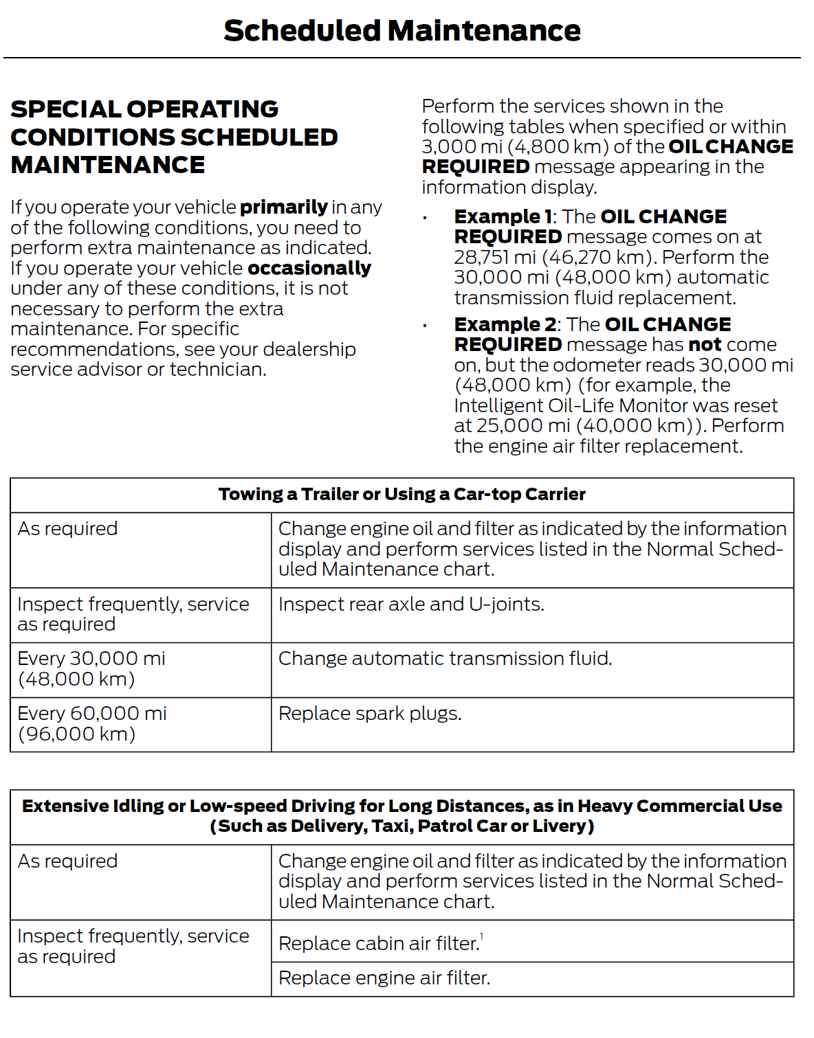

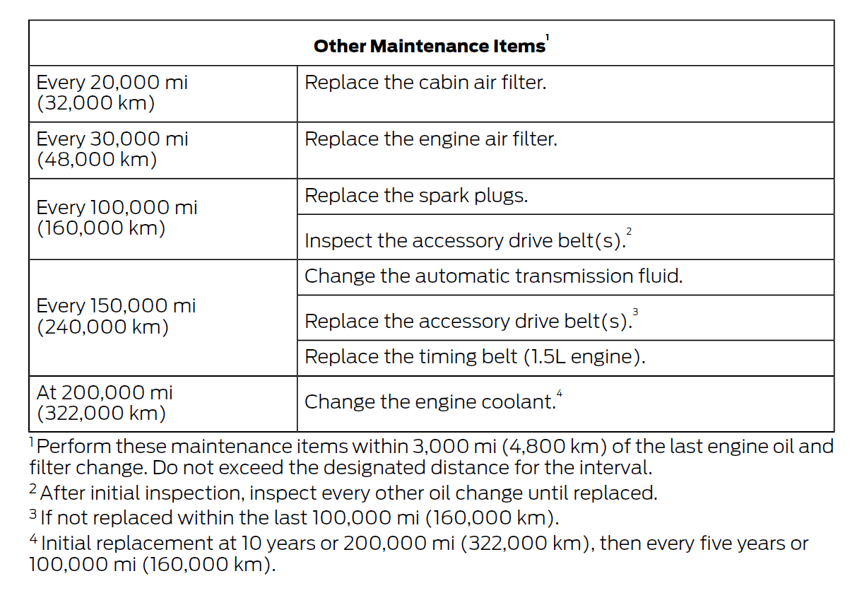

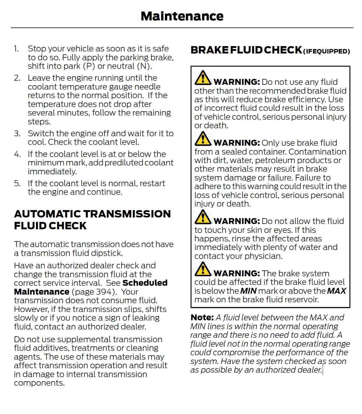

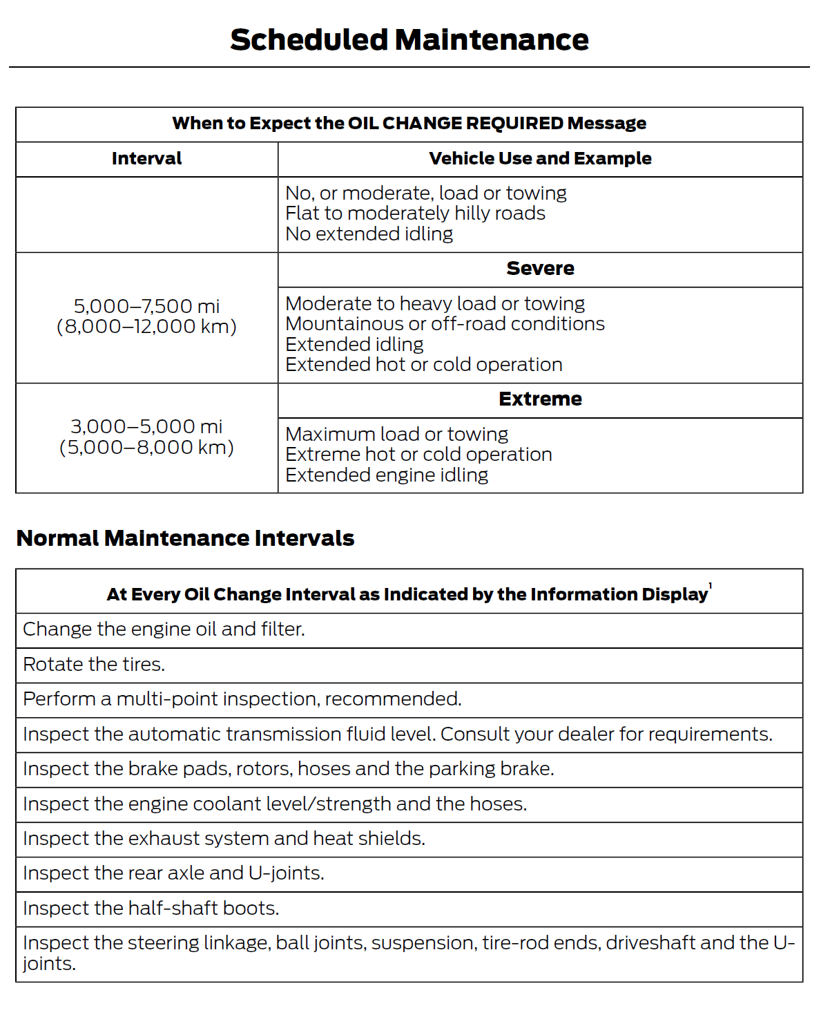

so I usually do not go by manufacturers recommendations with so called "life time" fluid when they write that in a manual.
I wish I knew where that term came from: I cannot find anywhere in my manual (2021 MY) where it says the transmission fluid is a "life time" fluid. Perhaps this is something salespeople started, but I don't believe Ford markets any of its cars as having life time transmission fluid. Here's what I see in my manual:
Ford Bronco Sport Well- 123,000 miles and it finally happened… transmission issue 1715950891492-nv
Ford Bronco Sport Well- 123,000 miles and it finally happened… transmission issue 1715950964345-eu
Ford Bronco Sport Well- 123,000 miles and it finally happened… transmission issue 1715951001957-zv
Ford Bronco Sport Well- 123,000 miles and it finally happened… transmission issue 1715951041891-9i
I don't see "life time" anywhere. It's seems clear to me that Ford expects owners to have the transmission fluid inspected at each oil change, and to replace it at 150K unless inspection reveals an issue, or the vehicle is operated under any of the special conditions noted.
As to the reason there's no dipstick, who knows? I suspect it's a combination of things. A lot of people who use quick lube joints for oil changes were getting scammed into unnecessary transmission fluid replacement. In addition, many owners didn't really understand that their car required a specific type of transmission fluid, that it may only be checked when it's hot, and that overfilling the reservoir is a big no-no. And even if an owner did know how to check the level they may not know what to look for to determine fluid degradation. Using the wrong fluid and/or overfilling the reservoir can cause serious damage to an automatic transmission.
Perhaps Ford's solution to all these problems was to eliminate the dipstick and require owners to have the fluid checked and serviced by a Ford mechanic. Again, I don't know—this is all speculation on my part.
Whatever the reason, Ford (as far as I can tell) does not market or expect the fluid in your Bronco Sport to be a life time fluid.

Lifetime fluid was in reference to the 2007 Ford F-150 transmission. I'm thinking they removed the term from newer vehicles and recommendations.
