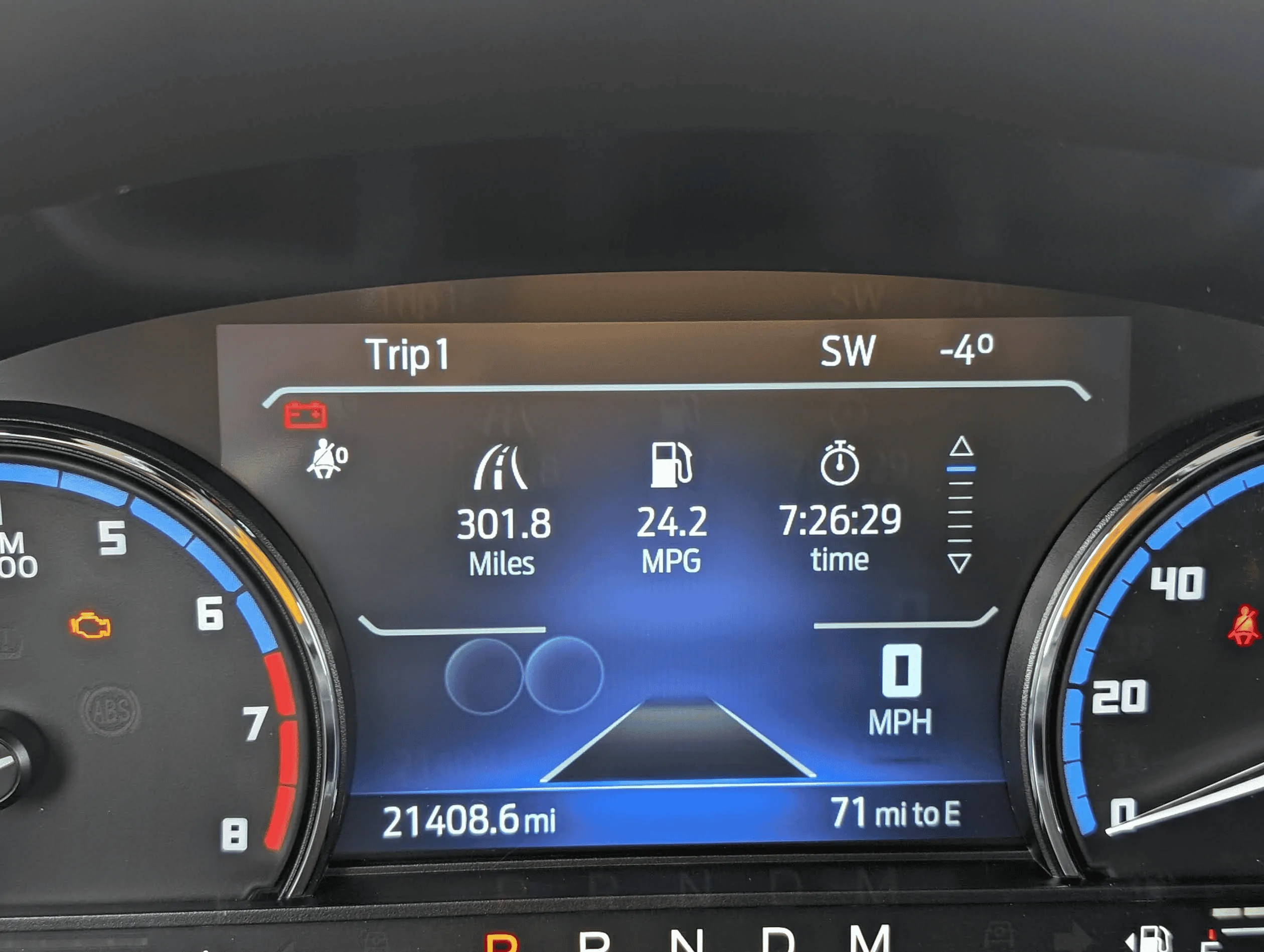

We've had two weeks of cold temps here in the STL area, culminating in today's frigid temps.
Ford Bronco Sport MPG fall off recently - Cold Weather related? 1705264892126
This was right before I filled the tank. Note the number of miles on this tank, and the computer's calculated MPG. That turned out to be optimistic: actual MPG was 23.3. That's more than three MPG lower than the car's lifetime average of 26.7. Winter's here!
