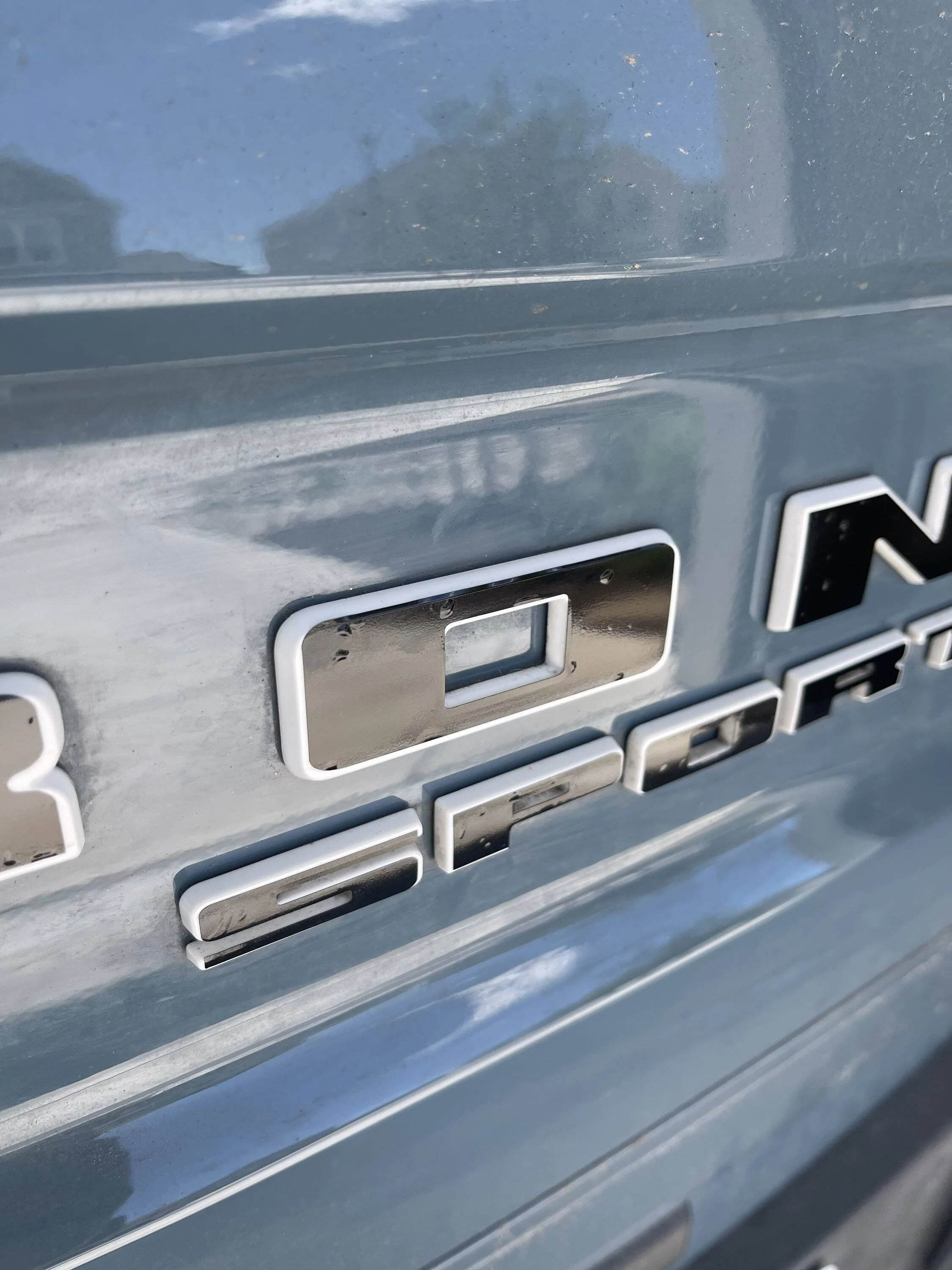

I made the terrible mistake of putting these on in a poorly lit garage and didn’t realize all of these air bubbles. Does anyone have some tips to fix this? They don’t seem to smooth out ?

Try using a hair dryer and squeegee to smooth out the bubbles, may have to use a pin on the bubbles.

It such a small area you may want to try just hair dryer and the card first... try to push the air bubble out. Using the pin will leave a tiny hole but I'd consider it a last resort before ordering new ones
