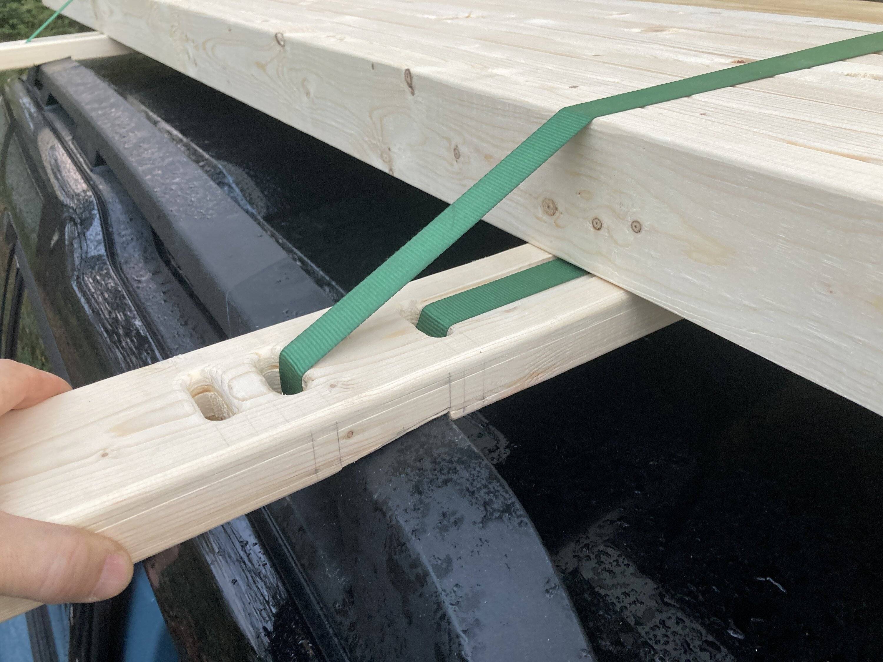

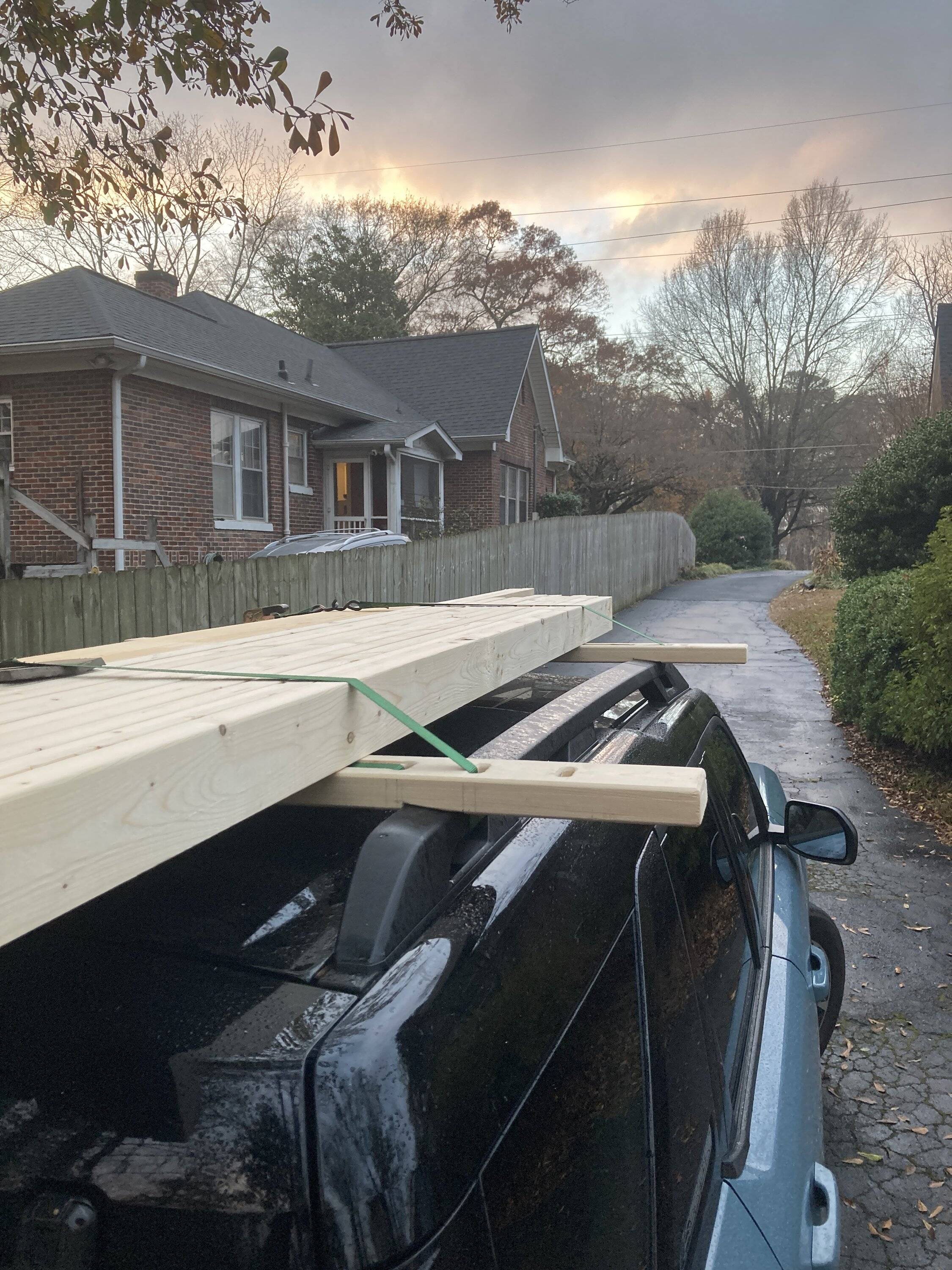

A quick and dirty set of crossbars for the occasional Lowe's or Home Depot lumber run. (1) 10ft 2x4 required and some time in the shop. Easy to mount, no mounting tools required, easy to store. The strap goes under the rails to hold the "bars" down. The outside holes in the bars are set for 4x8 plywood. An additional strap around all of the the boards, "clamping them together so the center ones could not slide out, had been removed before I took these pics. NOT to be used for highway speeds!
Ford Bronco Sport Lets see those DIY roof racks!!!! 2023-12-09 17.12.01
Ford Bronco Sport Lets see those DIY roof racks!!!! 2023-12-09 17.12.24
