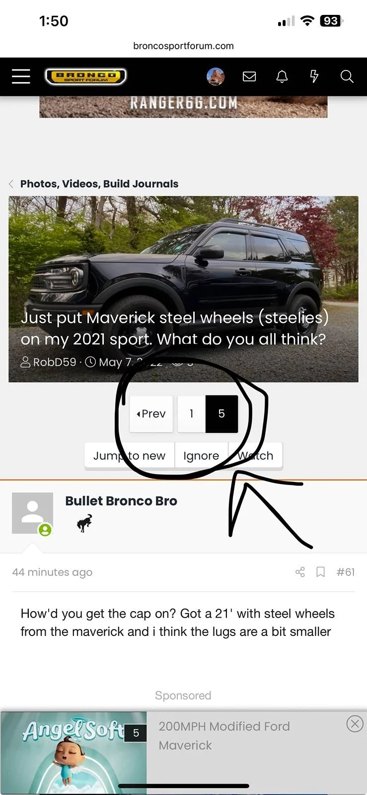

How'd you get the cap on? Got a 21' with steel wheels from the maverick and i think the lugs are a bit smaller

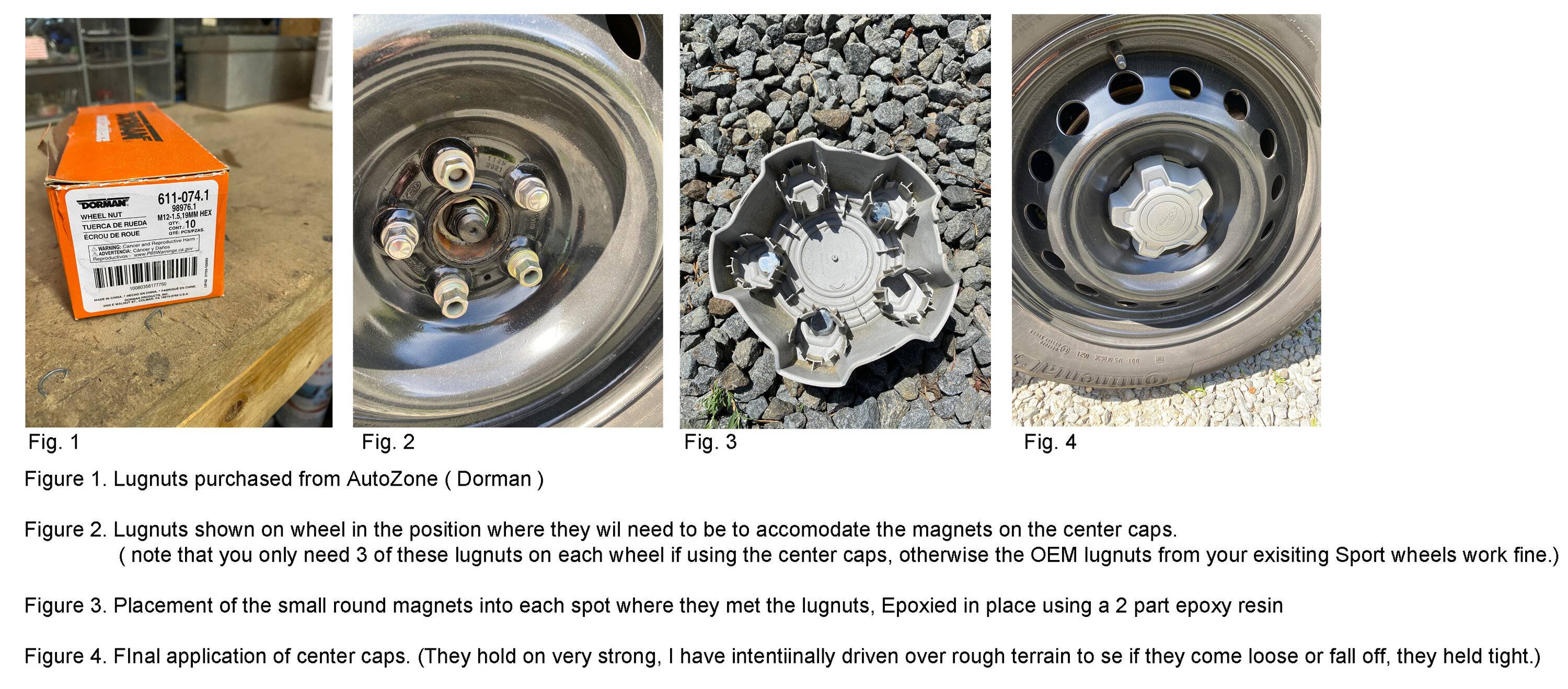

Ford Bronco Sport Just put Maverick steel wheels (steelies) on my 2021 sport.  What do you all think? Center cap install on Bronco Sport using Wheels and Caps from Maverick
Here is the images of what I did to use the center caps, if you are just suing the wheels only for winter, your OEM lugnuts will be fine, you can see in fig. 2 that I still have two of the OEM lugnuts on the whee
Here is the images of what I did to use the center caps, if you are just suing the wheels only for winter, your OEM lugnuts will be fine, you can see in fig. 2 that I still have two of the OEM lugnuts on the wheel.

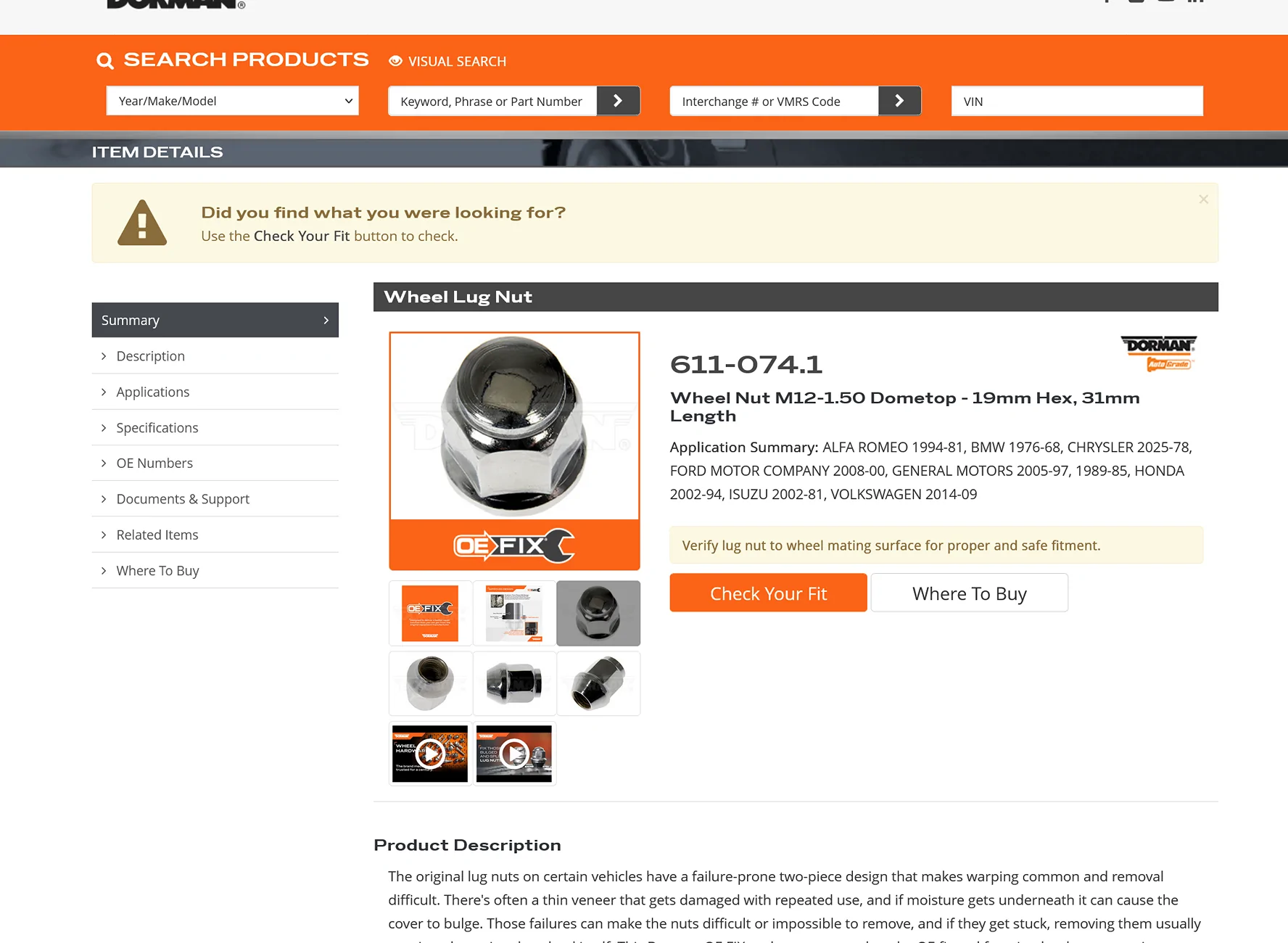

I think lugs I marked with yellow is not what that box part # is for. Because this is what you get from DORMAN with that part #611-074.1
Ford Bronco Sport Just put Maverick steel wheels (steelies) on my 2021 sport.  What do you all think? Screenshot 2025-11-22 at 20-20-54 Wheel lug-2
I would like to know what it really is, to do the same thing. I will try to find something and when I do I will bring it back to everyone.

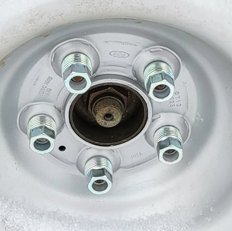

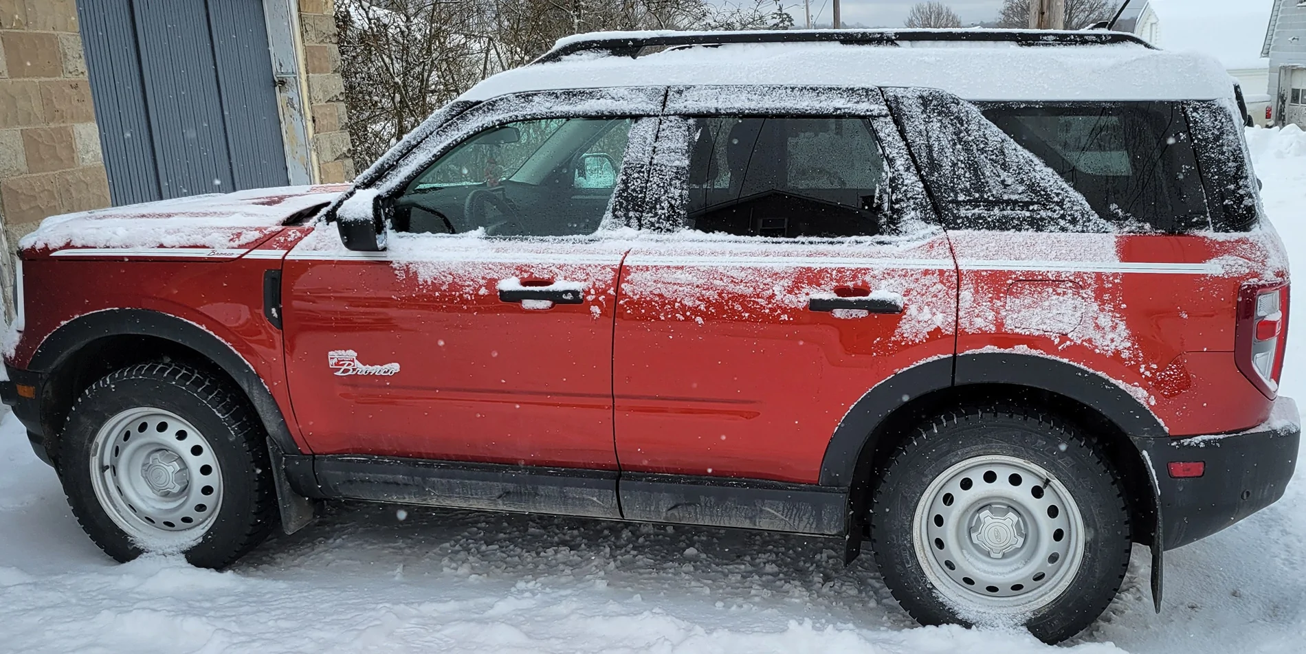

The Wheel Nuts I used was NAPA SOLUTIONS 641-3266 (M12-1.50)
Ford Bronco Sport Just put Maverick steel wheels (steelies) on my 2021 sport.  What do you all think? 20251211_093357

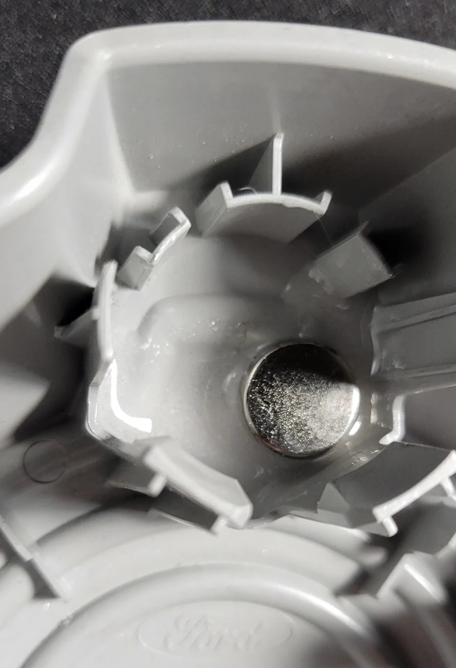

I then used N52 Magnet - 1/2" D x 3/16" H, 32 pack Rare earth round magnets from Amazon. I epoxy them in with J-B Weld ClearWeld epoxy to the plastic hub-caps.

They have not come off after a month of running them from speeds up to 70 mph and over large bumps/railroad tracks at speed.
This works great for my winter tires.
