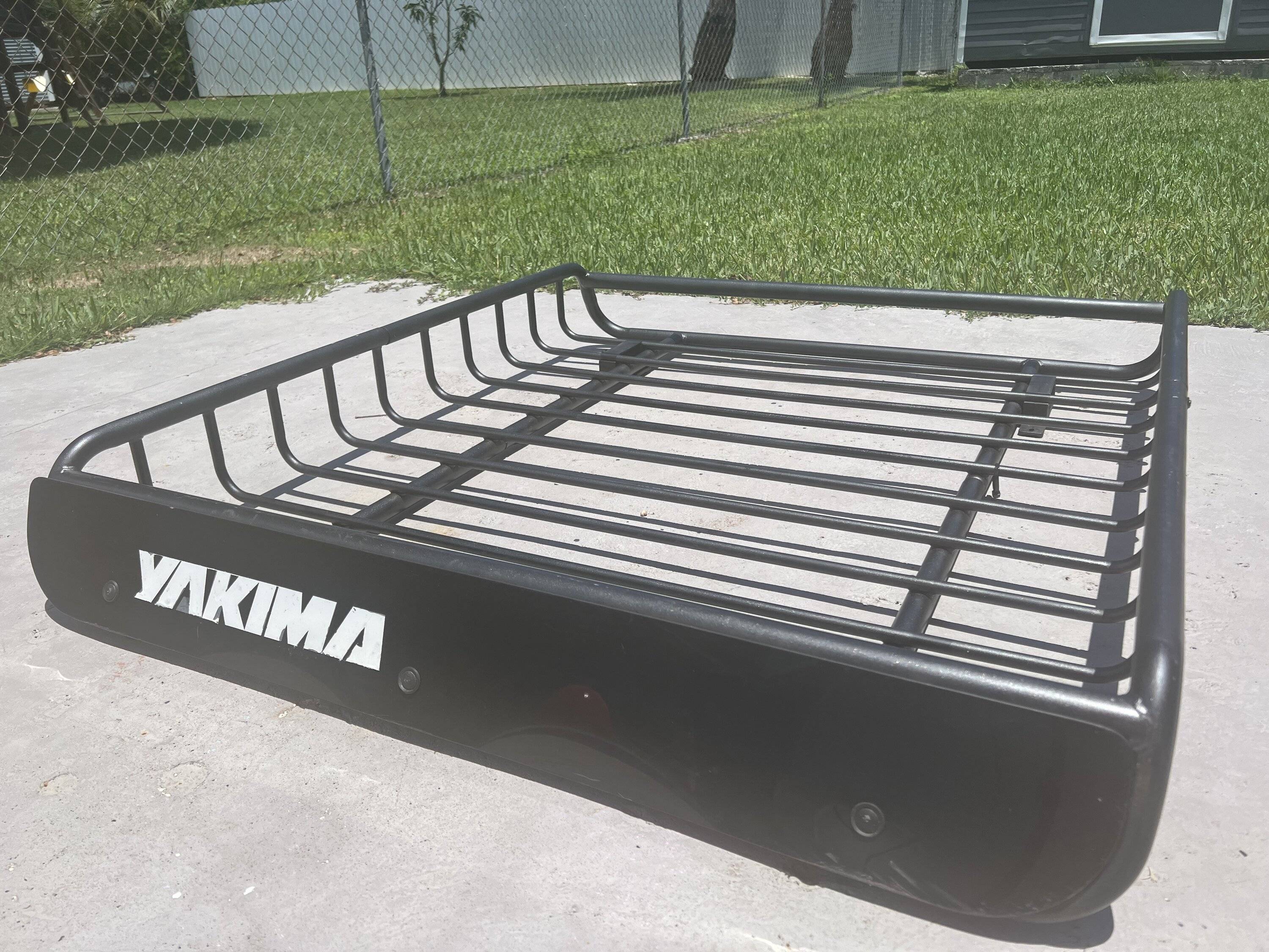

Looks okay from far away.
Ford Bronco Sport Just got a used Yakima LoadWarrior IMG_4774
But if you get up close, you can tell this guy avidly used it, as it has a tinge of corrosion and is plenty dirty.
Ford Bronco Sport Just got a used Yakima LoadWarrior IMG_4776
So here's what I was PLANNING on doing, but I wanted to throw this thread out here to the great minds on this forum also.
1) Soak rag in PB Blaster, and generously wipe down the entire rack.
2) Brush some Naval Jelly on any areas the PB Blaster couldn't eliminate the corrosion entirely (which just might be a few small dotted areas)
3) Reseal with some Black Krylon type enamel.
Anyone got better products or steps than those to try to freshen this thing up?

As suspected, it cleaned up REALLY NICE with a generous rub down of PB Blaster. The only bad spots were where the ends of the basket merge together (in order to expand it with another piece if necessary). There was obvious water introduction as it was actually still just sitting inside the tubes. When I unmated it, a little bit of brown liquid poured out. So I sprayed some WD40 in there to get any remaining water out and let it sit out in the sun for a bit. Cleaned it up further with some more PB blaster, and then I thought I had some Naval Jelly, but couldn't find it, so just used one of my daughters paint brushes and some anti-seize and just generously coated the mating areas where there was some still residual oxidation showing. Coated the mating screws, and the mating threads and then cleaned up the wind fascia and removed the sticker he had on. I tried some Goo Gone on the Yakima sticker/paint/not-sure-what but to little avail. Will probably just leave it or get somehting to stick over it.
Decided against any 'last step' sealing coat. The powder coat still showed itself to be excellent outside of the aforementioned mating areas.
All in all, super happy to finally have alleviated much of the storage concerns I had with this vehicle.
