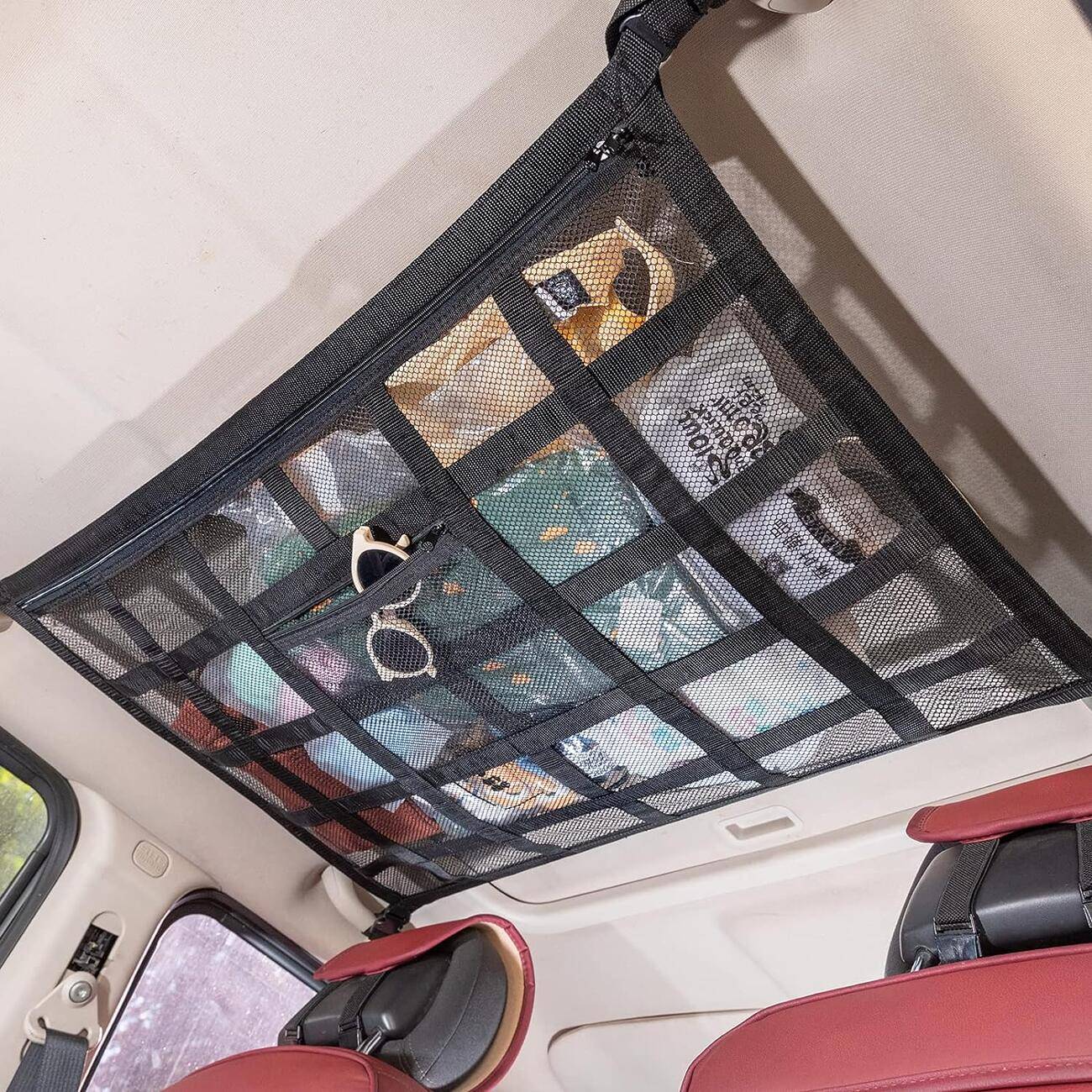

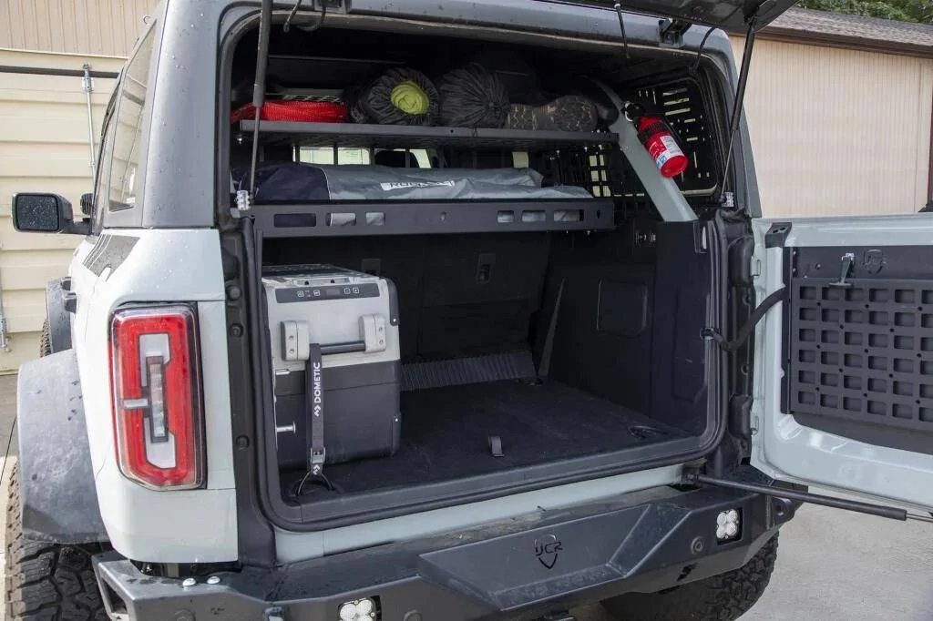

I am a prospective BS buyer, and realize these pictures aren't BS per se.
I'm wondering if anyone ever configured something like this? With all the rear headroom -- seems like an great use of space.
Ford Bronco Sport JCR Rear Hatch MOLLE Panel - Weight Problem 1739130435303-3t
Ford Bronco Sport JCR Rear Hatch MOLLE Panel - Weight Problem 1739130617200-2
Ford Bronco Sport JCR Rear Hatch MOLLE Panel - Weight Problem 1739130218151-r6
I would have much preferred that to the one I have that attaches to the inside of the rear hatch. The factory push clips were never designed to support any additional weight, even a 3lb fire extinguisher and a 2lb trauma kit seem to be too much. I like the idea of it, looks great but I need functionality. I need to figure out how to keep the interior panels from continually separating every time I close the hatch. I'm sure I'll end up mounting the interior panels with 4 nut-serts and spacers if needed to the metal hatch its self using the push clips current positions as a guide as to where to mount them more securely. That's a project for the spring/summer, photos will follow.
