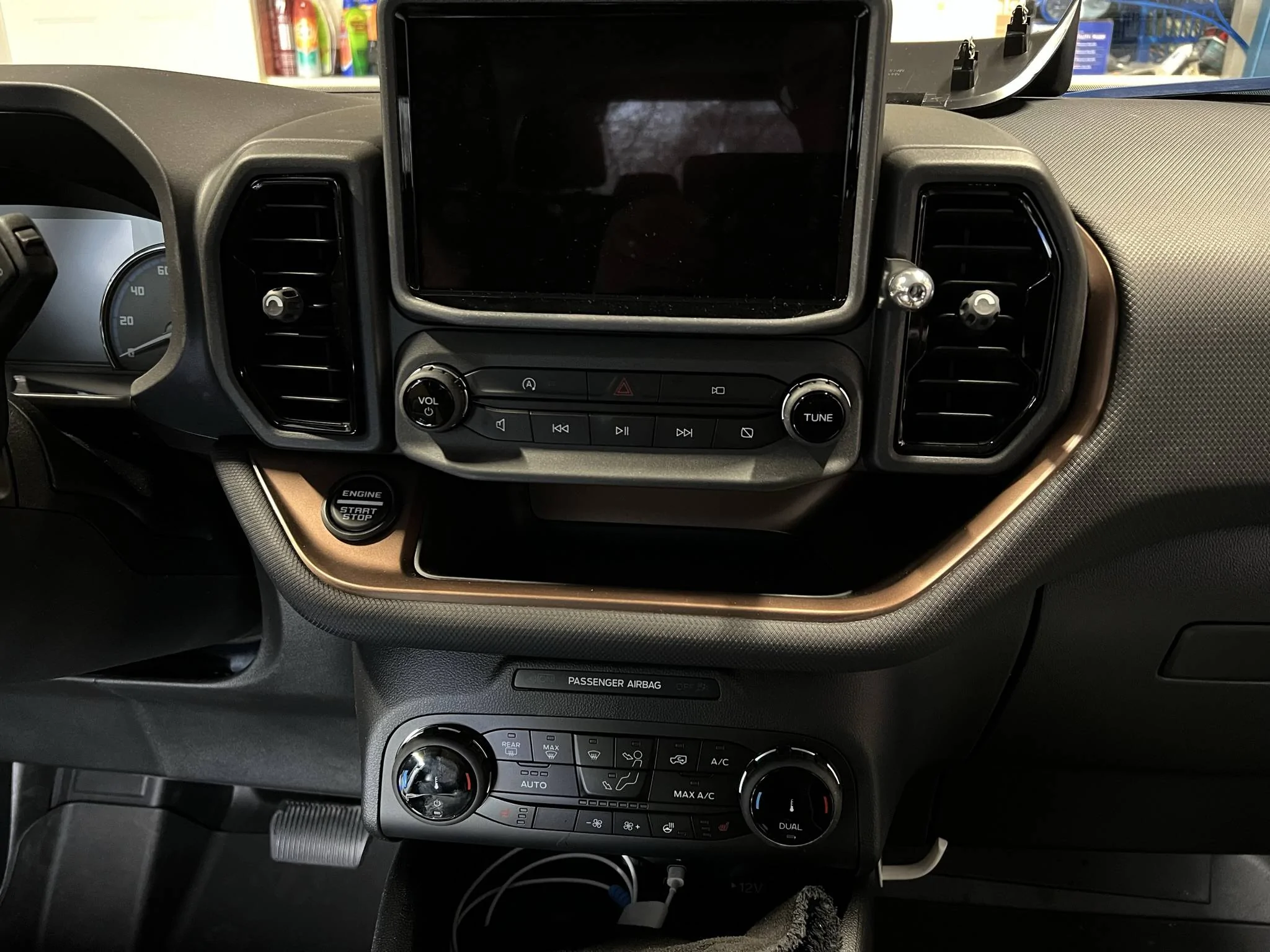

Nice and clean with just the bracket and ball installed.
Ford Bronco Sport Integrated Pivot Ball Phone Mount IMG_4740

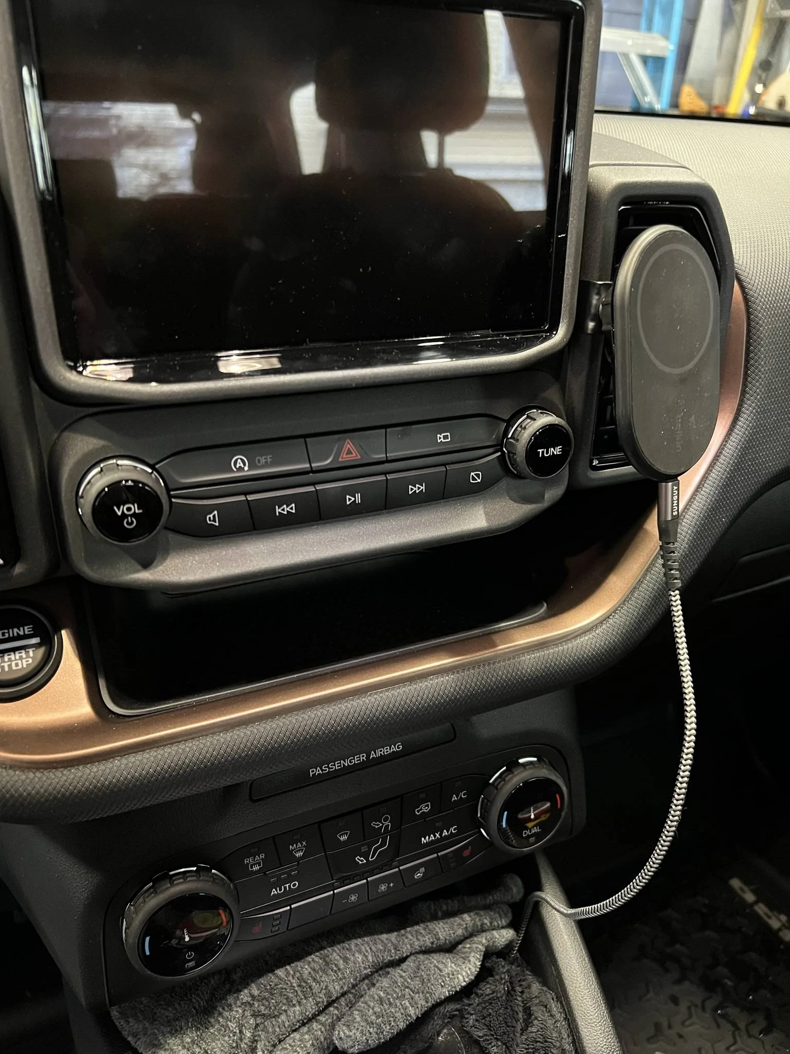

With my own magnetic holder/charger

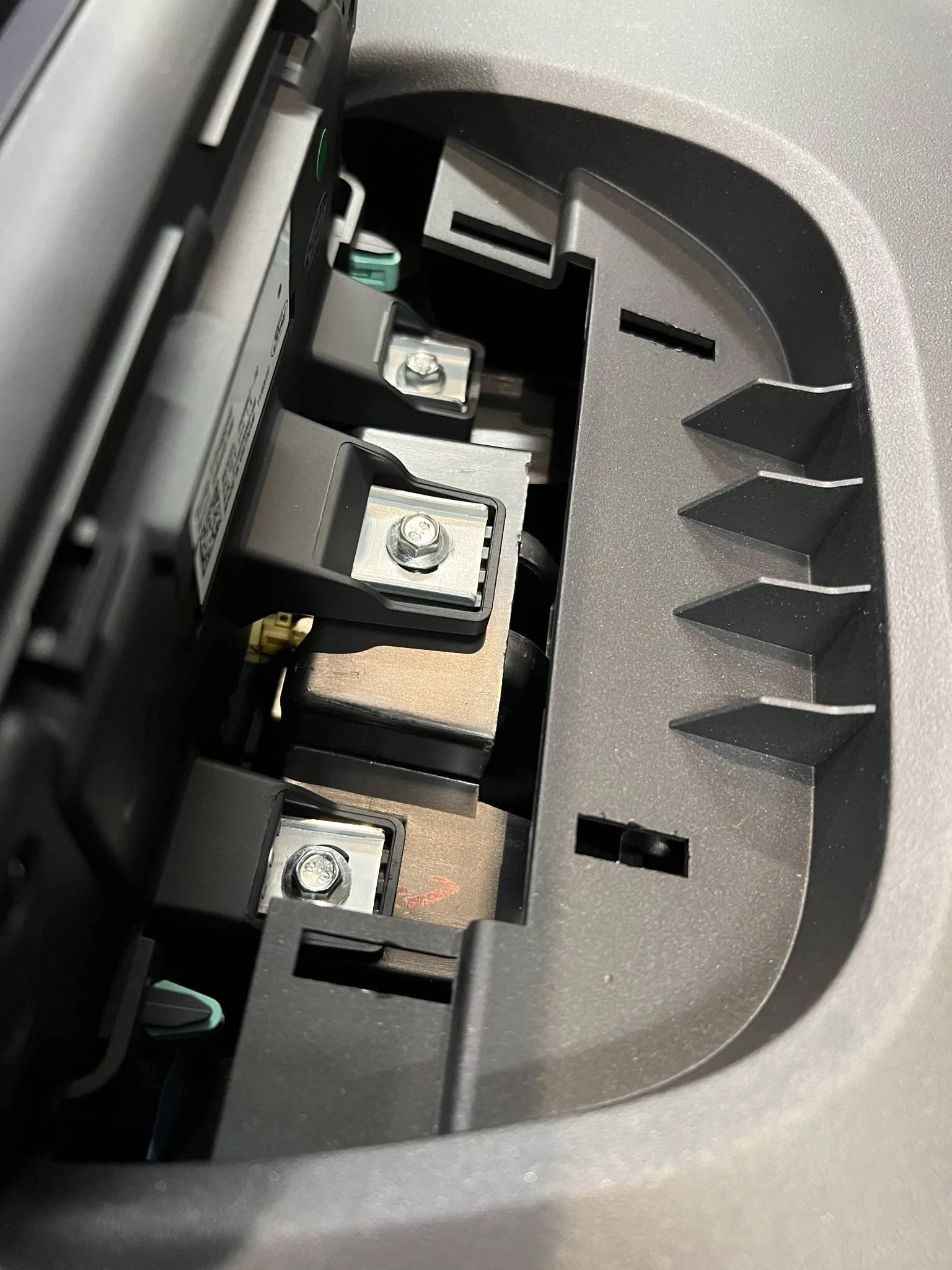

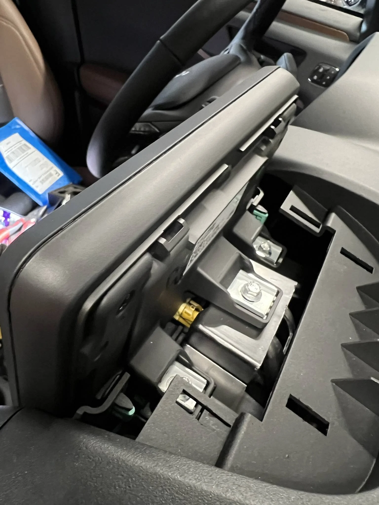

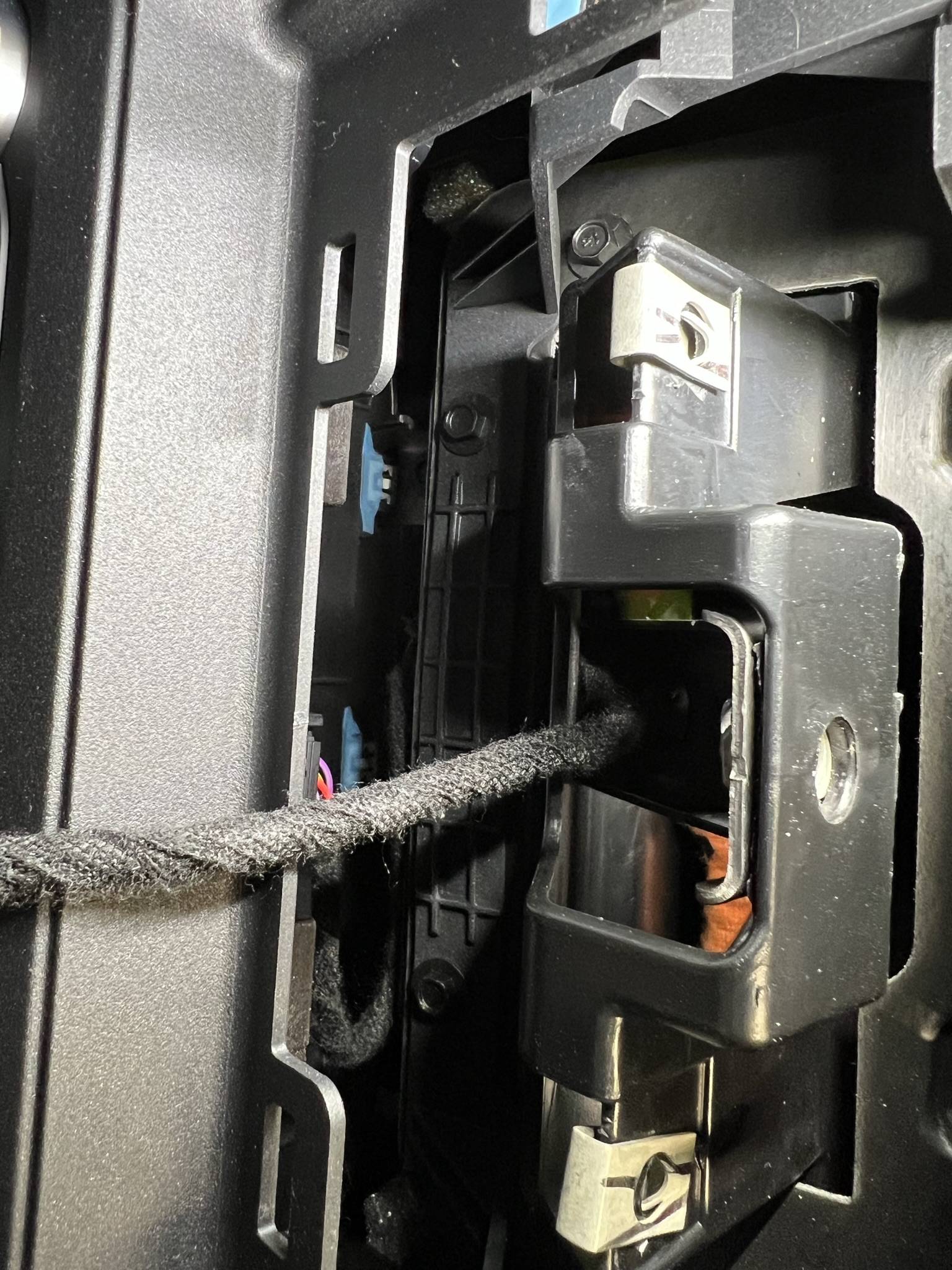

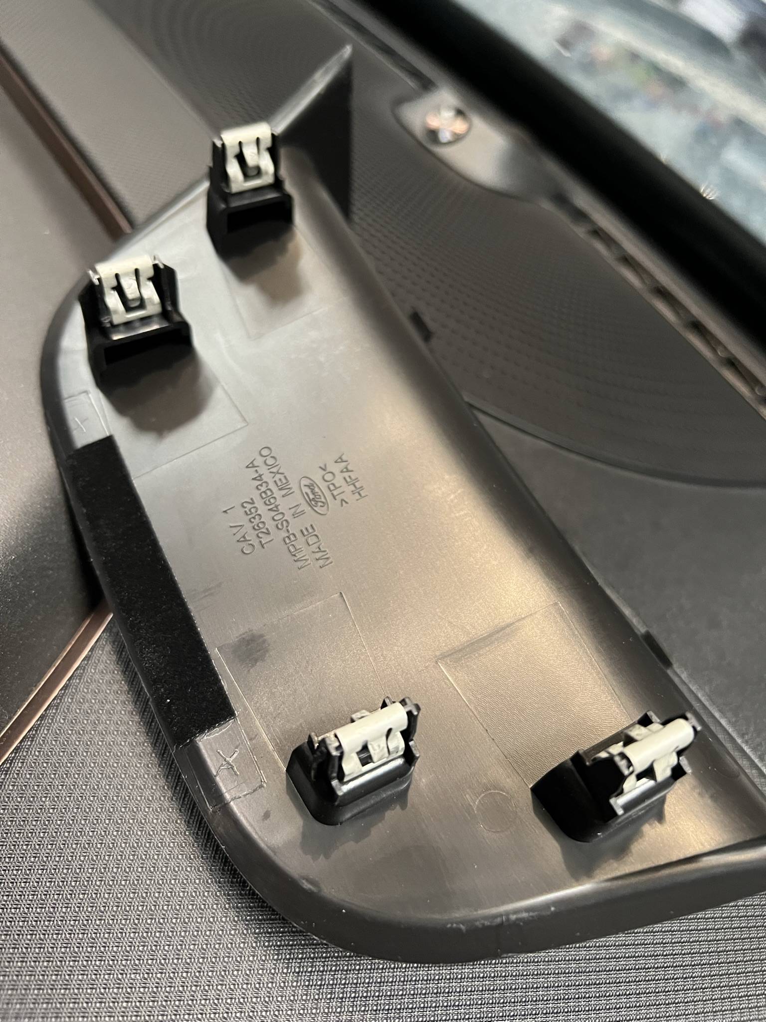

Here are some pictures I took during the installation. When prying off the dash piece, mind the two tab at the top back of the screen as mentioned in the video. This piece goes up straight to release the tabs.

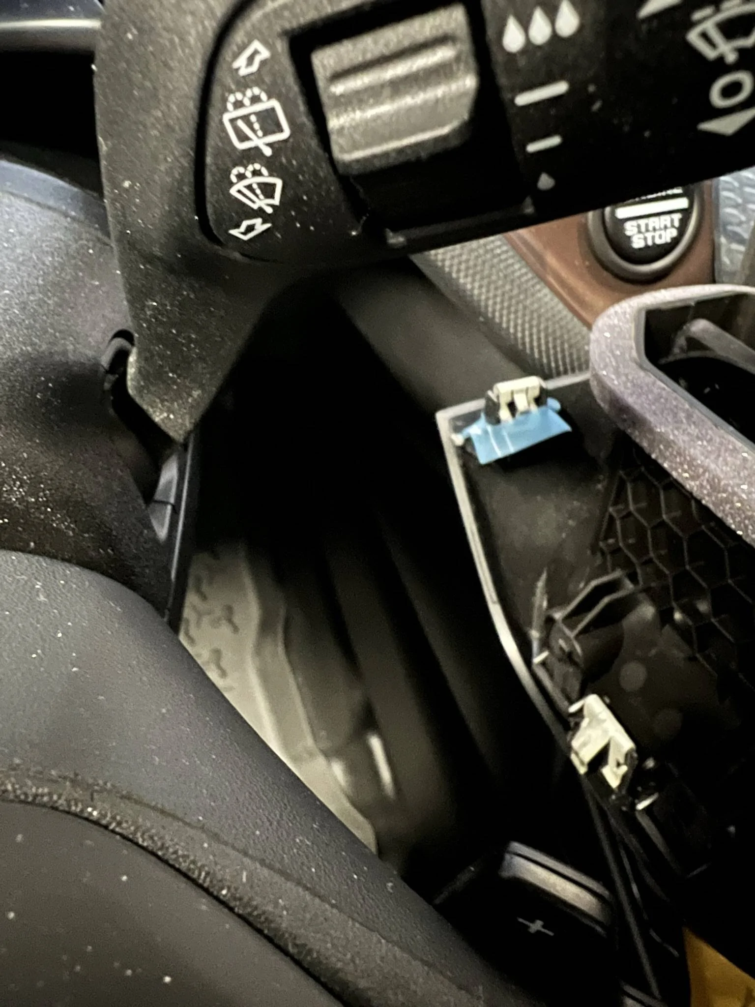

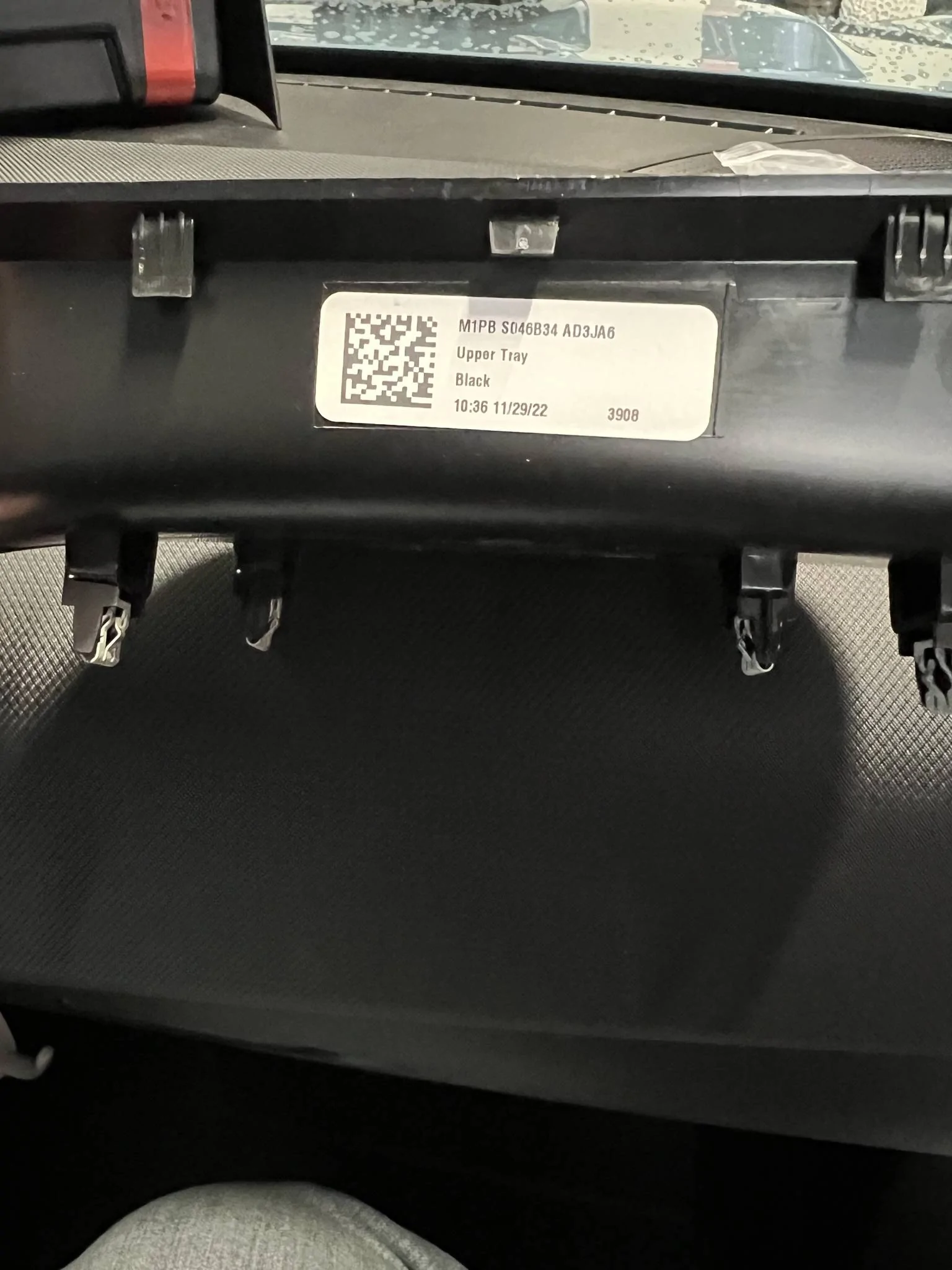

Note the locations of the tabs here on the vents and the three tabs under the unit. I had to use the pry tool around the vents to help removal.

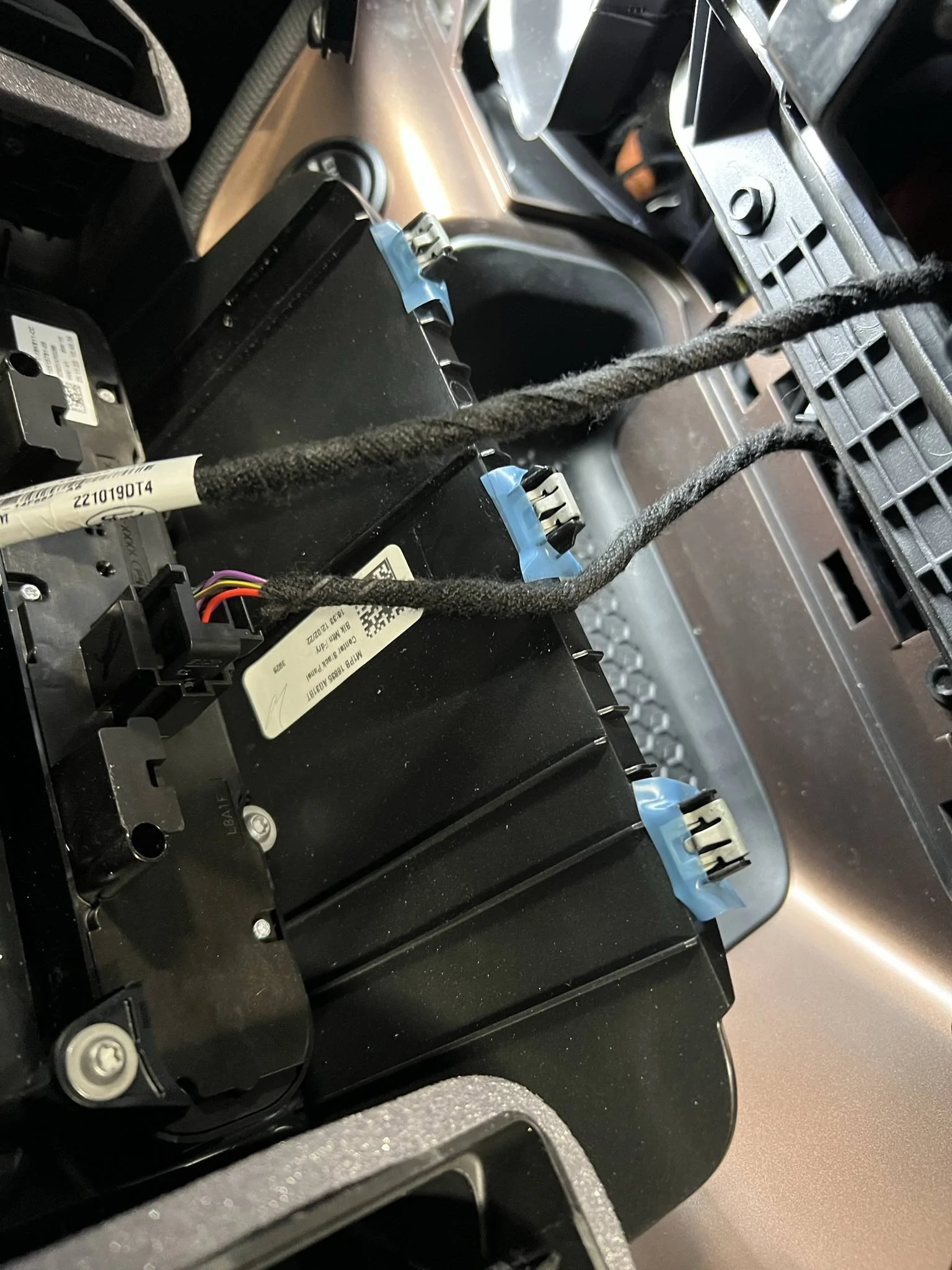

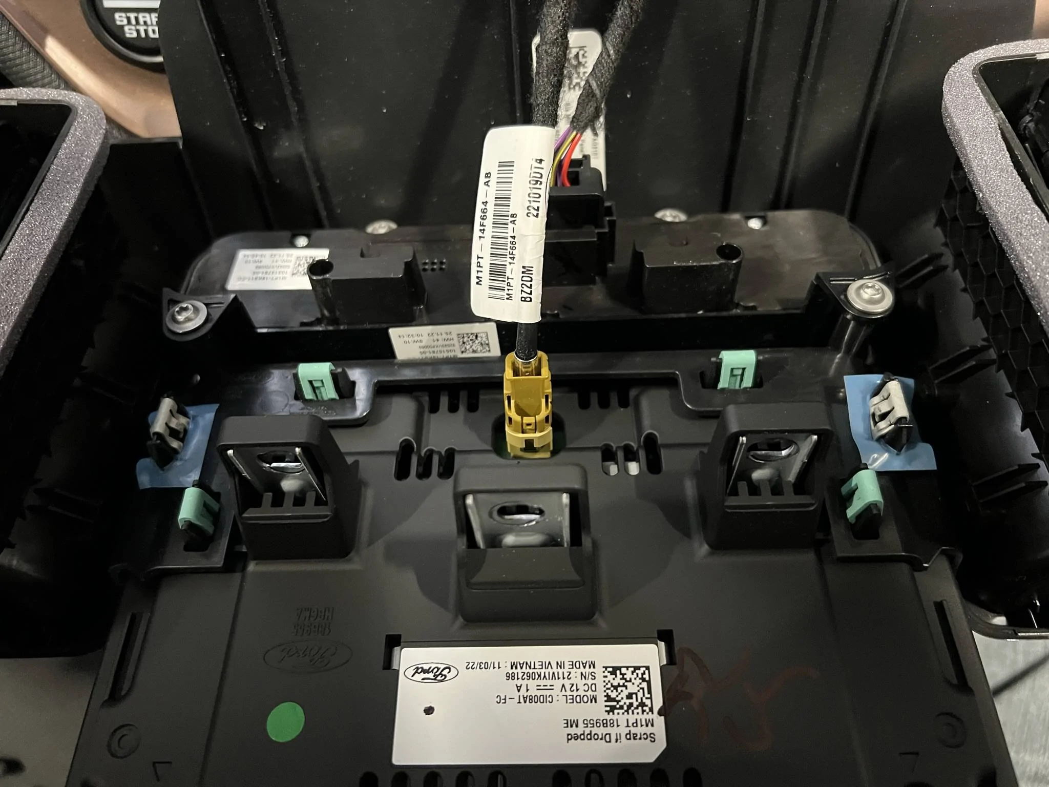

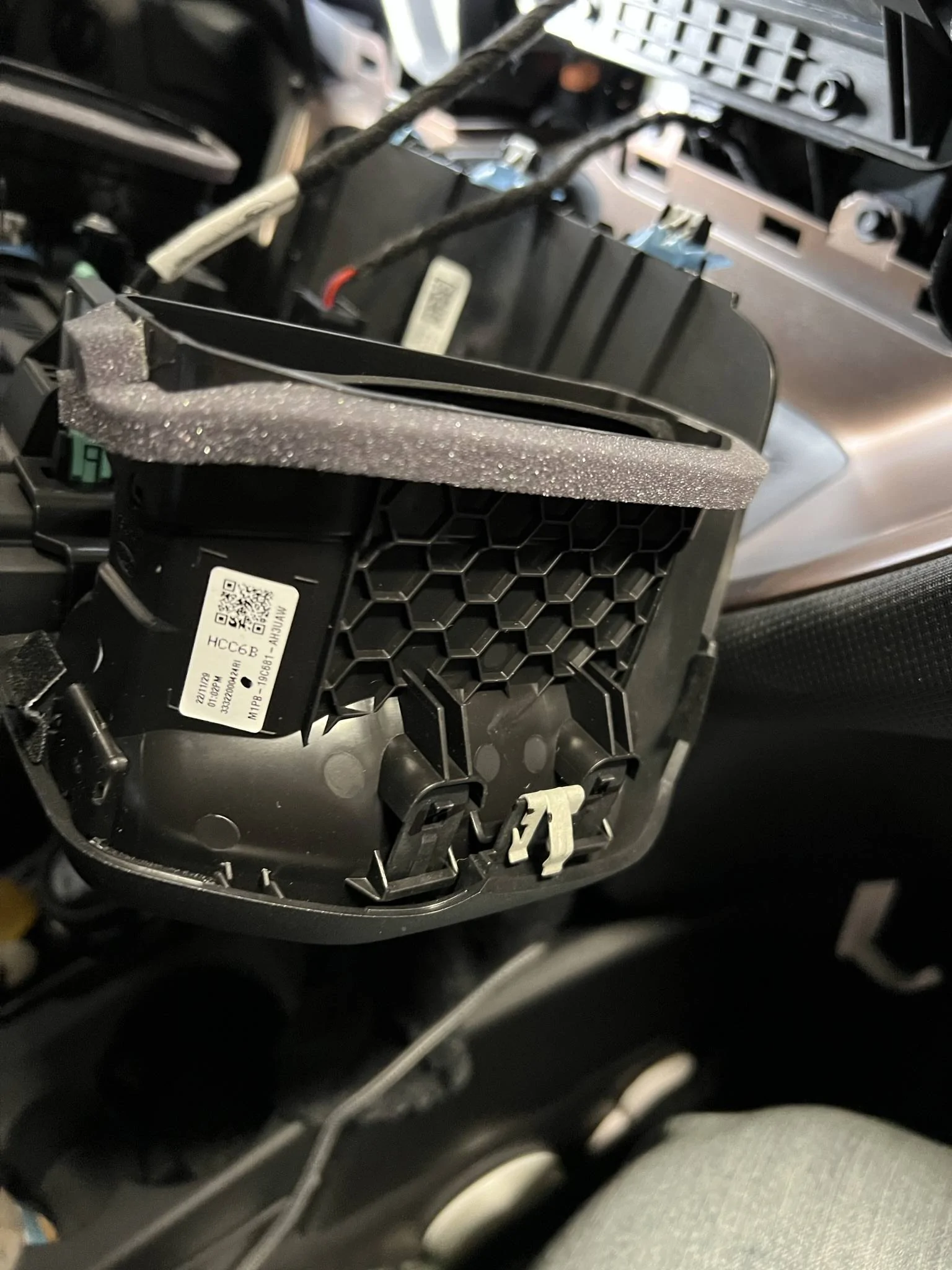

This is a view of the unit removed. The four green tabs are the ones the phone mount get installed on. Watch the video for a more details on how to remove the screen and install the mounts and then re-installing the vent housing and screen. Because of the metal mounts, the screen clips are difficult to push all the way on. I did the best I could, and it is also secured by the three bolts. No issues once completed.
When reinstalling the vent housing, make sure all the clips are on the housing (one of mine stayed back on the dash and fell back a bit, but I got it out and put back on vent housing.) Line up the three clips (has blue tape on them) seen below into the slots when putting unit back.

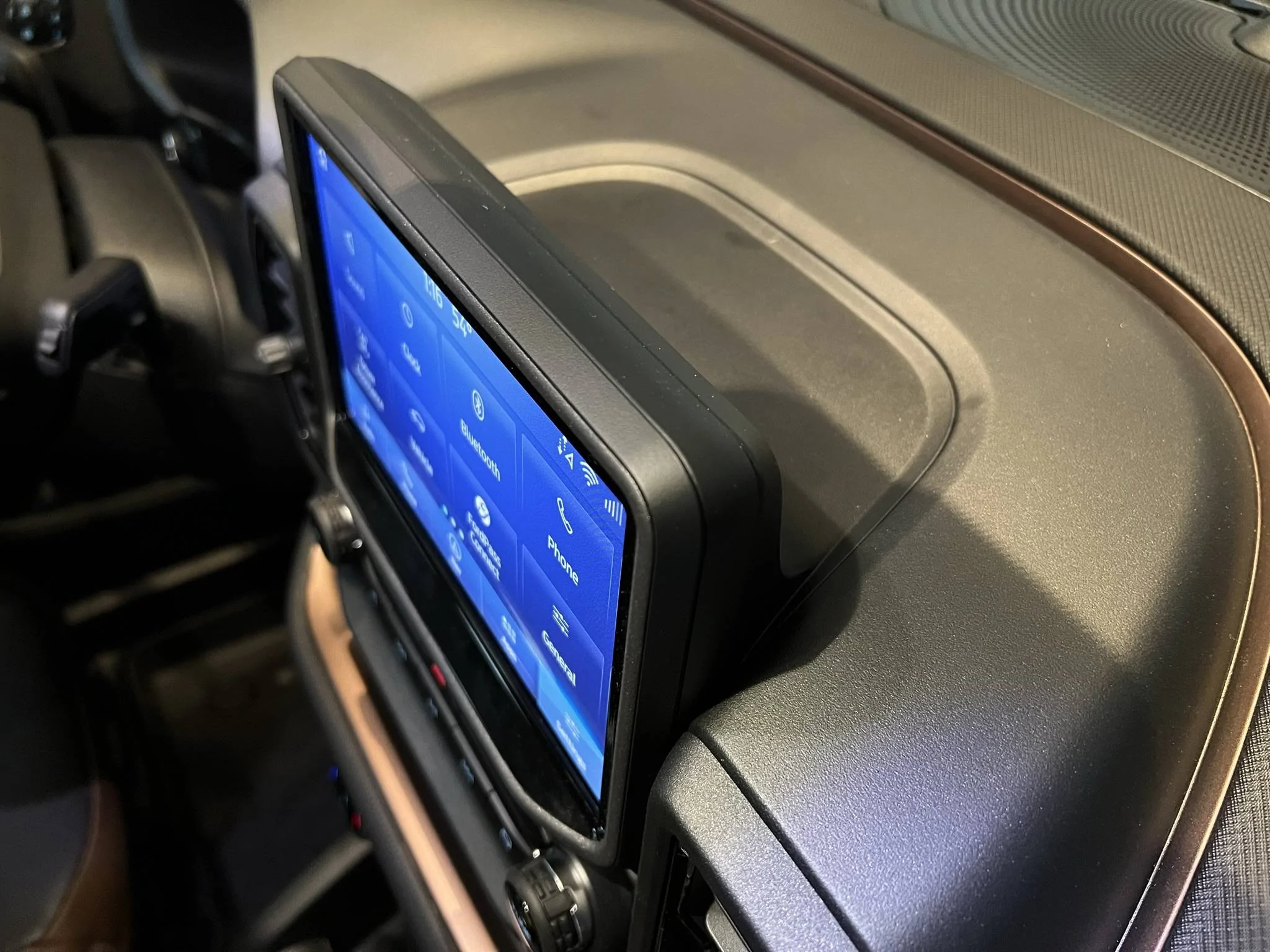

Push and lock it all back in place and install back the three bolts. Re-install the dash plate taking care to insert the two tabs at the back top of the screen and then push down to lock the four clips. If the two plastic tabs don't back into there will be a gap between this plate and the back of the screen. :wink:

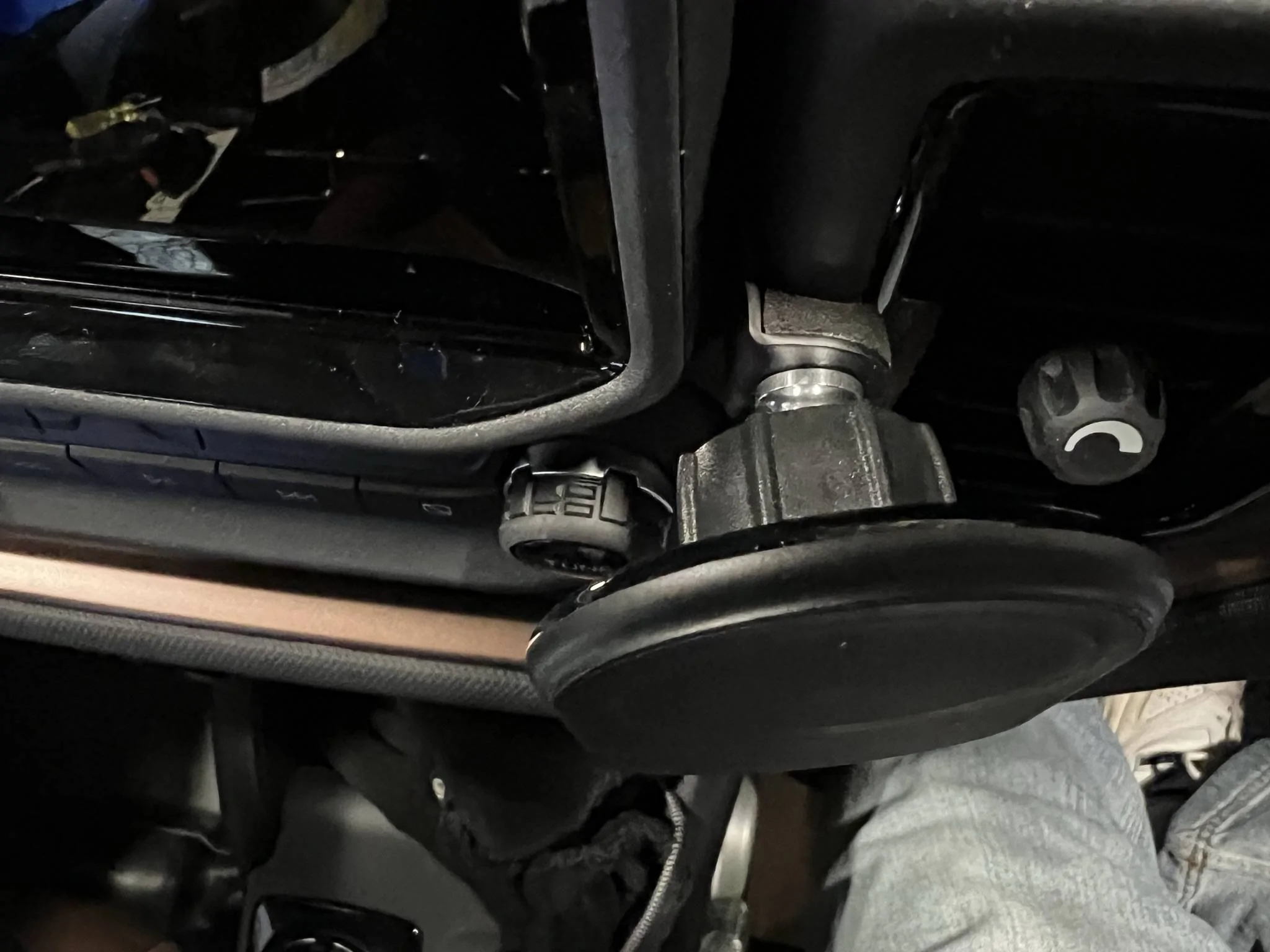

They added a small piece of foam to help stop any vibration.

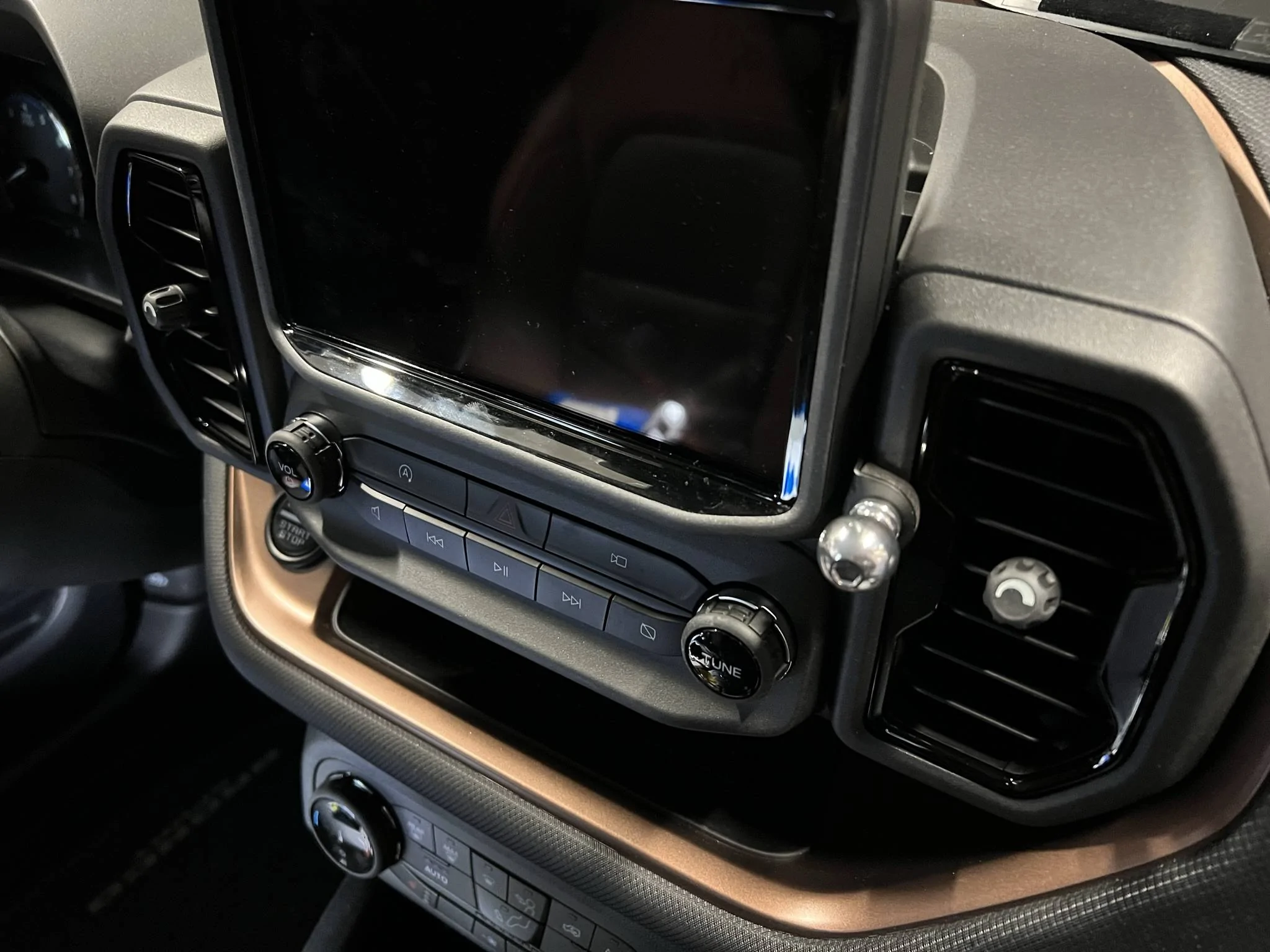

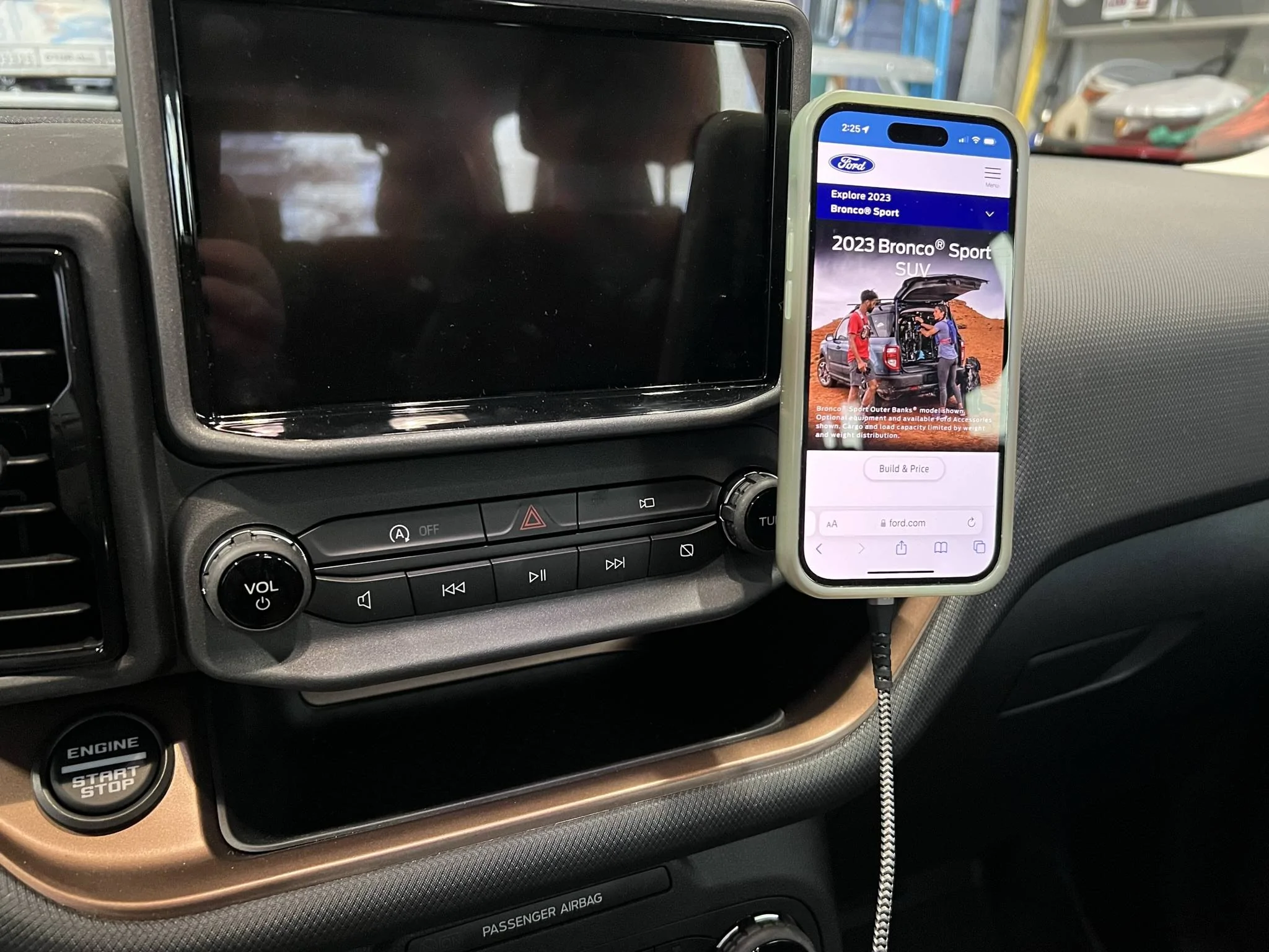

Phone mounted and ready to go. Does not interfere with the screen or controls. Tuner knob is hidden a bit, but I really don't use it.
