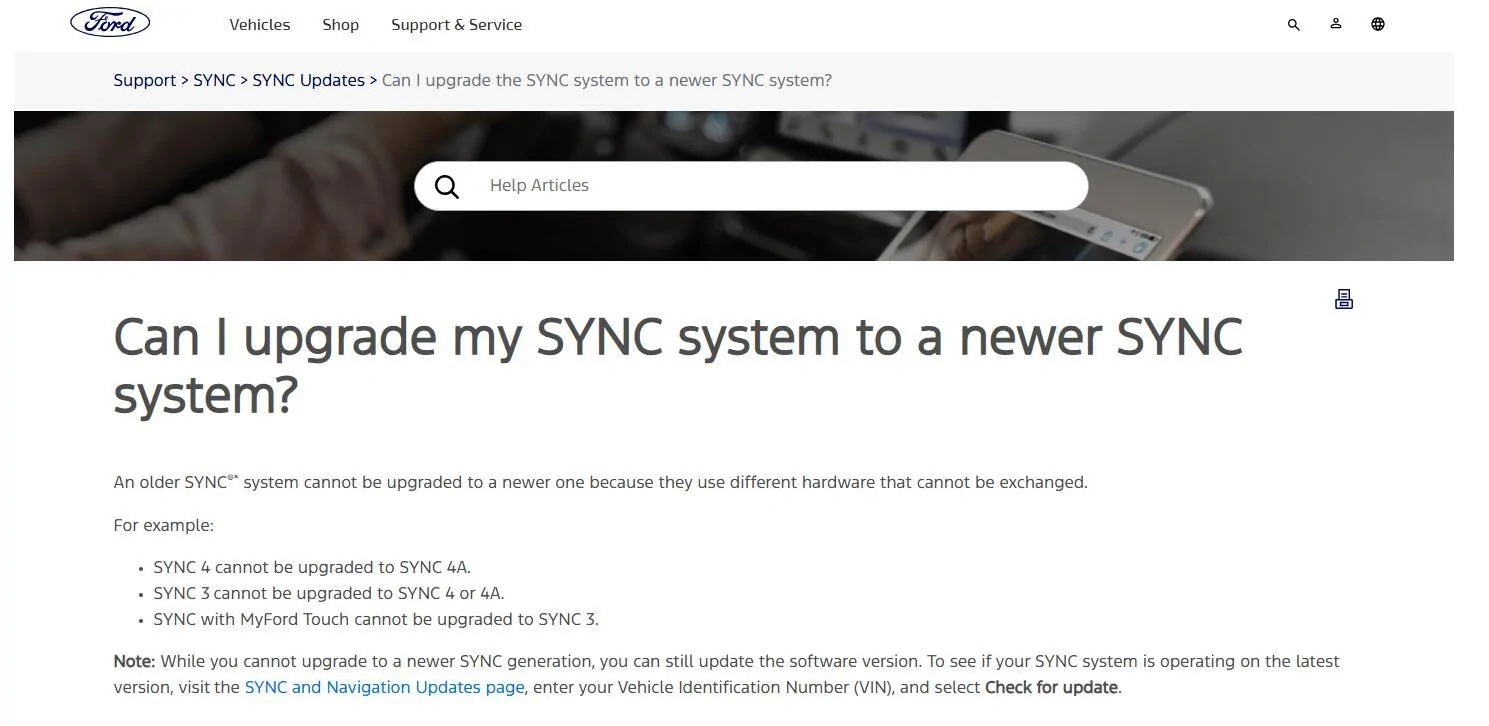

Must be a third-party thing, Ford specifically states SYNC 3 cannot be upgraded to SYNC 4. It's both hardware & software involved.
