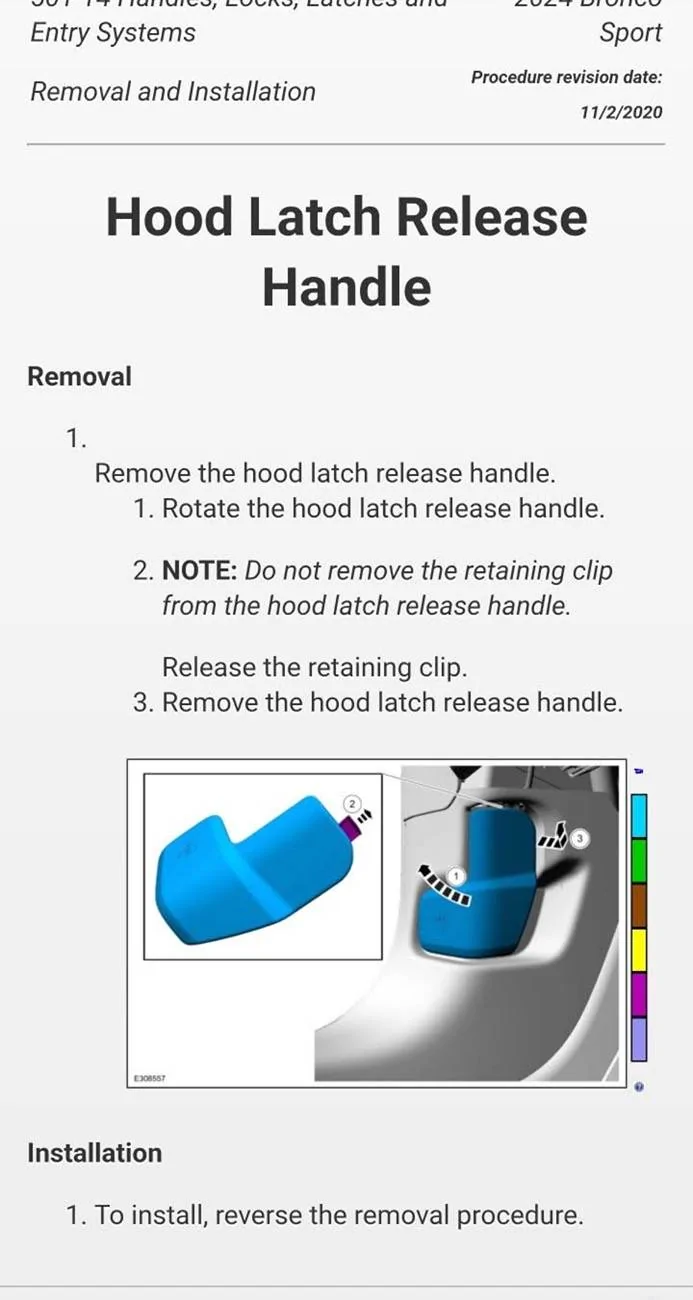

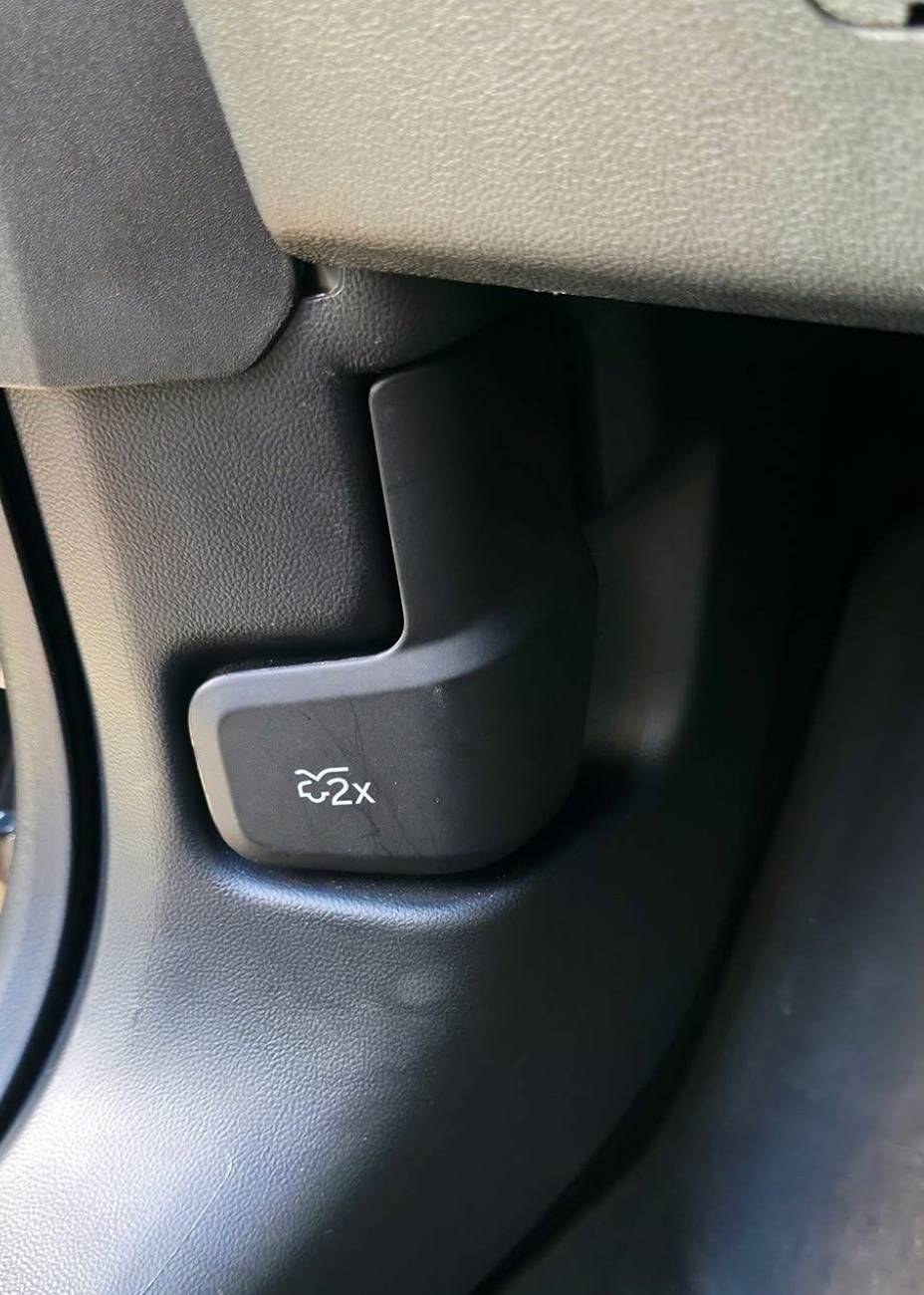

Dude Well-Known Member Joined Sep 20, 2022 Threads 112 Messages 4,486 Reaction score 5,313 Location Arizona Vehicle(s) 2022 Bronco Sport Badlands Jun 19, 2025 Thread starter #1 If you have a need to remove the hood latch release handle, here is the procedure from the workshop manual
