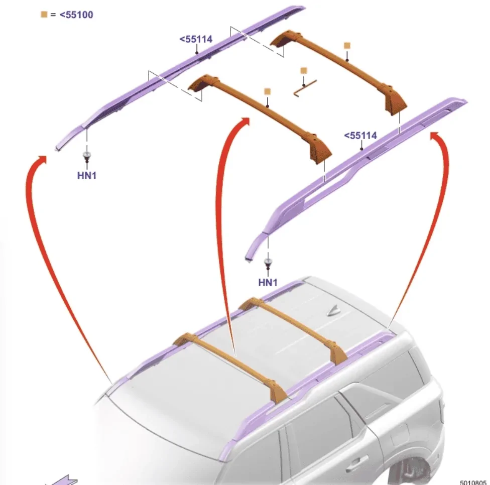

Does anyone have instructions on how to remove the PURPLE left and right rails?
And for extra bonus points the rear antenna too plz.. :)
I am wrapping the roof, and having them slant inward has proven difficult, so easier to remove, then replace.

I'm planning on doing this too. Did you figure it out? Just the two HN1 screws holding it down?

You found exposed screws somewhere?
I didnt really look, as I didnt want to be disappointed by having to drop the headliner. Where are the screws plz?

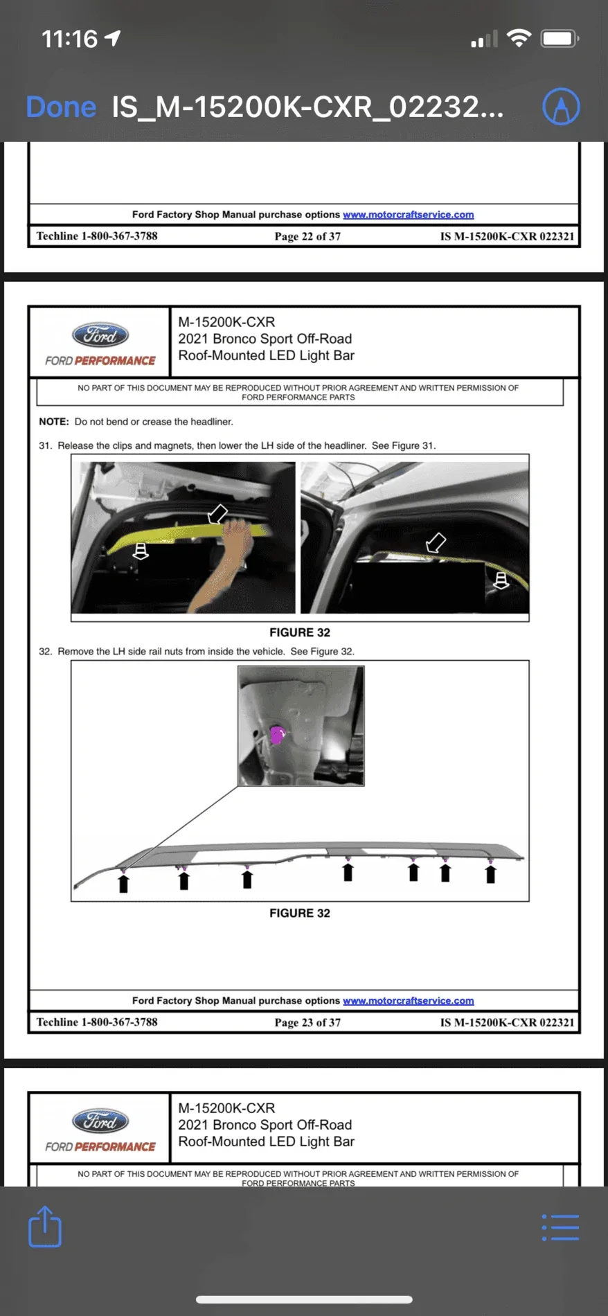

No, was looking at your diagram but now see it highlighted only the front screw on each rail. Based on maxwellion's post (thanks!) looks like have to undo rails from inside. Bummer, not brave enough to ruin something yet. Get my BB this Tues.

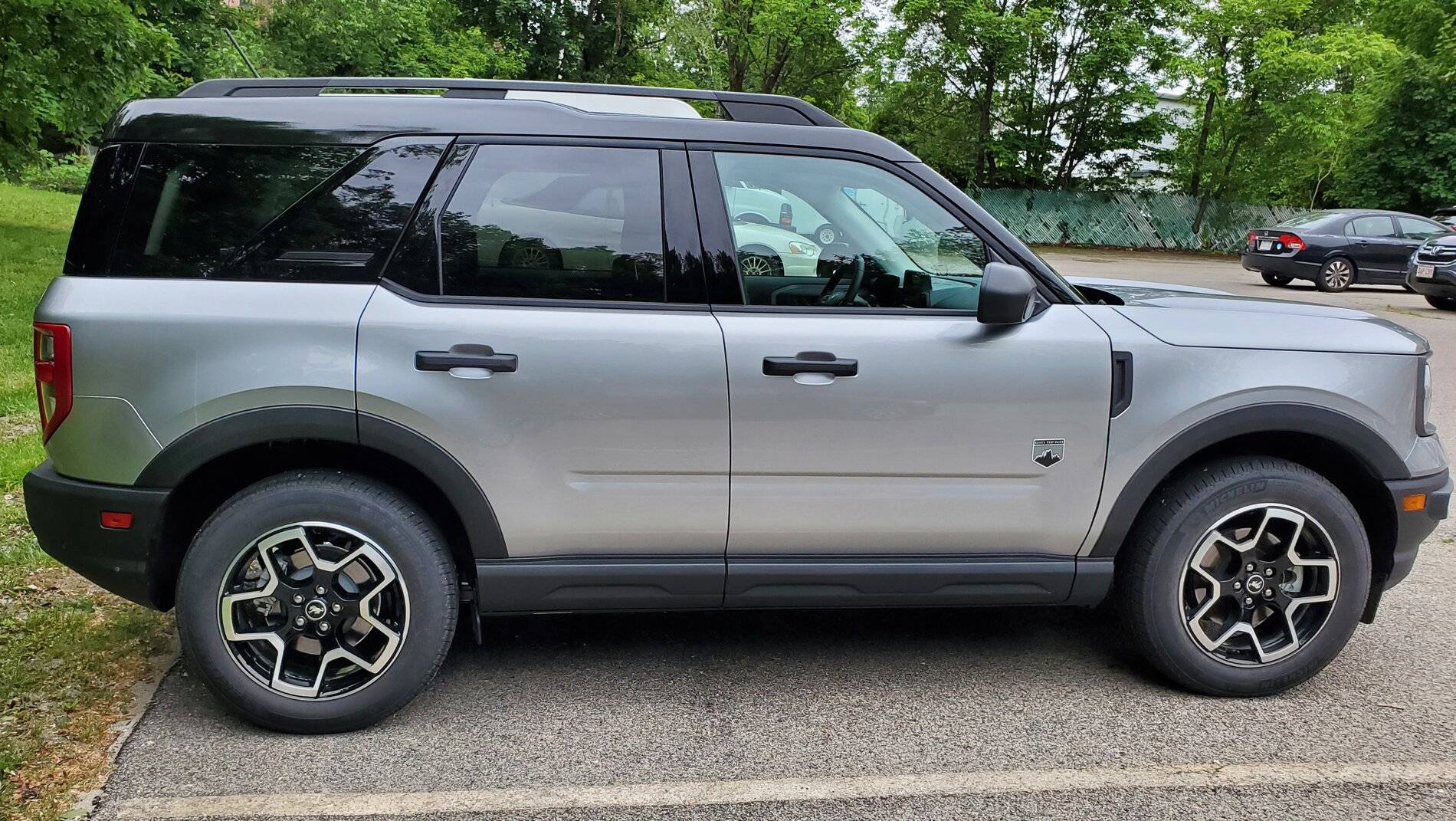

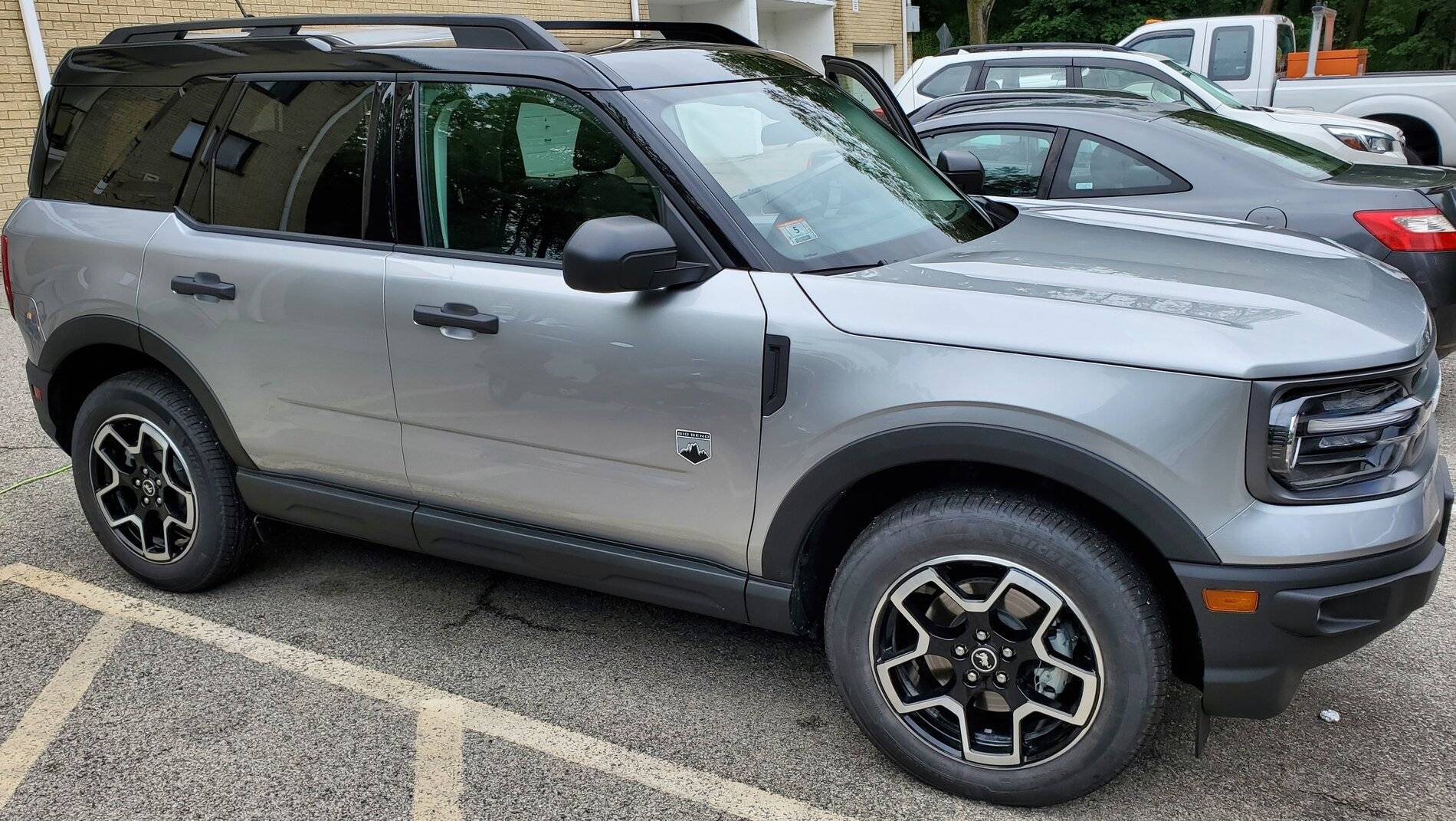

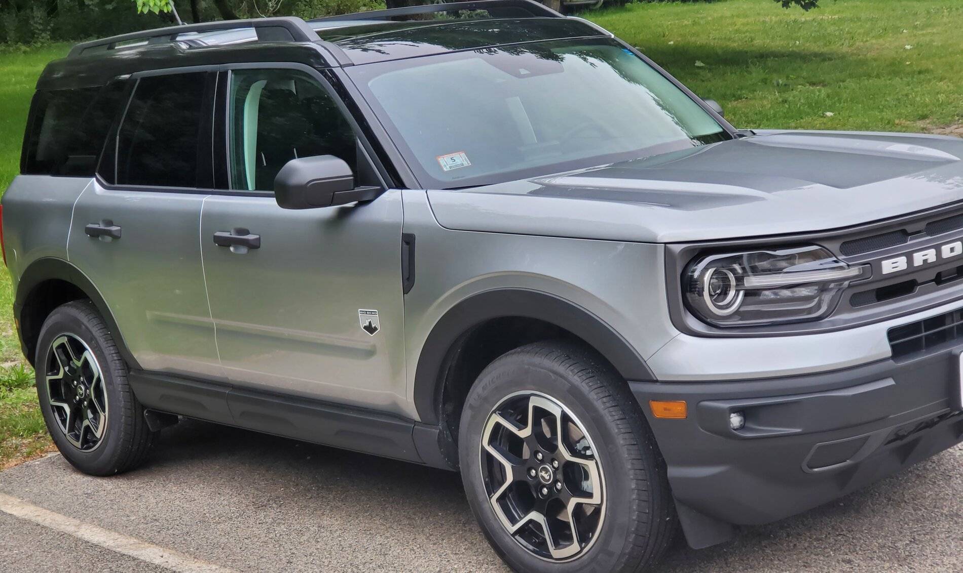

Got passenger side top roof section self vinyl wrapped today.
Definitely don't need to remove racks for those. 12" x 8' piece of 3m 2080 black gloss was perfect. Tucked top under roof rack rubber seal.
