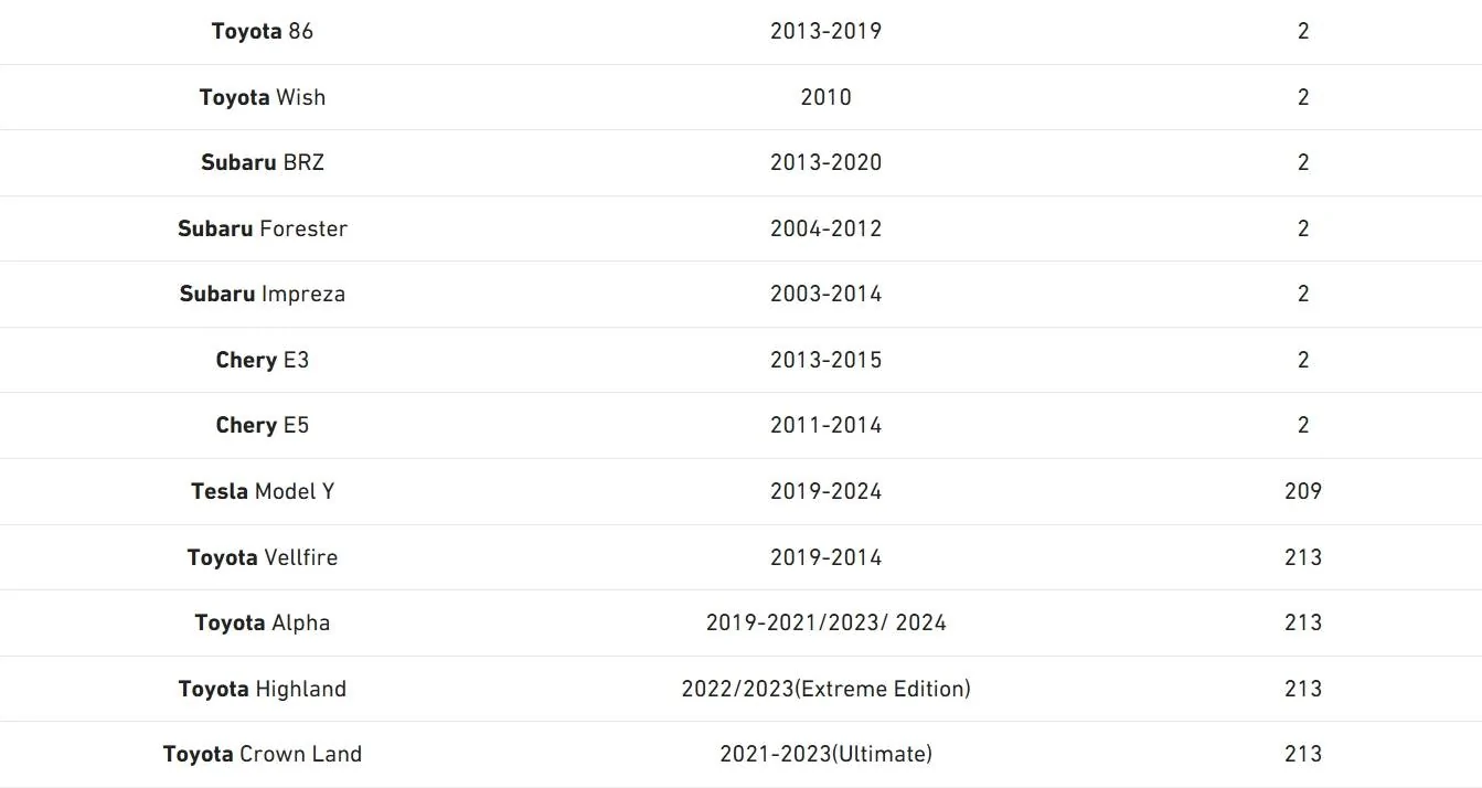

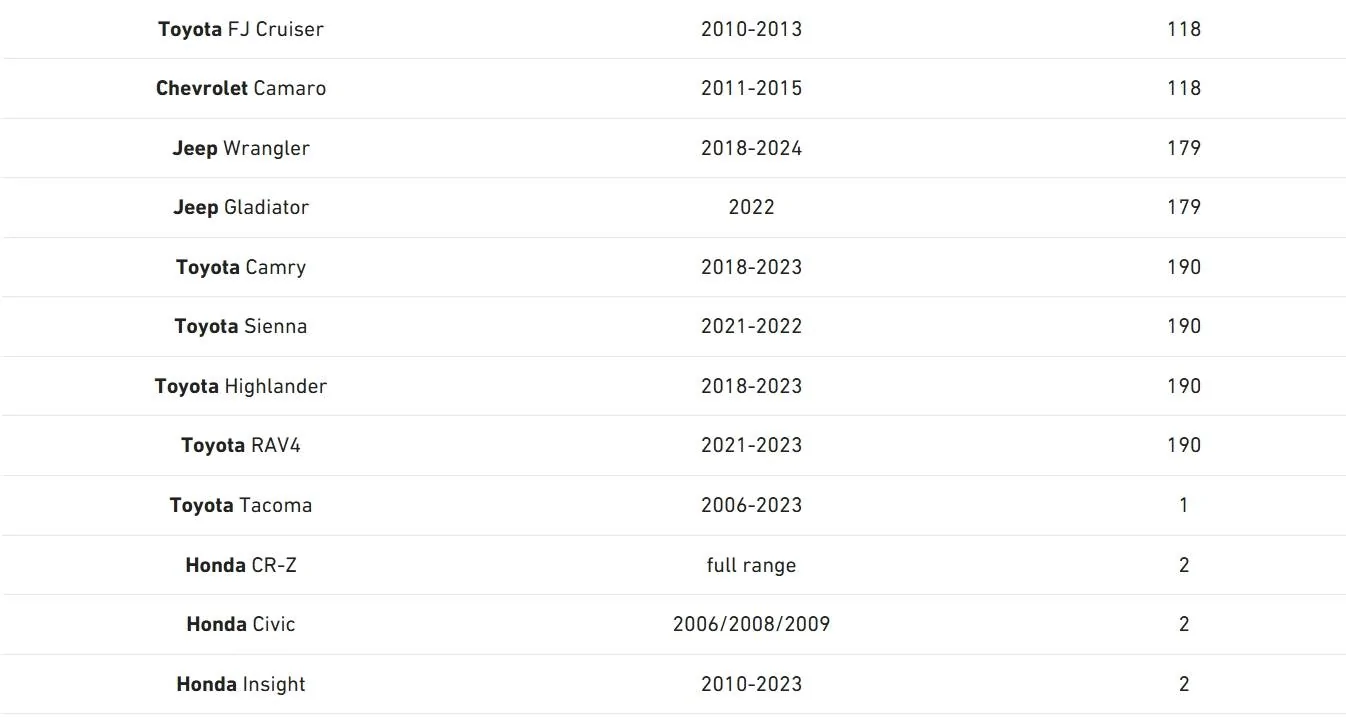

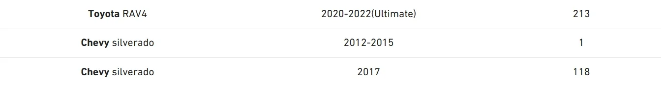

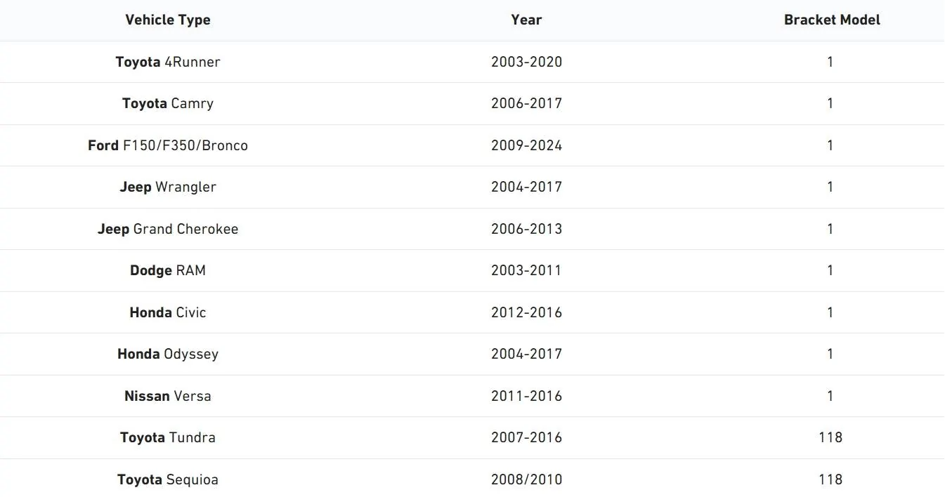

My dear friends, I know some of you have trouble in choosing our OEM bracket for your vehicle. This post is to inform you a little of it.
On Wolfbox website, the OEM bracket is listed in Dash Cam -->Dash Cam Accessories -->choose your model -->find OEM bracket. There you can see a compatibility table which helps you choose the right bracket model. The table is also listed below:

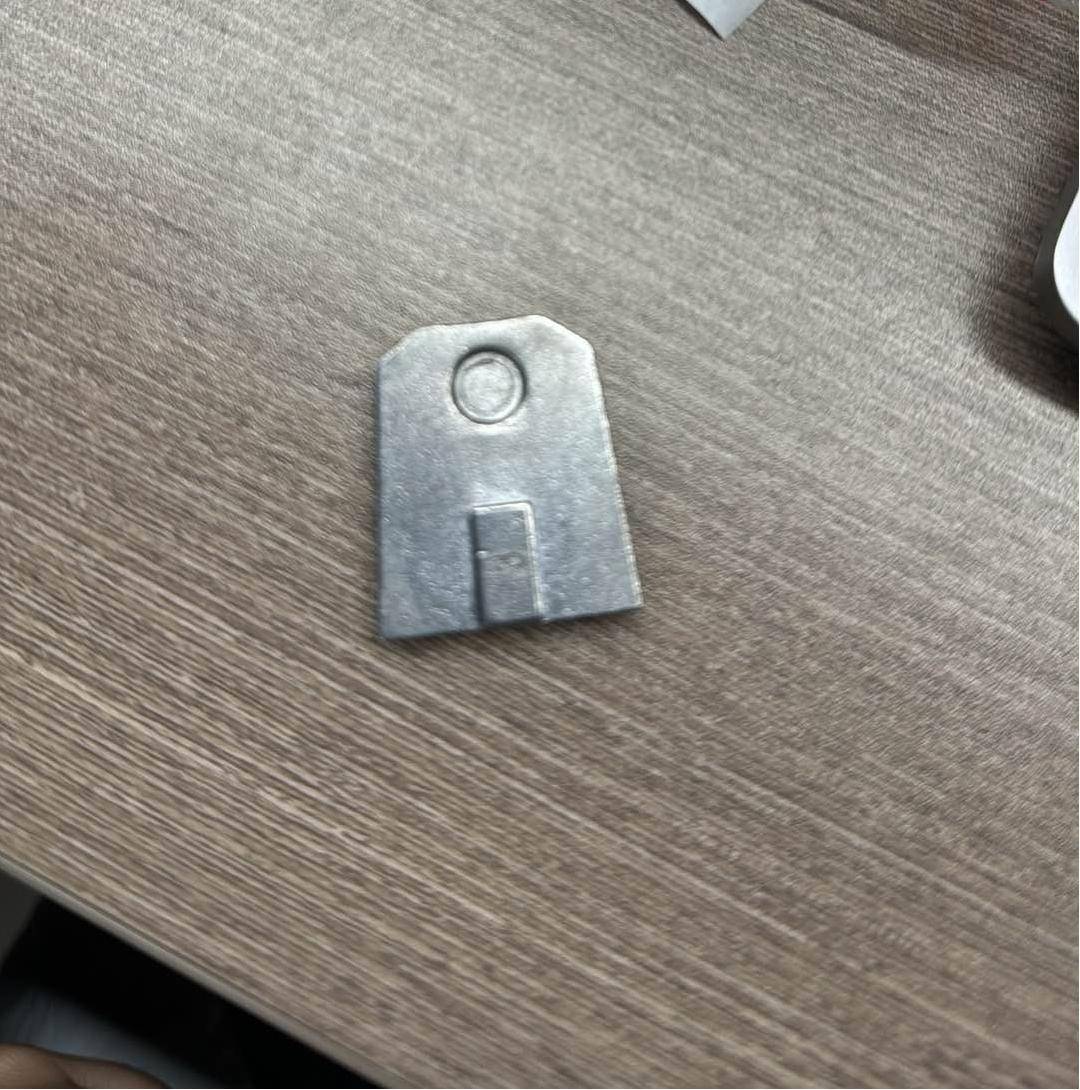

Universal Solution
If you want to install our OEM bracket but worry about the compatibility, or you fail to find your vehicle model above, we offer a universal solution.
  1. Choose #1 bracket, and leave a note "need a metal piece" when check out.
  2. Remove the original bracket, including the plastic part and the metal part on the windshield.
  3. Use strong glue and paste the metal piece (flat side) to the windshield.
  4. Slide in the OEM bracket and drive the screw tightly.
