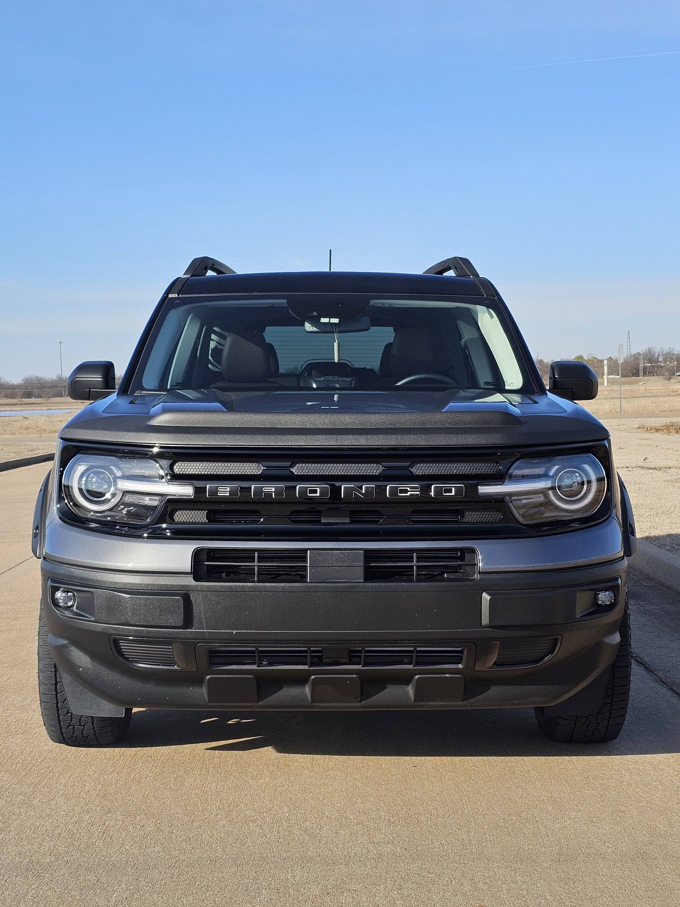

Curious if you have a link to your “raptor” grill lights? Looks great! This is the first sport I’ve seen with that grill with them and it’s made me nervous to buy some cause all the examples I’ve seen are on the other grills!
I apologize for the delay, since I no longer have my BS/OBX (got another Mustang :cool: ) I didn't see your post.
I got them from Amazon.
Partsam 5x 3/4" Mini Smoke Lens Amber LED Clearance Side Marker Light Trun Signal Truck Trailer RV Camper Pickup Car Grille Lights Flush Mount Waterproof 12V
Visit the Partsam Store
They were $12.99 for 5 when I got them in 2022. Looks like they are still on Amazon. If you get the smoked version they are hardly visable when off.
Measure carefully, Take the panel above radiator off, I used a "step" drill bit to make a 3/4" hole in the plastic (goes very easily). Simply take the light out if the grommet, insert the grommet in hole, re-insert the light - done. I wired mine to the pax side front clearance light so they are on anytime the lights are on. There are several "bolts" on the pax side front you can remove the nut from and connect the ground to.

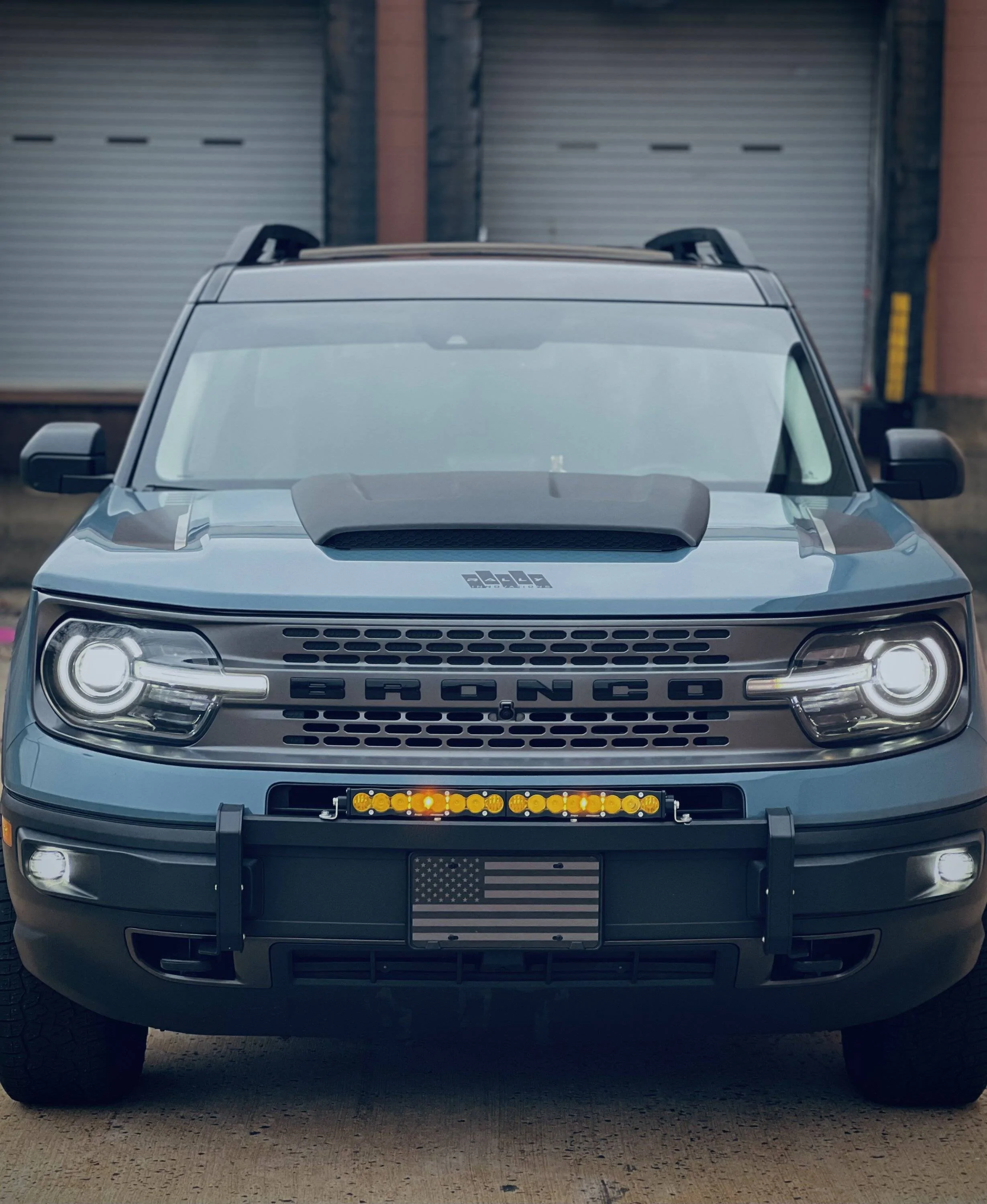

What make and model of roof rack do you have installed on your Badlands? Mine is OEM bars and Hyper roof rack which are too high and bulky for my liking. Your looks low and fits the roof line well.

It is a Yakima platform 60' long I believe. I can get more info tbis evening if you need.
