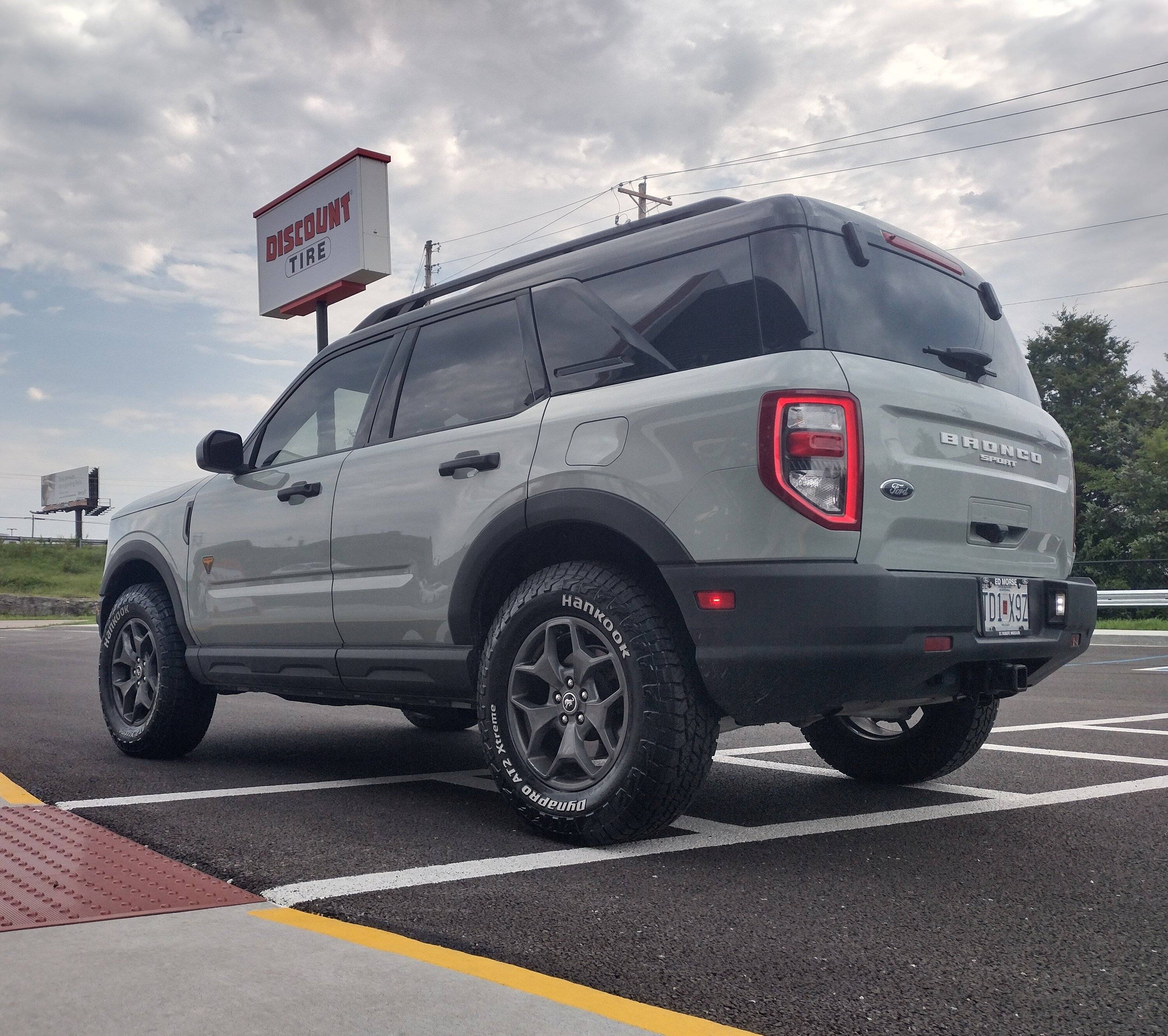

We agree, the white letters look great!

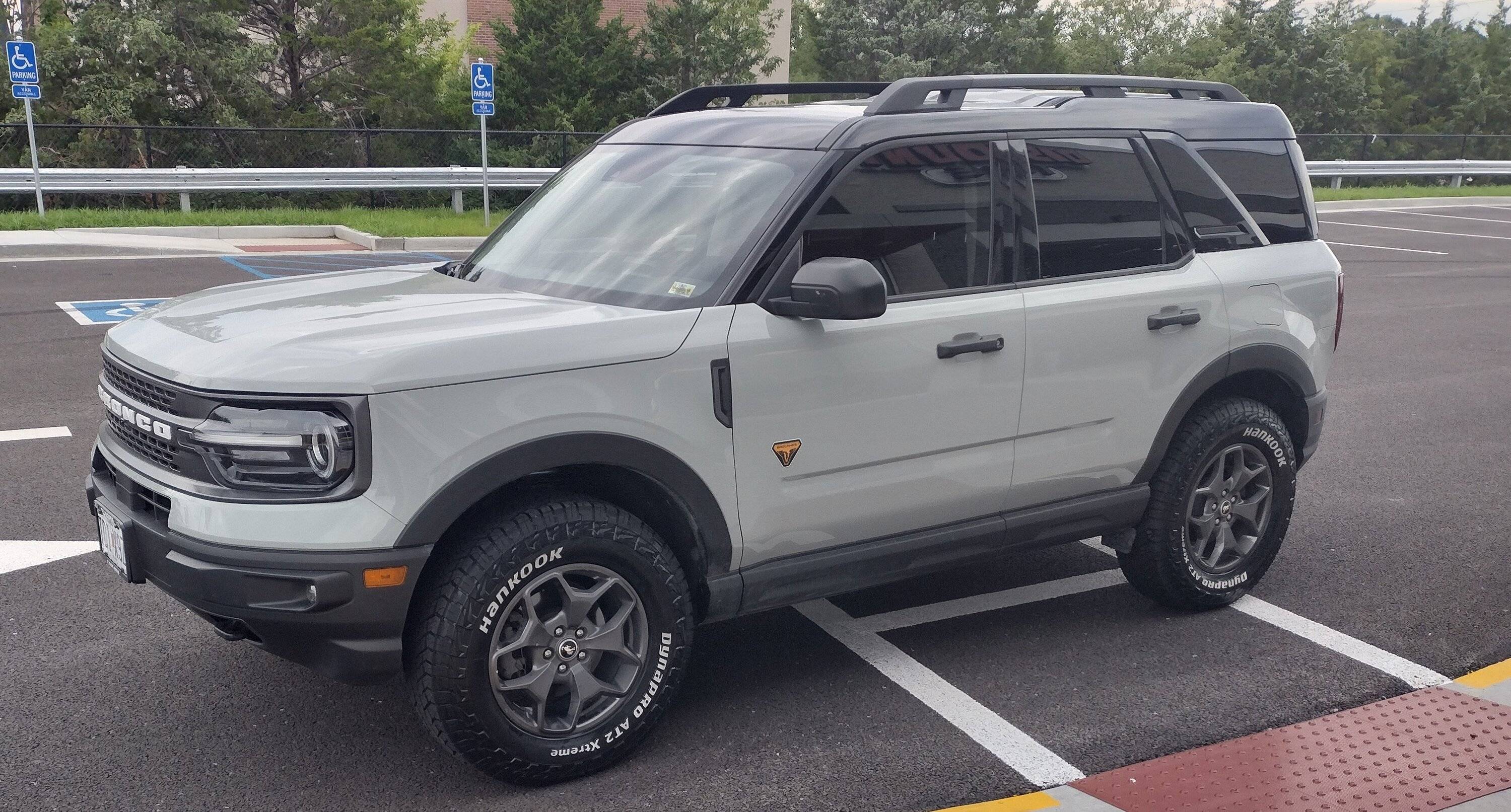

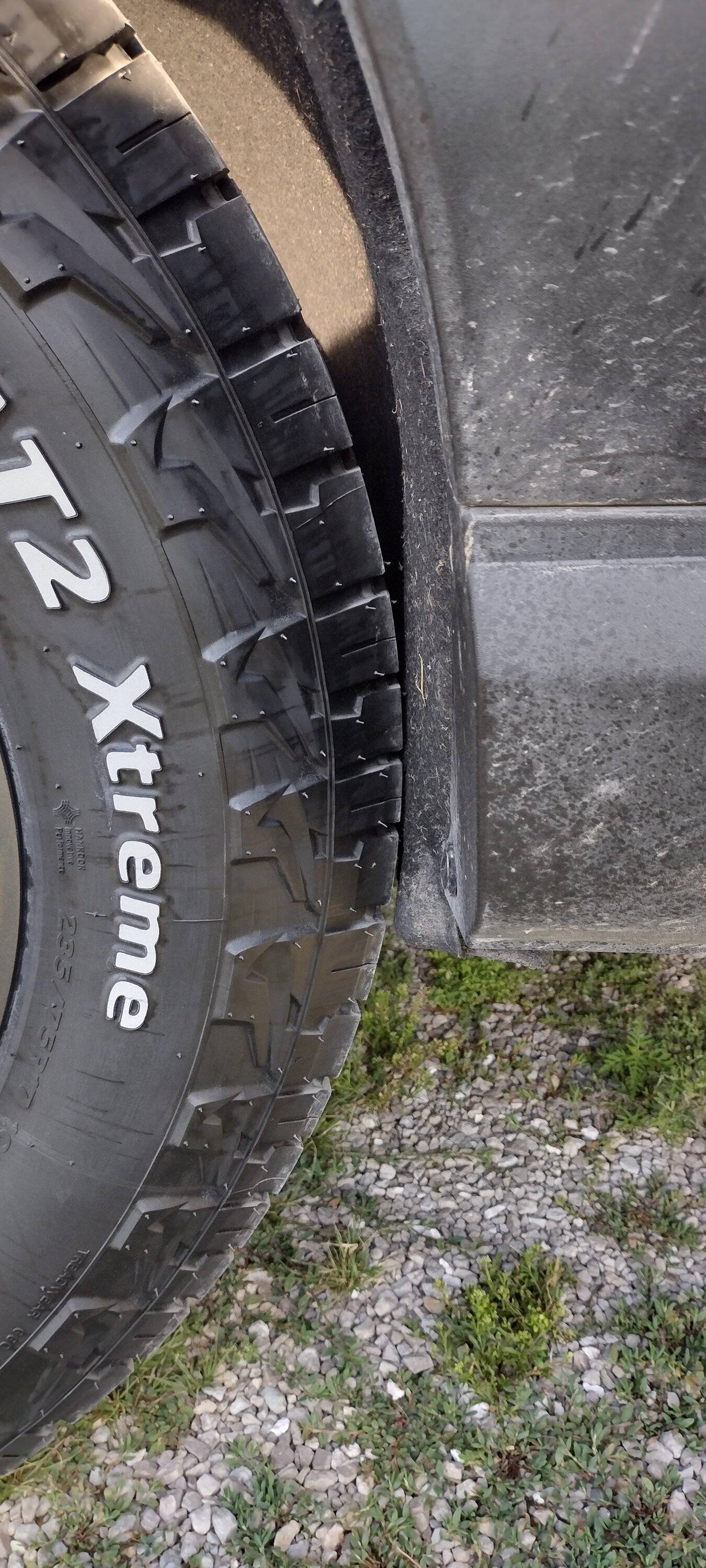

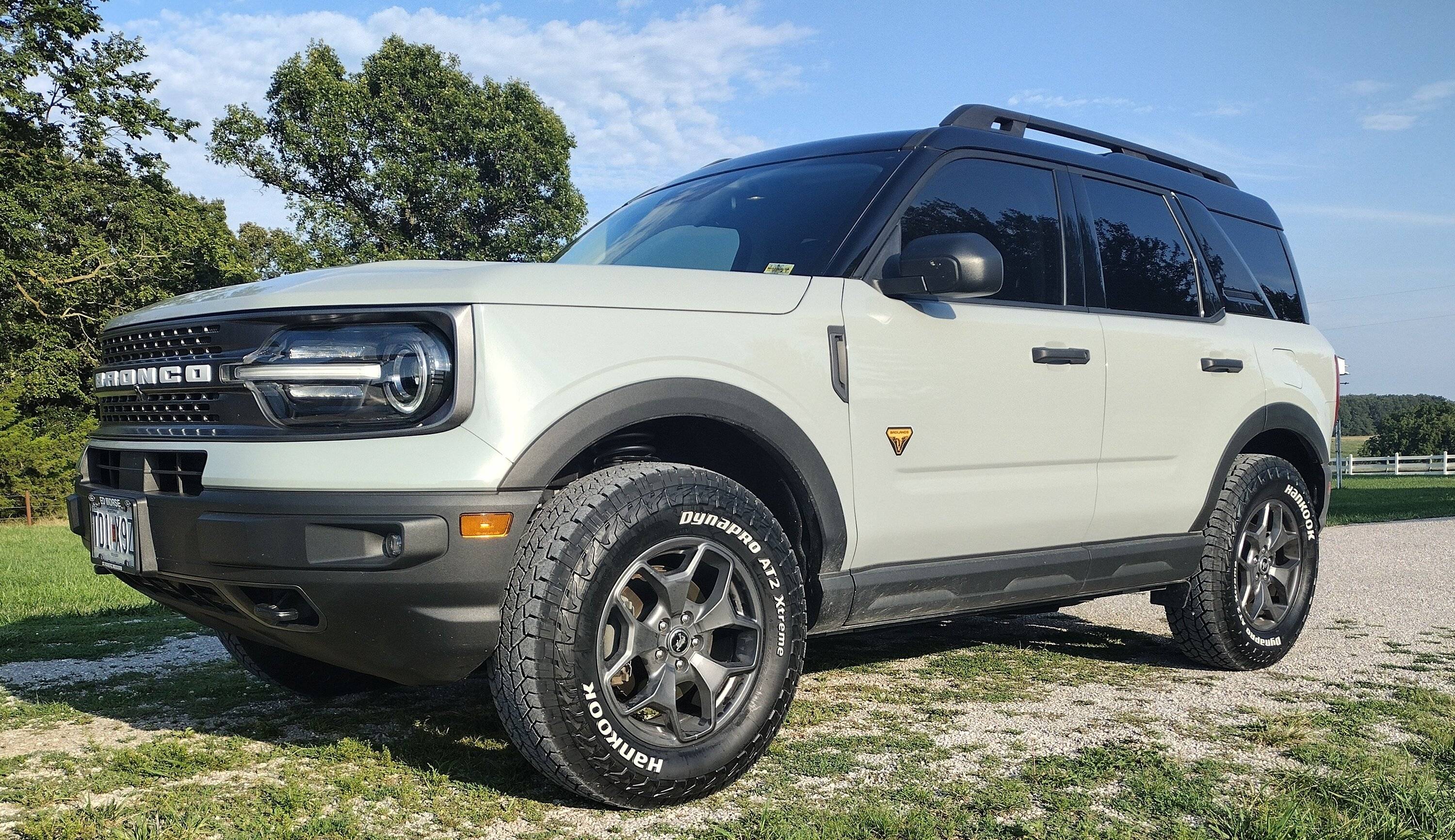

Hankook Dynapro AT2 Xtreme 235/75r17 (OD. 30.8 in.)
1 in. Level front only eibach springs.
eibach.com/product/E30-35-053-03-22?epsid=2912
They fit but it is super close. Definitely louder then the pirelli but the pirelli where more all season the all terrain.

Snug fit for sure @Vairrex! Thank you for giving us the opportunity to help with the new tires.
Did you test fit any other sizes?
I did test fit the 235/75r17 and they seem to be just ever so slightly kissing a liner at certain angles. But after a few thousand miles I don't think they'll even be doing that. Do you know a good way to fix the speedometer. Going from 28.5 to 30.8 on the diameter has really thrown the speed off.

Appreciate the additional insight.
As for the speedo, you may want to give this thread a read through. There may be aftermarket tuners that now have the capability to adjust the tire size.
https://www.broncosportforum.com/forum/threads/speedometer-calibration-with-larger-bigger-tires.1992/
