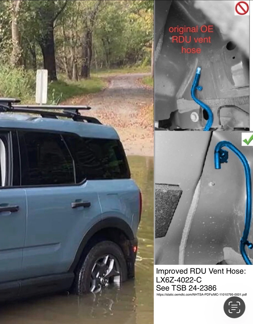

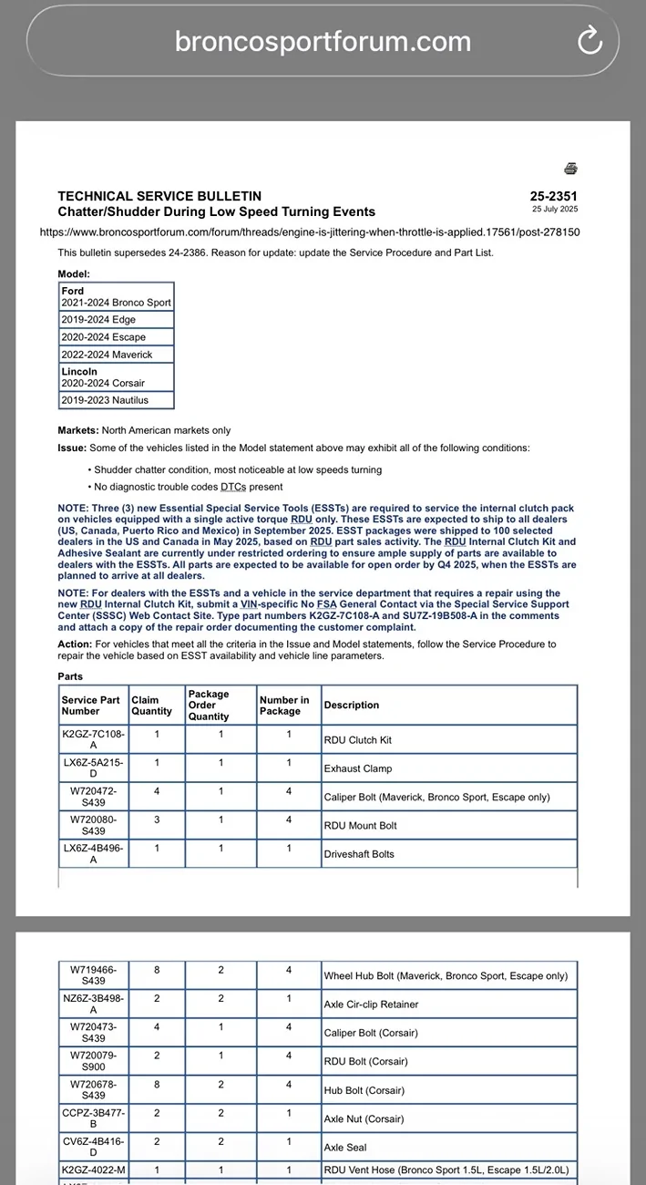

The most likely cause is the RDU. There are quite a few threads about this on the forum describing similar if not identical symptoms. Some say a fluid change resolves the problem, while others required an RDU replacement. If you haven't seen a trusted shop or the dealer about it, I'd do so at your first opportunity.
If you have the Ford App it'll show active recalls for your VIN. Also, you can go to https://www.nhtsa.gov/ to search for recalls.
